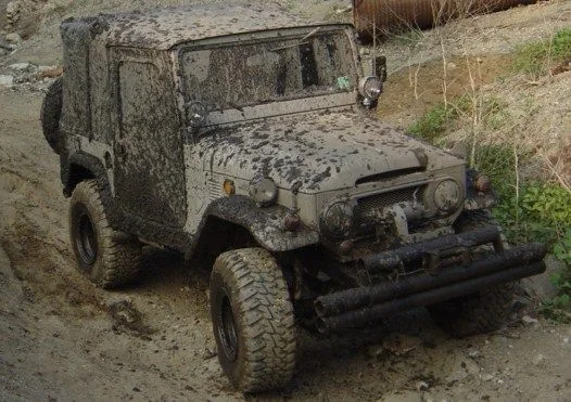

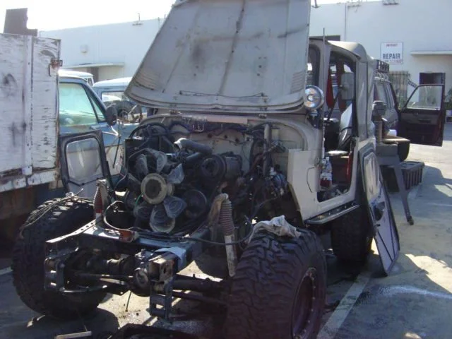

Started a fj4o project awhile ago after catistrophic trail failure. Ultimate objective to make a truck that can handle the rocks and can handle the road. I will try to keep the build in proper sequence but I did a horrible job of documenting the build. Repair and despair. Pictured is the truck prior to build and is a 1969 FJ40 nothing special to mention.
Pre build pic

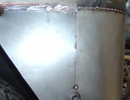

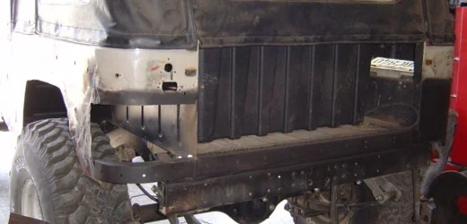

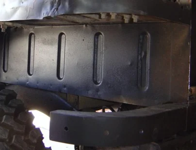

welded new quarters very rough. hammered out wrinkles and grinded down welds. I unfortuntly did not take pictures of the finsihed product but they did come out very well

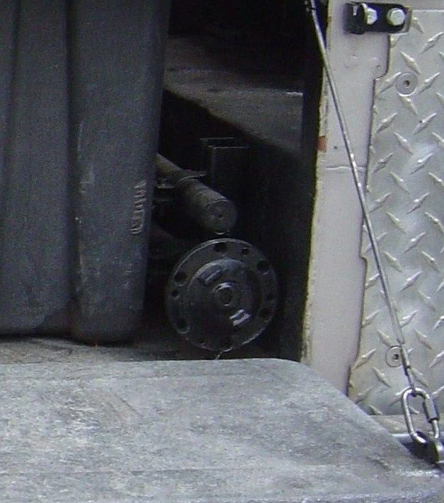

fabricated some removable 3/8 plate hangers on sides of tailgate and made cable limiters. Pictured on sides are spare full floater axles for the rear and spares for the front. Will discuss later in the build

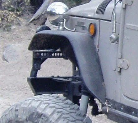

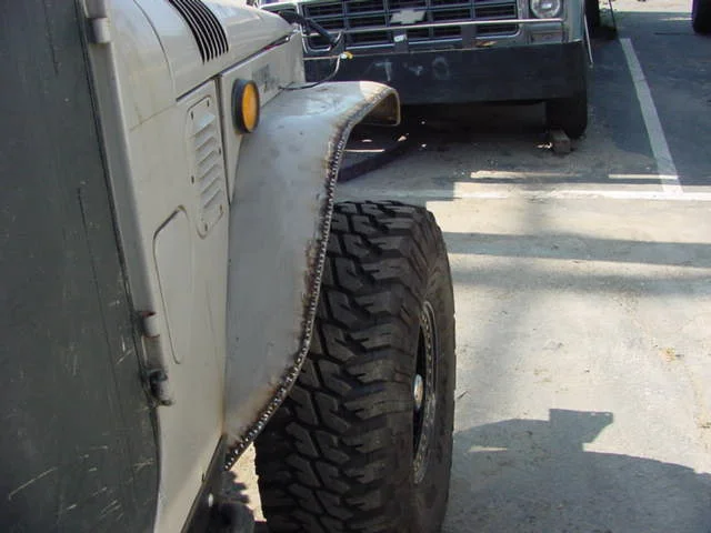

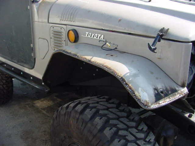

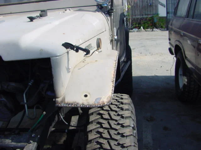

I was originally going to fabricate flat fenders but then decided to cut 3 inches off the fenders and weld a small piece of pipe to the lip. Let me know what you guys think

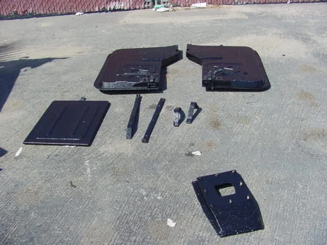

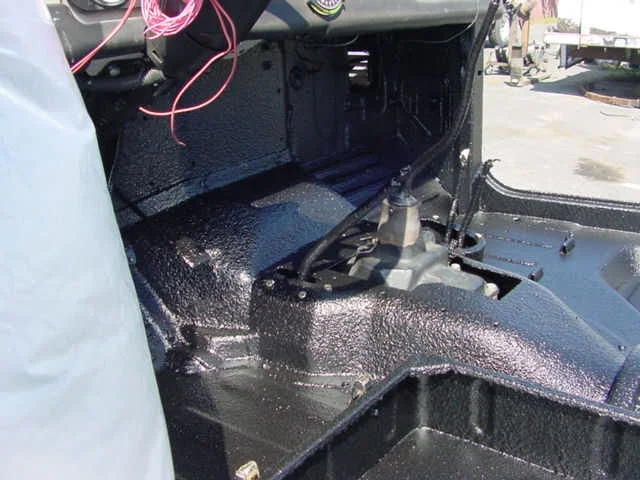

Cut the transmission hump so the drive train could be removed without removing the transmission hump which as you all know sometimes requires gas tank removal and or seat removal.
Fabricated a removeable section that attaches to the hump with several quarter twenty bolts with nuts welded on the transmission hump for quick removal. I found out the hard way that I had to remove the drive train several times. I then had the hump sprayed with polyurethane linings.

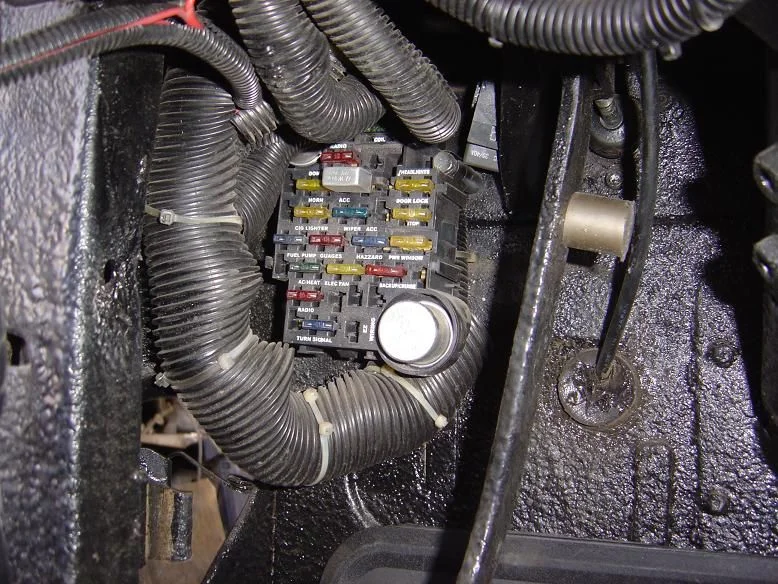

I then gutted the 40's wiring harness and installed a 12 circuit wiring harness I picked up at the swap meet for half the price of painless harness. Installed the fuse panel on the firewall completely out of the way and accessable. So much better then the OEM buzz fuse box. The installation of the wiring harness was time consuming. Lots of solder and shrink tube.

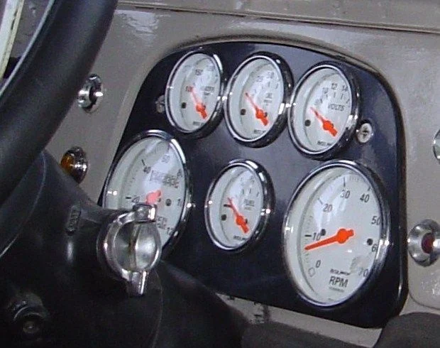

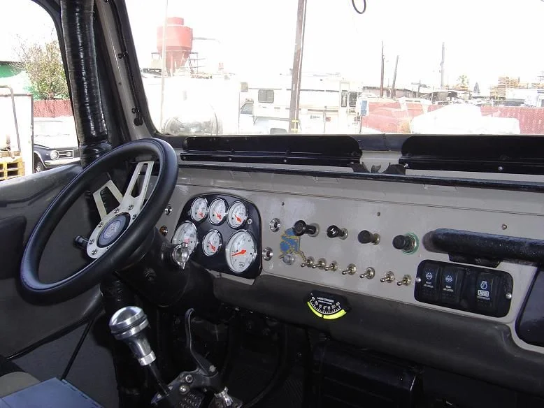

I fabricated a panel for the gauges then installed autometers gauges. Fuel, temp, oil press, tach, speedo.
A series of toggle switches.
* KC lights
* reverse light
* under carage lights
* compressor (york) w/ storage tank (quick disconnect at the front bib)
* aux fuel tank transfer pump
* fuel tank sending unit (1 toggle operates both sending units)
ARB swtiches mounted in the ashtray
Chevy tilt steering
