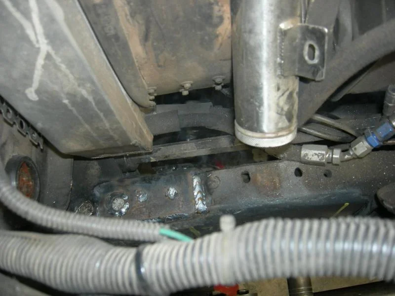

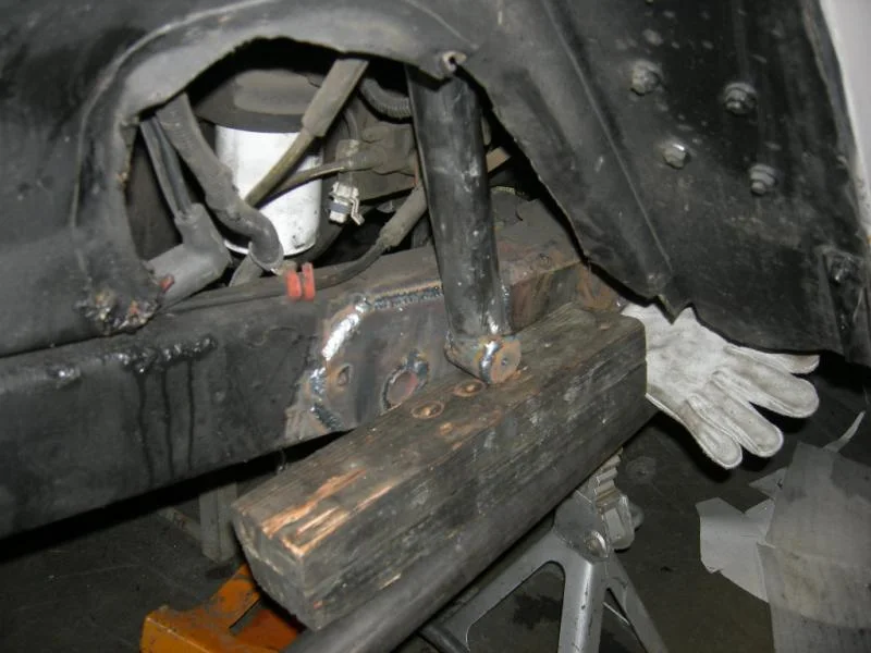

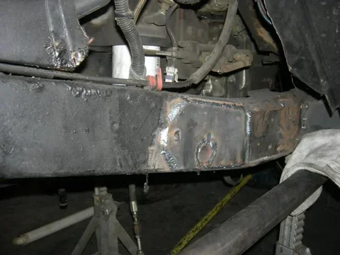

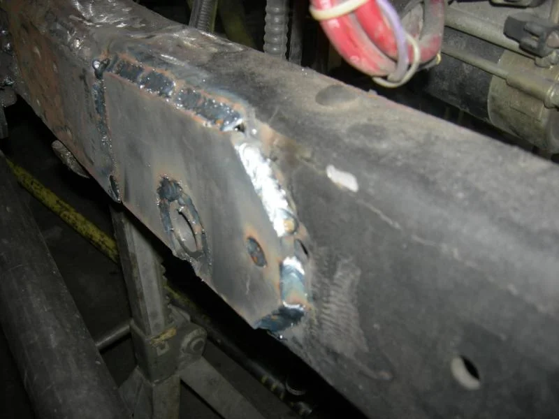

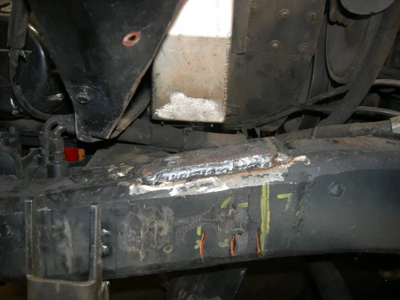

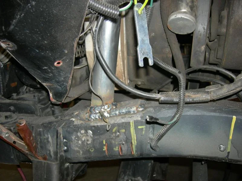

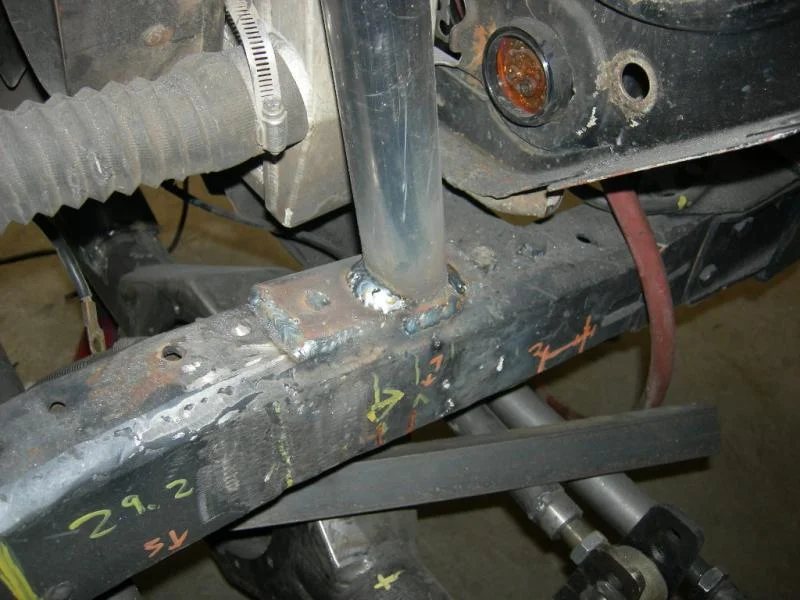

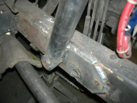

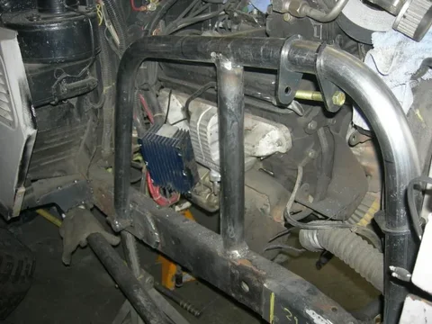

passenger side scab plate for hoop

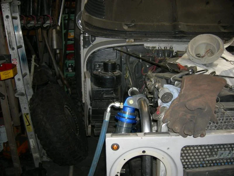

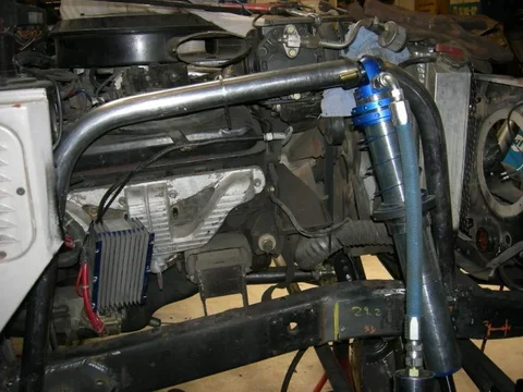

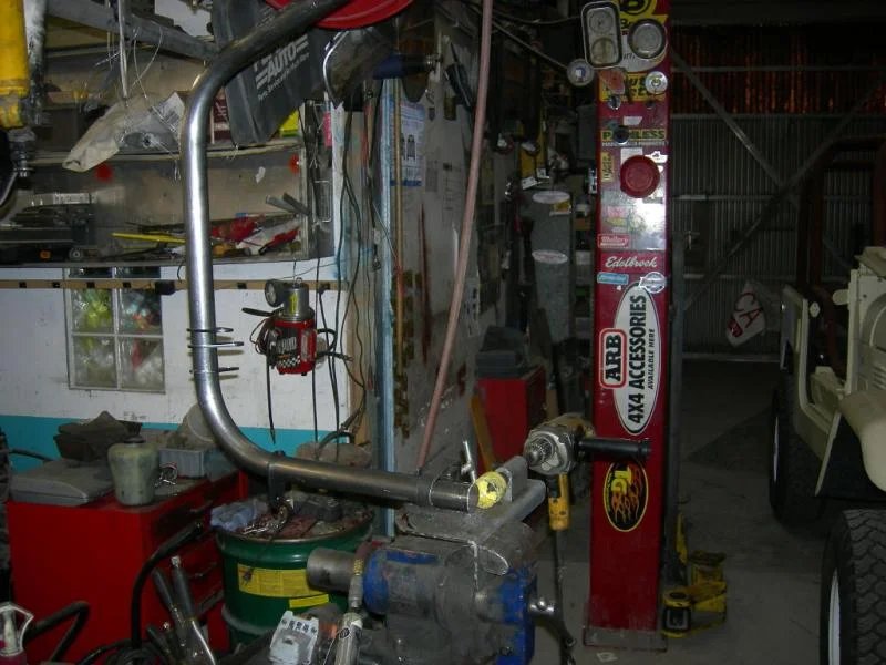

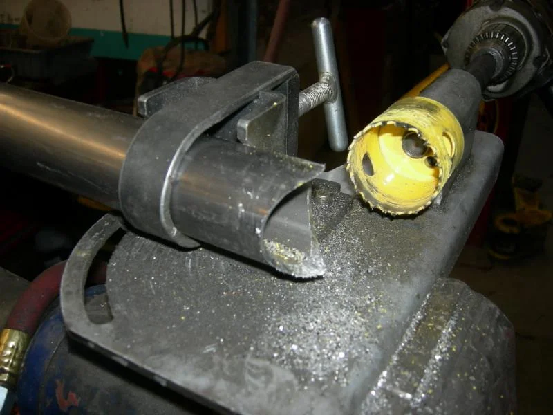

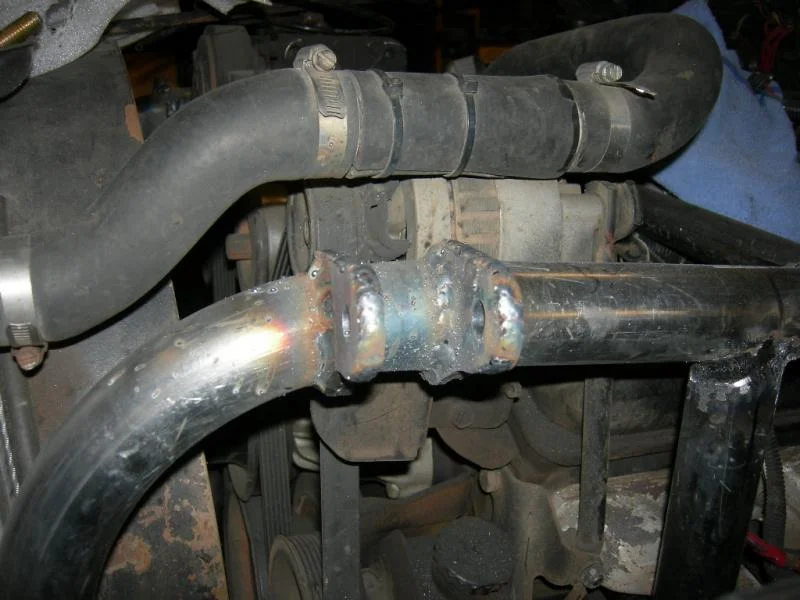

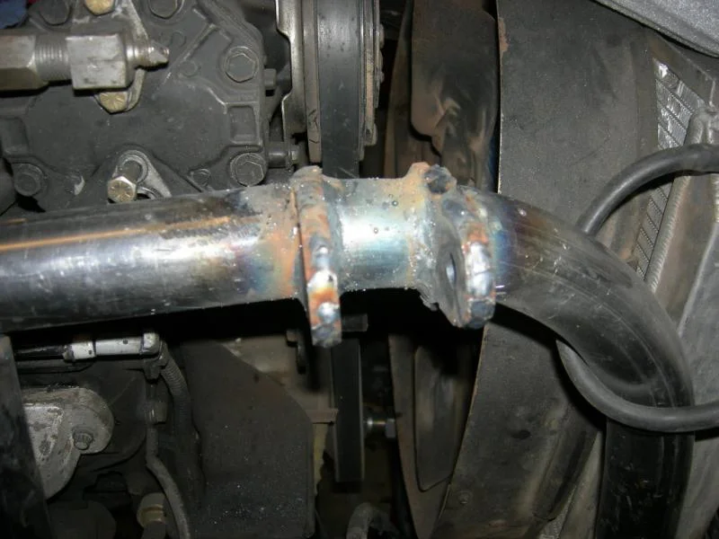

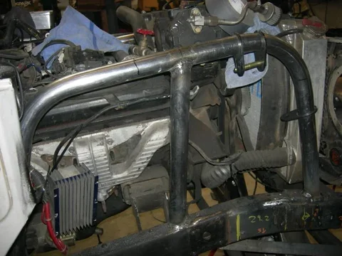

made a cross brace for the hoops with some flanges I had laying around. I welded everyhing on a wood bench lots of smoke.
used 1.25 120 wall. used the smaller OD tube becasue of clearance issues. I couldnt figure out anywhere else to put the cross brace

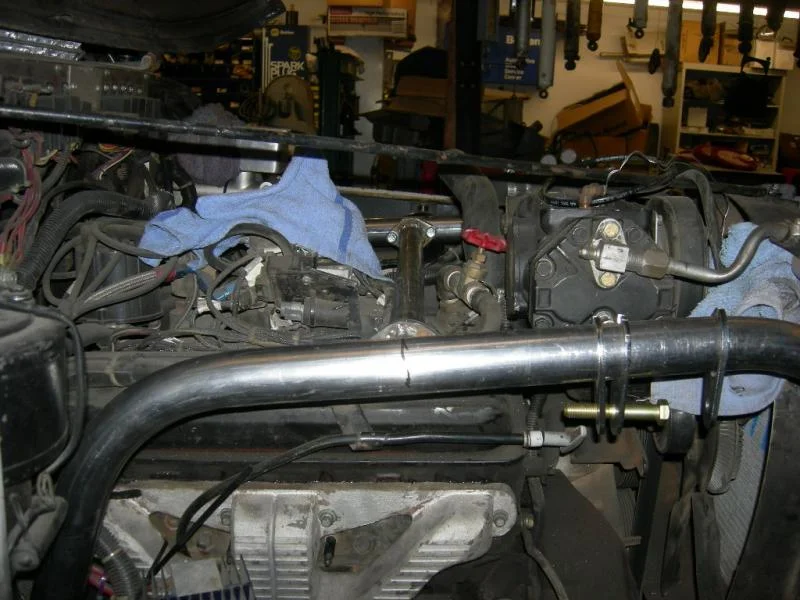

Get the garden hose bib off the waterneck. The extra weight will crack it.
Thanks Danno
I have had that shut of valve on there for a couple of years. I thought it was a good idea to have a valve on the supply side of the heater but I have never had any issues so I havent ever used it.
I bought an inline cable operated valve from Rock Auto and a choke cable from Napa to open and close the valve with. I put the shutoff valve above the rocker cover and mounted the cable in the dash. The valve works great! I can adjust the temp with it or completely shut it off.
Steve
Thanks Danno
Coolio, I would to see that set up. Any pics
Steve

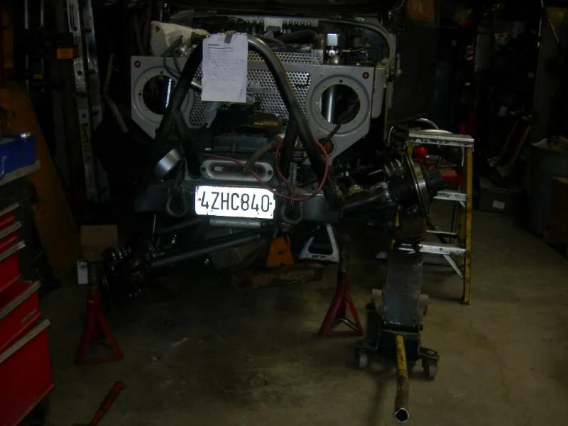

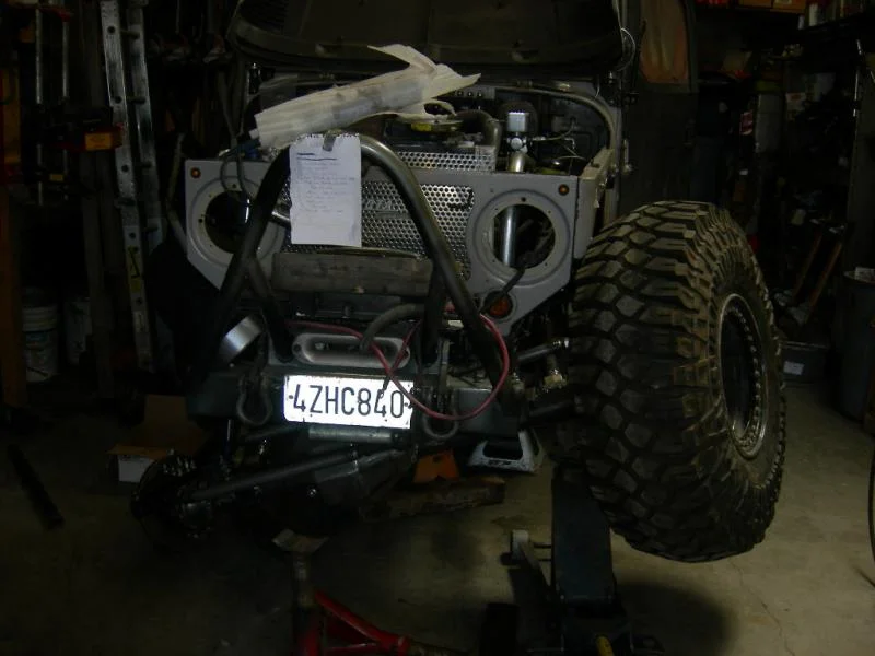

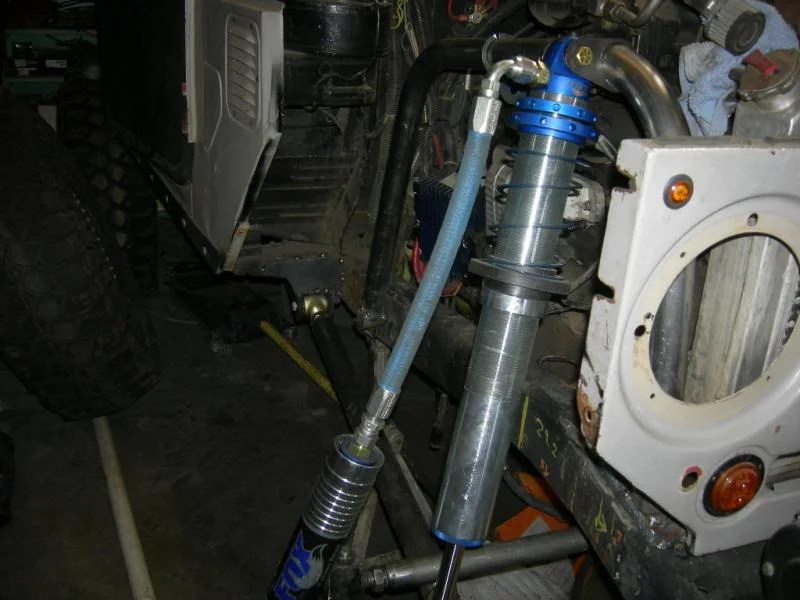

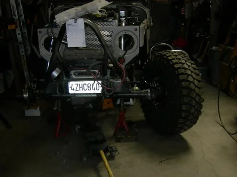

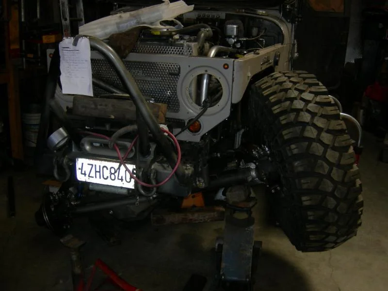

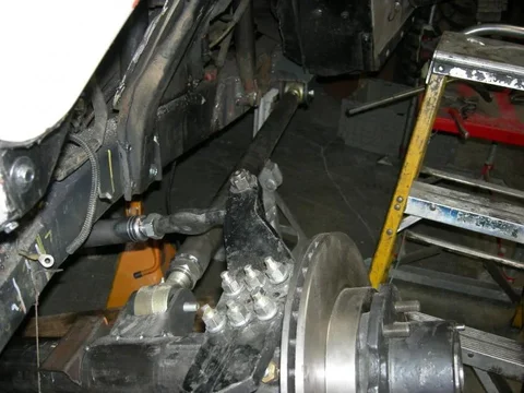

full stuff right turn gets into the body a bit. Might get into the body a bit more with lower tire pressure
mabe a small wheel spacer
maybe body shaving
maybe bump stop it
left turn looks pretty good
ride height turn

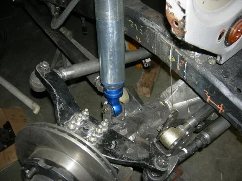

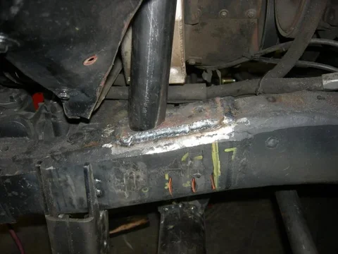

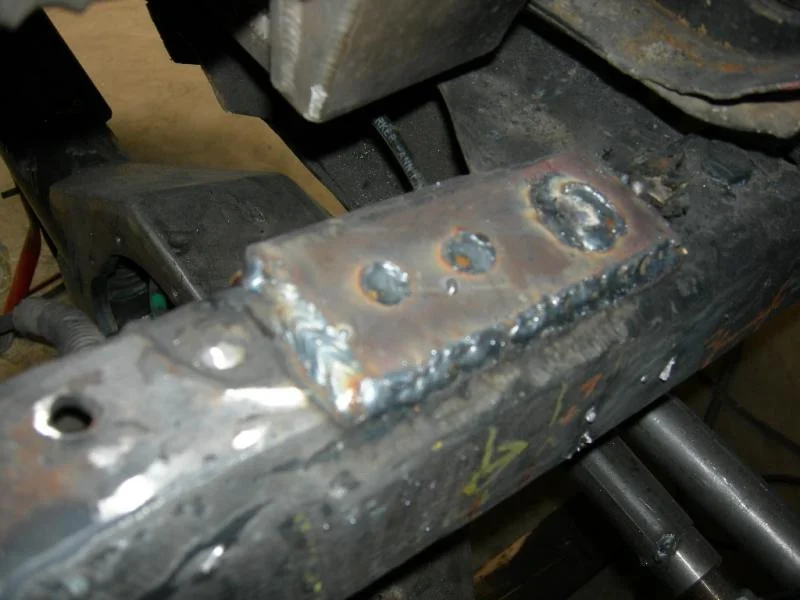

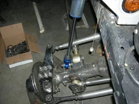

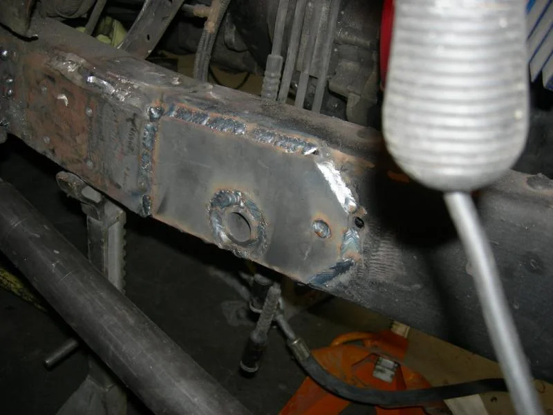

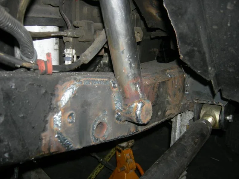

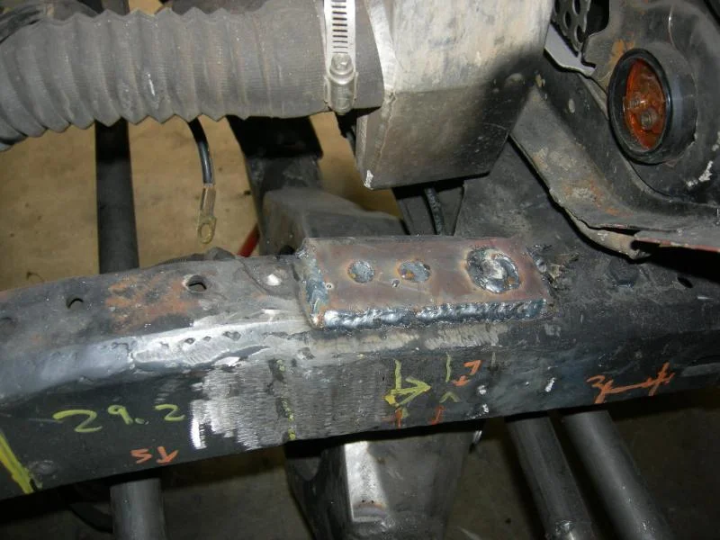

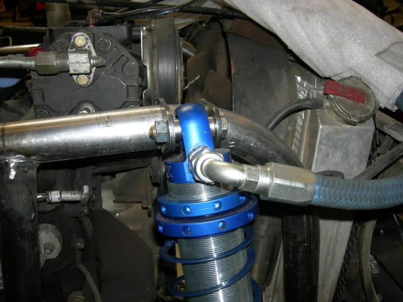

burned in the hoop side shock tabs. realized they were a bit thin, 1/8 so I doubled them up and burned them in. I will add some addititonal bracing later
Ran out of wire so I had to use a lighter gage wire and turn up the heat
