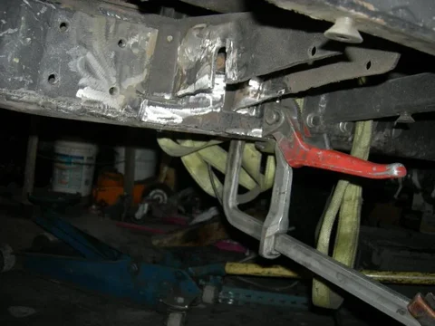

So what is that little red handled thing in post #256?
Looks like it clamps the whole thing down to the table.
Yep its a wazoo german clamp.. Its a crappy picture

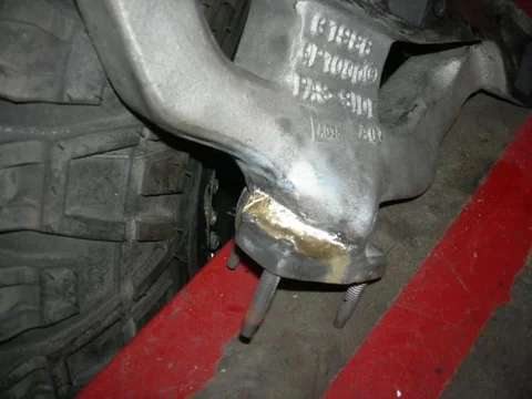

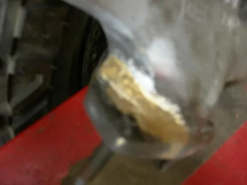

rather then putting on other exhaust manifolds I had a machinist braze the header together.
more pics
I hope it holds.. The machinist said that it was as strong or stronger. hummm

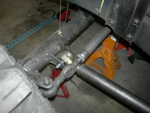

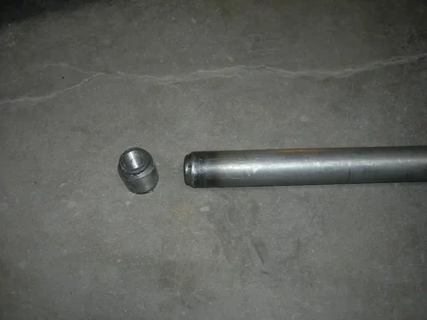

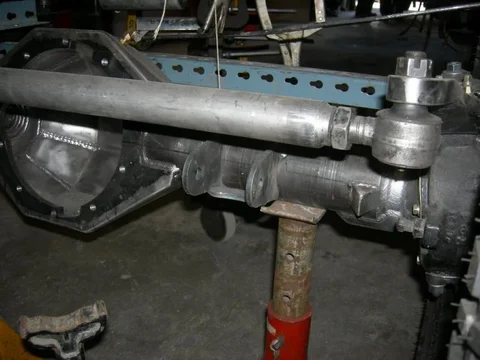

When I originally sleeved the tie rid made it too long. Cut it off and retapped. Had access to right hand tap 7/8 18 thread tap
one more pic

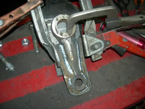

Had to bore out the tie rod end I had the reamer from the original build

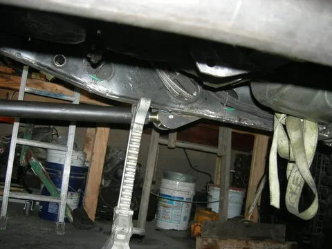

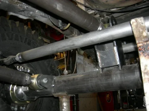

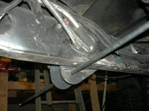

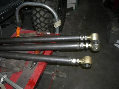

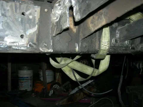

I did not want to put the links directly under the frame all though I should have.

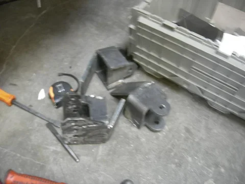

decided to outboard the frame mounts but lower them 5 inches so I had to angle them a bit.

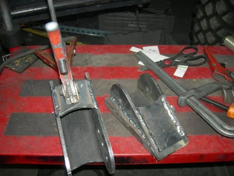

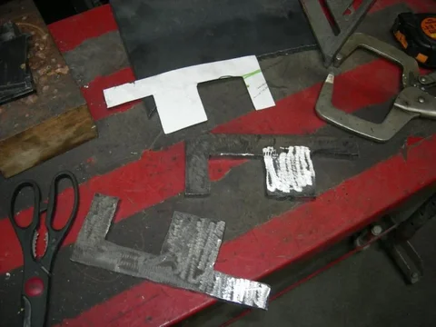

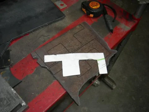

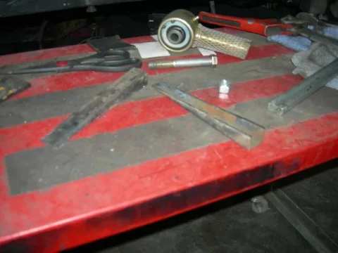

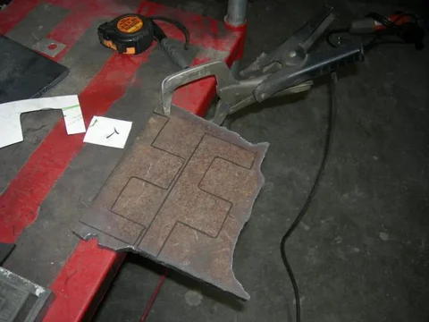

Make shift plazma jig
final cut
clamped and ready for the burn

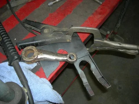

welded
Don't laugh about the welds, I can't seem to manage welding on my back because the slag hurts hurts hurts and there is crap for light
Why the beefy pitman arm if you are going hydro assist?
Because I am an idiot and often overdue things. After running the reamer the bell looked pretty thin, but the pitman arm is the length I needed. If I would have had a second opinion I wouldnt have done it. It sucks working alone because there is no end to my bad ideas.
