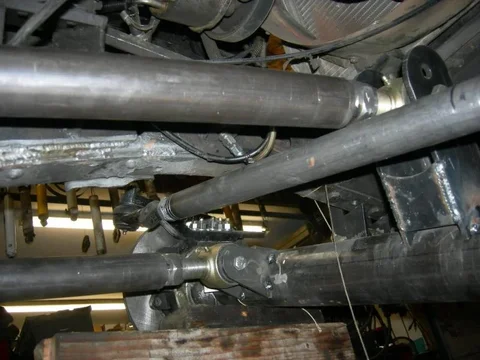

upper 3rd link
mounted upper 3rd link Frame side

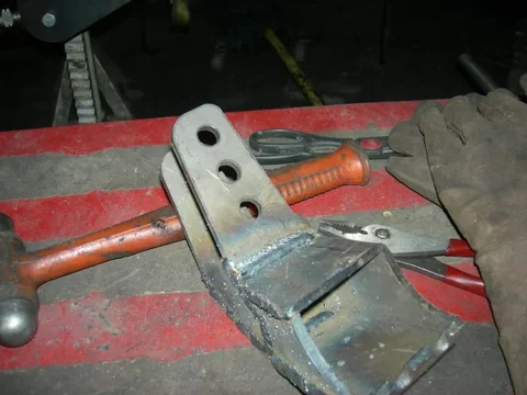

looks good. nice work. i used the same ruff stuff track bar bracket on my truck. That Dan guy at rough stuff makes some beefy brackets
I love his products. It would take me to much time to fab from scratch so slightly modifying his stuff makes it breez.

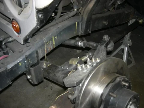

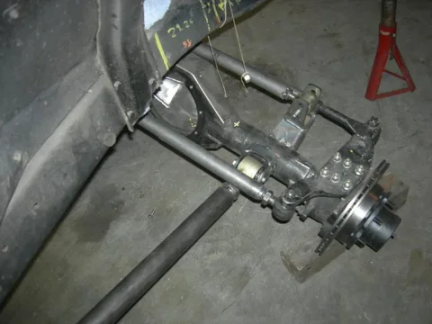

a couple of pic of front end set up

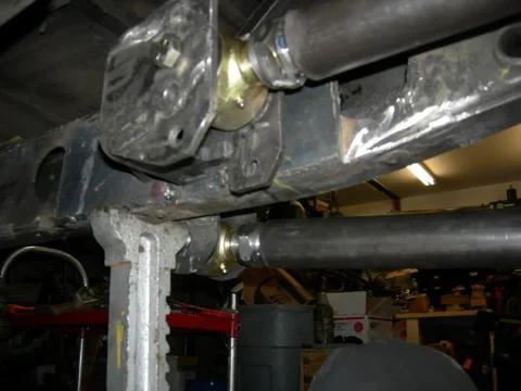

I tied to get the tie rod and the panhard at the same angle. I had to weld up the panhard frame and axle mounts and re-drill from 9/16 to .5. ughhh

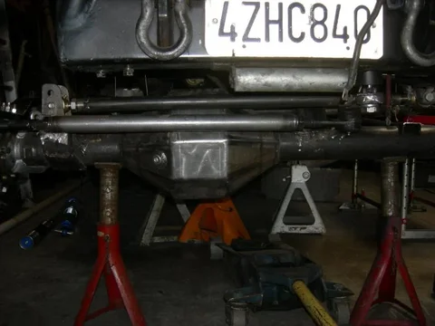

all the mounts are tacked in

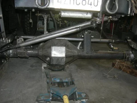

the pan hard is real close to the pumpkin but the panhard axle mount is not in its the final location
after a couple of adjustments due to clearance issues the panhard is as close to parallel to the tie rod as possible

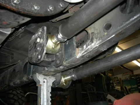

panhard pitman arm clearance, pretty tight
panhard axle mount is to close the tierod. I have another adjustment to make
I will most likely have cut into the frame on the passenger side to make room for the travel of the panhard bar

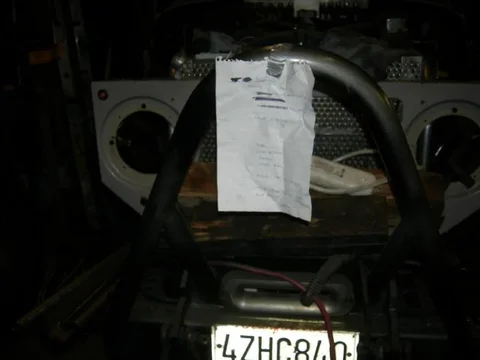

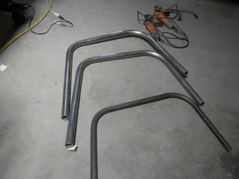

started to work on the coilover hoops
first removed fender skirt. I really want to keep them. I have so much crap mounted to the skirts I cant forsee remounting everything eslewhere.... blahhh
side view
side view

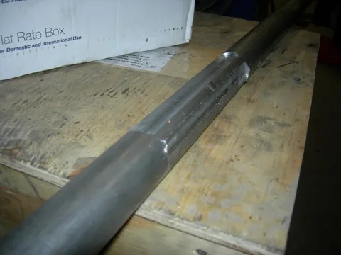

used some old automatic transmission line and a homemade 6 " radius guage that mocked up the shock hoops. I dont have bender so I had to contract the job out.
Using 1.75 od 120 wall.... blah
I have a set of fenders with the bottom arm mount already cut off if you want to trade.
I have holes cut in the skirts to make room for the coilovers. I built the hoops this last weekend and worked around the skirt arm so at this point I think I am going to keep them, still unsure. Plus I cut the fenders off....
