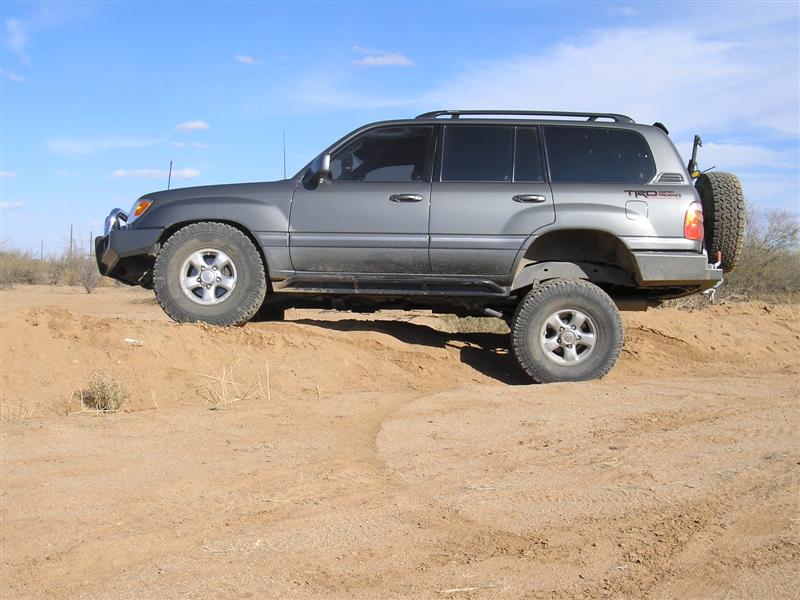

Really Rick? It's that simple huh? My own experience shows you are dead wrong. Sorry about that. My '93 80 is a notch below 4" and drives excellent. My friend slapped on J-springs with caster plates and it rides excellent. Nothing was pulled out of the ass. It was thought out. Slee did say that if I correct caster it might vibrate. It did, but many others have put on J's and to no problem.
On lifts greater than a couple of inches the target is 2*-4* caster and 0* pinion angle because a DC shaft is needed. What the resulting height is depends on your specific truck and the mechanics within it.
You have no idea how many 80's are in my AZ LC club that have 3-4 inch lifts and NO DC shaft. They don't vibrate either. Since this is the case, what's so "stupid" about my decision in trying the J's by themselves to see if my 80 too will not vibrate? Sounds smarter than spending 2K for nothing.

Yes Rick. I am a truck building dumb dumb. Just look at my 100. :D
To use your words, I again "didn't build to the truck, I built to desire".
Reality is the end result. The 100 is a marvel, with RTI scores almost identical to a 3" lifted 80. My Lexus? No better than anybody elses, but man, it turned out awesome thanks to Slee, OME, my mechanic, AND ME...for designing it (even though I designed it "wrong" as some say. :D Now, let's get back to MAF?

Dave
landtank said:
Shotts, put all those trucks in your examples on an alignment rack. Regardless of how they vibrate if they are not within the factory caster spec then they are not a sucessful lift.
All three are in spec.
The '93 just makes it.
The LX is spot on perfect.
The 100 is spot on perfect.
Sorry Rick.
