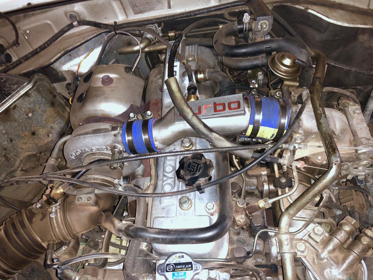

Replaced the cracked and 30+ year old (and NLA) rubber "air cleaner hoses" with silicone alternatives. Street cred from the tuner crowd coming my way!
If anyone needs to replace these hoses, let me know. They only sell them by the foot at my local auto parts store, so I have a small stash now and am happy to share with 13B-T owners in need.

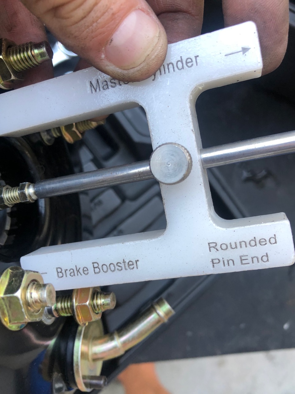

Righty's brakes have always felt a bit mushy. They worked fine, but didn't have a confident pedal feel of brakes on other vehicles. Pads, rotors, drums, etc. are fine. I bled and flushed with new brake fluid, properly adjusted everything, and even put a spacer in the LSPV above the differential when doing the suspension lift.
After all that the brakes were still mushy, so upgrading to an 80 series booster got put on my to do list. I was unsuccessful at finding a confirmed working used booster locally, so I decided on a new booster from City Racer , @Racer65 .
What an amazing transformation! For sure I should have done this years ago. Simple installation, reasonable investment, and completely night and day brake performance improvement.

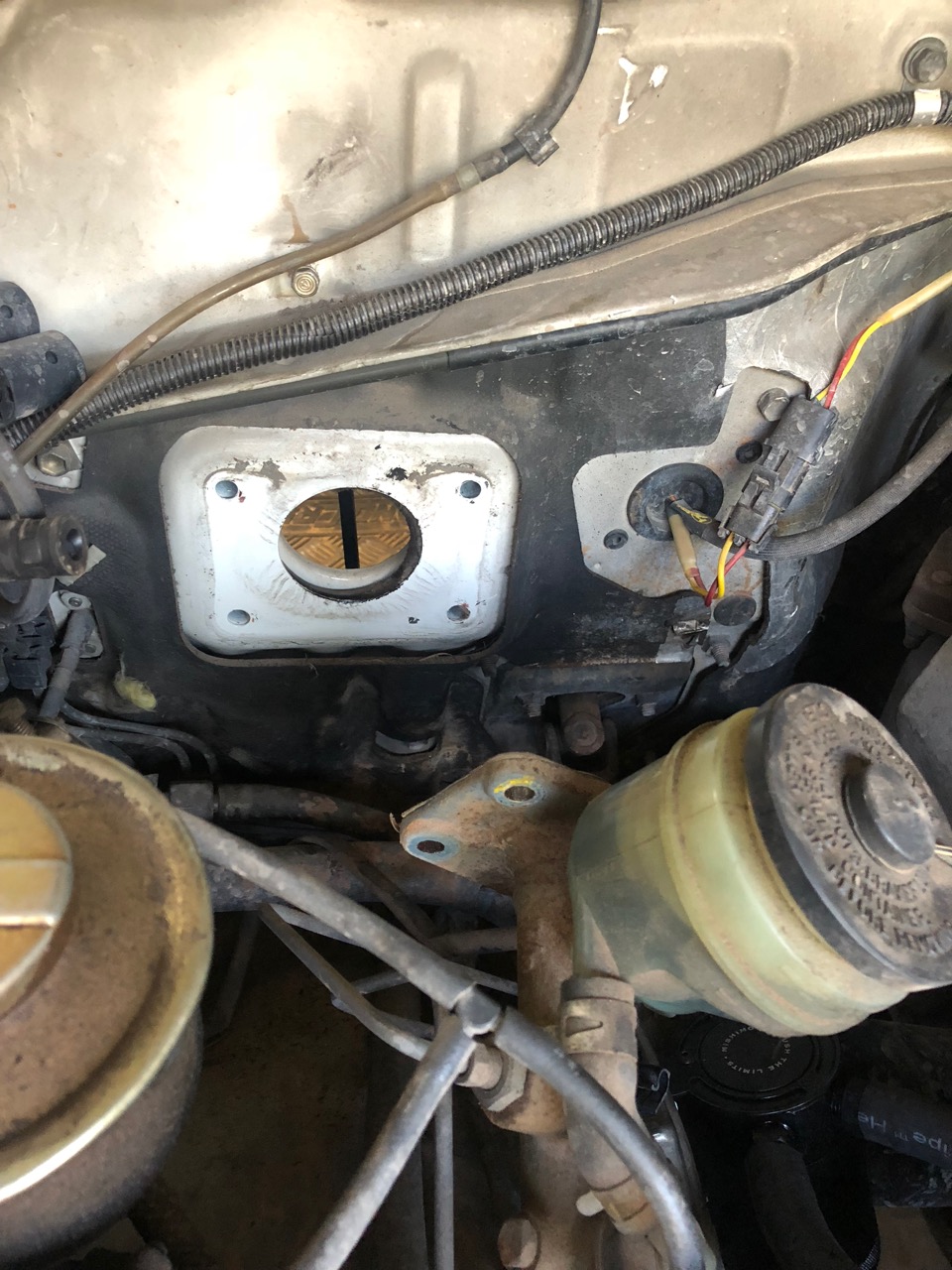

Installation was very straight forward, although not technically a 100% bolt in solution. Some research here will reveal the need to extend the shaft heading from the booster to the brake pedal. Easy enough after a trip to the hardware store for a coupling nut (M10 1.25). In lieu of the rather expensive Toyota SST to adjust the plunger heading into the master cylinder, I bought this one which worked out very well. Some longer vacuum hose was the last tweak needed and from there it was simple nuts and bolts.
Before
Out with the old. Plenty of give in the lines to move the master aside temporarily.
Using the $25 SST (which I'm willing to lend out if anyone needs it...drop me a PM).

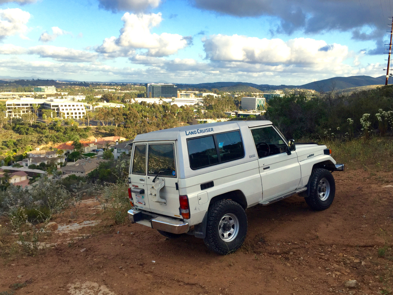

Took the steepest power line trail I could find (unlocked) in the neighborhood and gave the tires an initial test. Pretty impressive how this thing wants to climb and takes steep rocky stuff with ease, even at street pressures!
Nice view... and a good place to test the LC.
I know where that picture was taken...
The building in the center is where I work.
