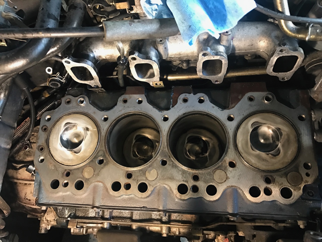

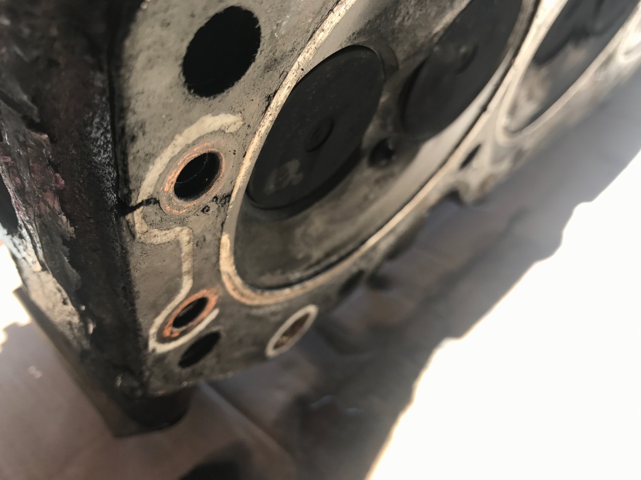

For some time, Righty has had an annoying coolant leak coming from somewhere near the firewall. After a mix of procrastination and denial, I finally got back there with a mirror and found a leak at the seam of the head and the block. Ouch. Off comes the head.
With some encouragement (and parts) from @beno tear down has officially begun.
For posterity, took a before picture while the coolant was draining
Turbo and injector lines off (I guess now might be a good time to consider relocating the EGT probe)
Valve cover and rocker assembly removed
Headless 13B-T...and time for a celebratory beverage!
Next morning I had a closer look at the head gasket and am pretty confident I found the source of the coolant leak

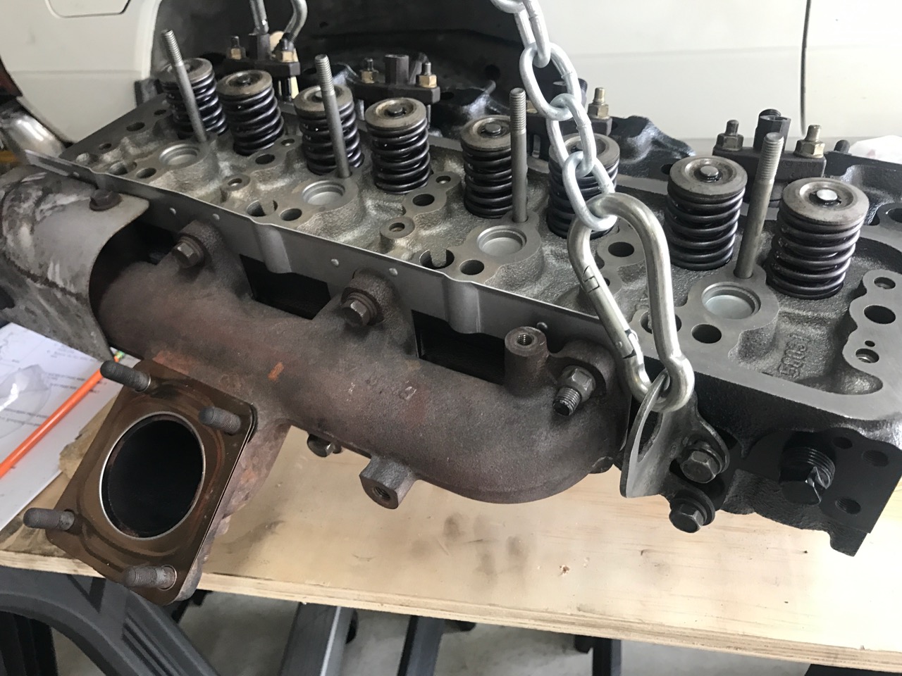

Continuing to make progress.
Dropped in the new head gasket which is a very different composition from the original
Bolted up the exhaust manifold and plugged in the injectors
Muscled all that into place and started bolting it down with new lightly oiled head bolts and following the sequence in the FSM.
Went to bolt the rocker shaft into place and ran into trouble. It seems the machine shop mixed up some bolts and gave me two longer than the others I'd given them.
While thinking about a solution for the bolts, I bolted up the turbo and intake manifold.

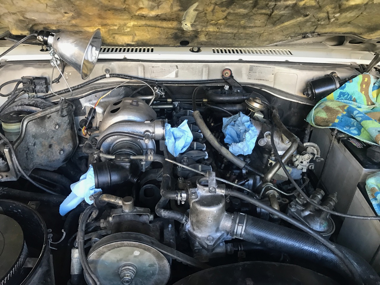

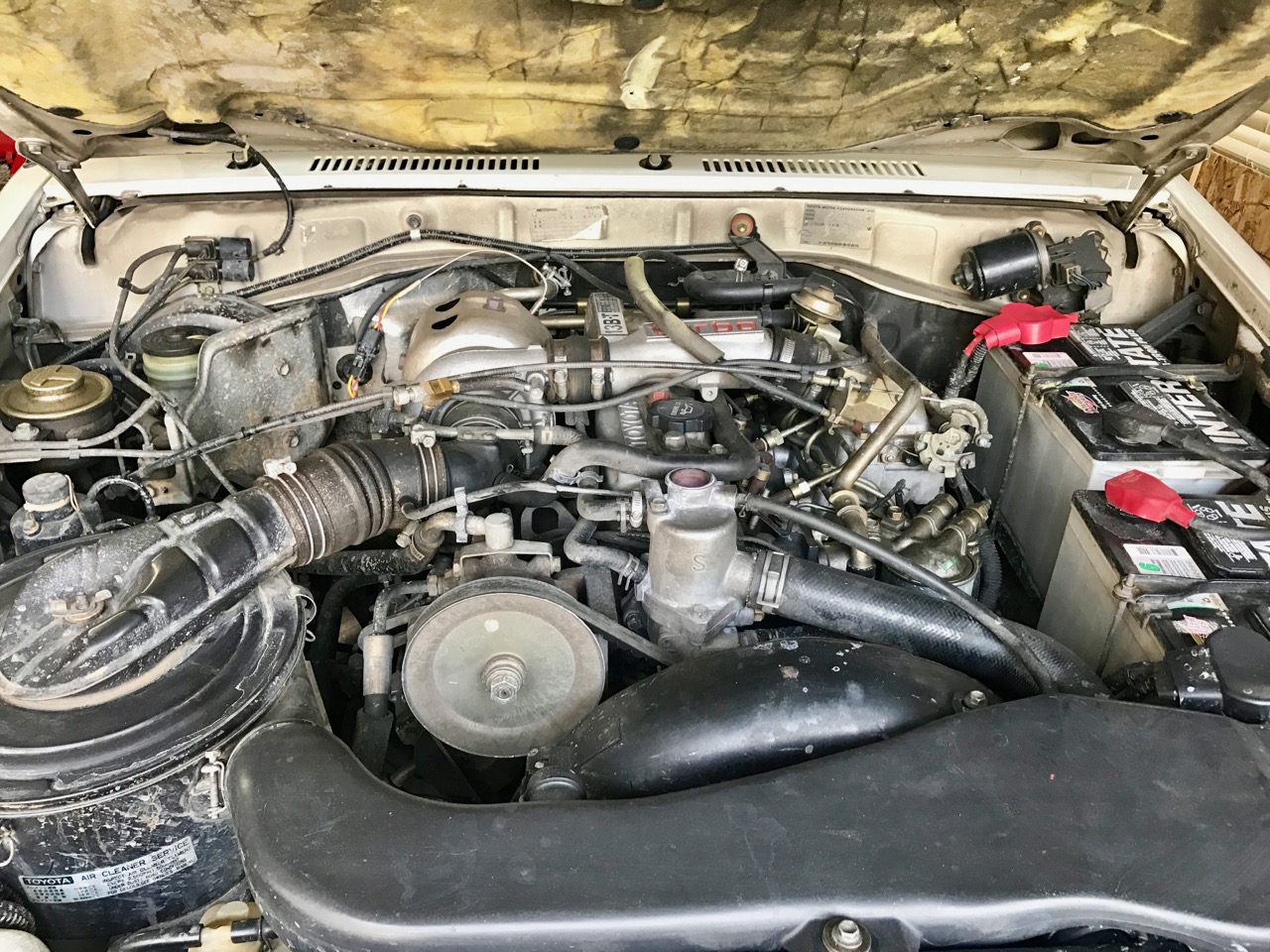

Finally, Righty is back on the road!
After solving the rocker assembly bolt length mystery (by going to the shop and getting the original bolts), I was able to bolt up the rockers, put the valve cover back on, thread the injector lines back into place, replace the bad manual priming pump (which caused me a lot of grief when I ran this thing out of fuel a while back), top off fluids, cross fingers, and finally twist the key.
Everything buttoned back up...even put on a shiny new oil fill cap @beno sent!
A couple pumps on the priming pump and a few nervous seconds before turning the key and...
It runs! <--- link to super exciting short video
A quick drive around the neighborhood didn't reveal any issues, so Righty rejoined the herd in the afternoon sun
And I enjoyed a Little Sumpin' Sumpin' to celebrate
Next up...valve adjustment and some time on the local trails!

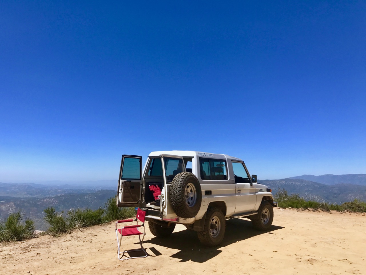

Took Righty on a test run up a local mountain and I'm pretty excited to report that everything went very well. No leaks, no temperature issues, nothing but good times.
Added some dust on top of the greasy remnants of the head gasket work
Been up this mountain many times, but this time felt better than most!
