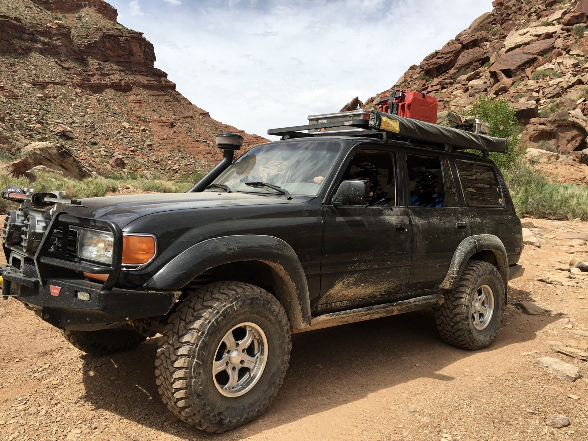

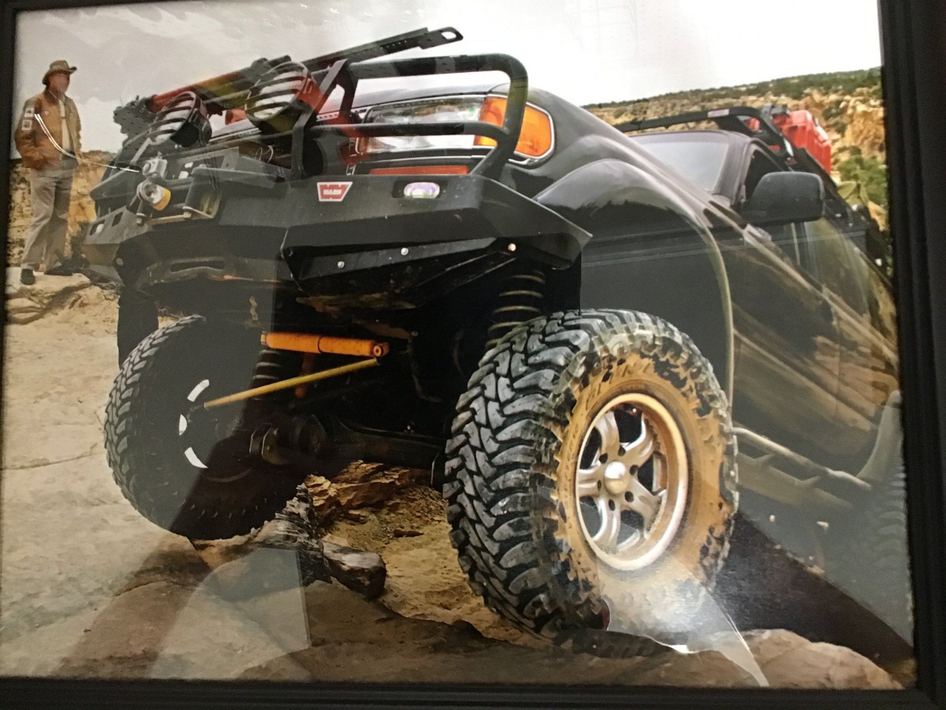

Here is a little inspiration.
Catching some air in the Swell outside of Moab, sorry for the picture I didn’t have Digital copy handy.
Same Truck, same area, different year with the family and my Bride driving!
View attachment 2462369Same Truck, same area, different year with the family and my Bride driving!
I like your box set up on the roof rack. Alu-box?
Yes, Really helpful because they seal out the dust and are reasonably light.
The larger one across the back is full of sleeping bags etc., The smaller front has a small camp stove and camp cooking items.
The center section is full of wolf pack boxes with light trail spares, belts, hoses, UV joints and a few other small bits. I have sometimes left them at camp or put them in the back of the rig if I don't need that area for sleeping.
The next mod will be the LRA tank and removal of the Jerry cans on the top (empty most of the time unless I know I will need them).
I built it 13 or so years ago and continue to jettison anything I don't need, there will be a significant purge as a Fall/Winter project as the kids have gotten bigger and are demanding more room!!!
I have a Frontrunner rack and I've been considering getting some alu-boxes or Zarges boxes to go on the rack. I want them to be solidly held in place but easily removable. I know Eezi-awn has a quick mount system so I may try to adapt that or make my own mounting plates.
