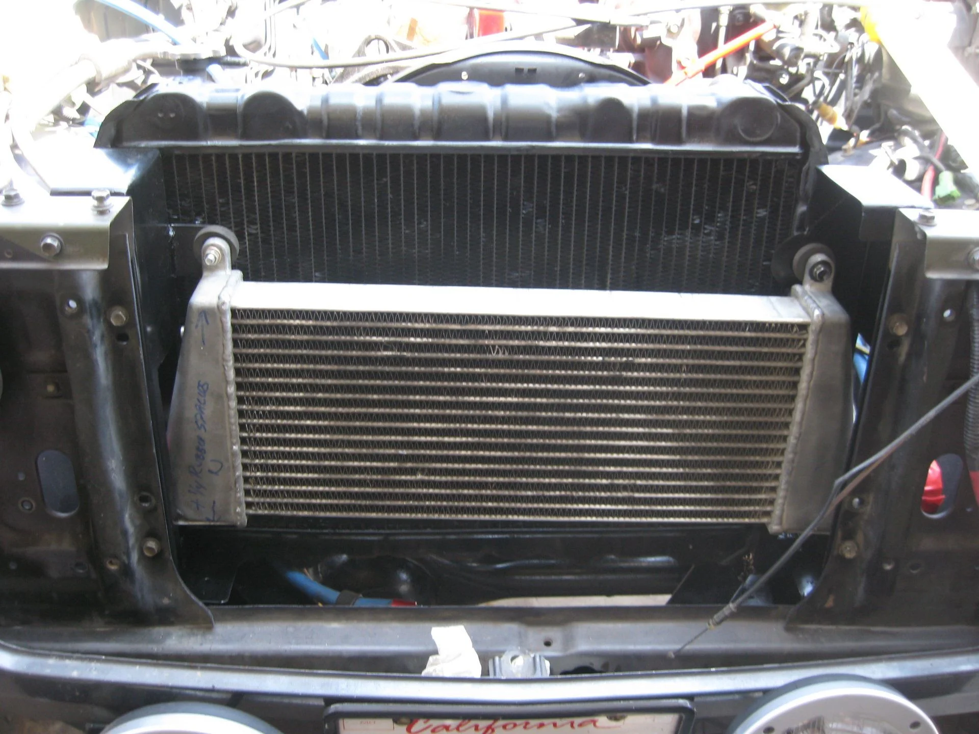

update . i went with the fuso 4d34 and have the engine and trans in and its working well however iam in dire need of an intercooler kit . sugestions ?
You could build your own from piping kits and inter coolers sold online. You need to figure out what size piping and cooler you want to run. I built one for my HDJ81.
I agree and that is what I did on my 60 with an Isuzu 4BD2 swap.
Here is a sample of mine, and lots of pictures in my swap build linked below.

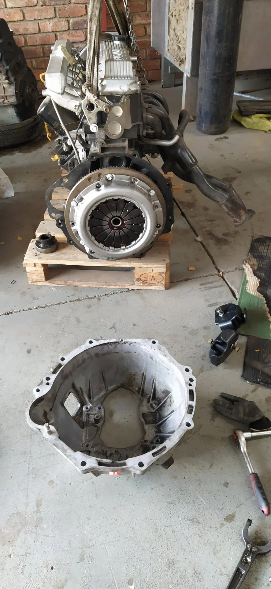

Got the gearbox ready and all the clutch components done, with the bellhousing ready for mating. Now for the interesting part of trying to get everything to work with the new diesel. Its all the electrical stuff that is terrifying me LOL . Baby steps
