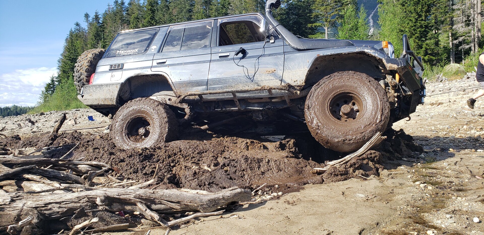

This is my 77 from many years ago, and roughly what it will look like once done.
