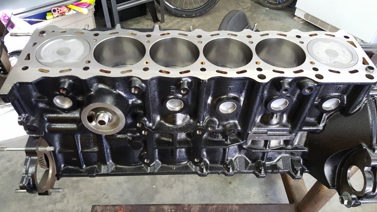

Engine #2 now home from the machine shop.

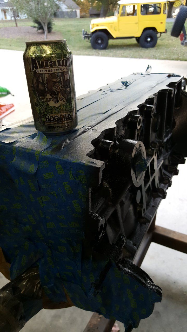

Job one is cleaning, masking, and painting.
(Note .... here is something you will never see on a Chevy .... Stainless steel freeze plugs)

I love the look of aluminum but sure wish there was an elegant chemical way to get it clean. just takes time, elbow grease, and beer.

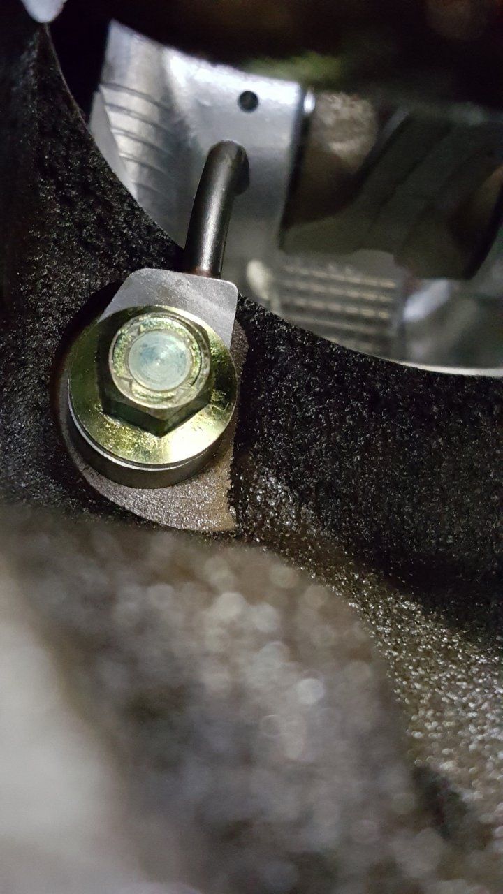

While you're at it be sure not to forget the oil squirters ... You're looking at the bottom of the piston in this pic.

Also, measured stud height to 3.275". With head gasket that leaves one thread exposed on the nut.
Are the studs a stock item or did you change from head bolts? If you changed, is there a specific reason for that change?
Not stock. These are ARP studs which, in this case, are made for a Toyota Supra. Studs offer an increased and more even clamping force than bolts which is important for taking good care of the head gasket, especially in boosted applications.
The main issue is an increase in torque efficiency and you get to assemble the engine and go through the torque sequence with all threads already fully engaged .... not so with bolts.
