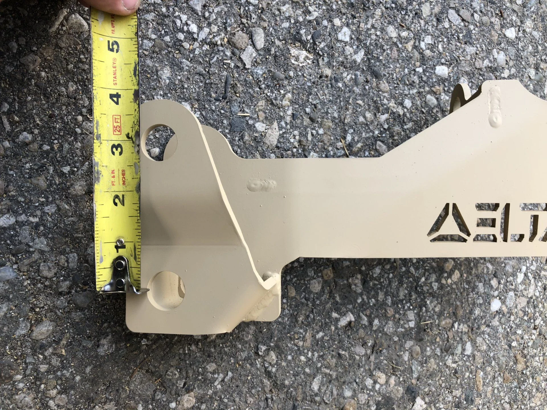

I've been toying with the idea of having a Panhard bar bracket made for my rig, since the front has the Man-A-Fe brackets. How far does your bracket lift the mounting point?
Thanks,
Andrew
Thanks,
Andrew
It lifts the mount point 3”. That can be adjusted as much as you want (on our end) to tailor to your lift. First batch is that because it was prototyped on this rig which had a 3” ICON lift package.

Panhard bracket question - what is the total height gained?
I look forward to business in the near future.
Side Note - Hit me up if you want pictures or routing info on my 80 series Safari Turbo air to air intercooler.
Same to you Phil! Looking forward to the next time for sure. If you are ever in Idaho, we’d love to show you around a bit. Very nice rig btw, was nice to see in real life!
Total height gained for this iteration of panhard is 3” (because it was prototypes on this rig that has a 3” ICON kit installed. Dave will soon be trying on his personal rig that has 2” OME springs to see how it works there. Guessing it’ll be fine. After that, will be making versions for taller lifts as well, if there is a demand. Fairly straightforward to adjust the dimensions of that piece.

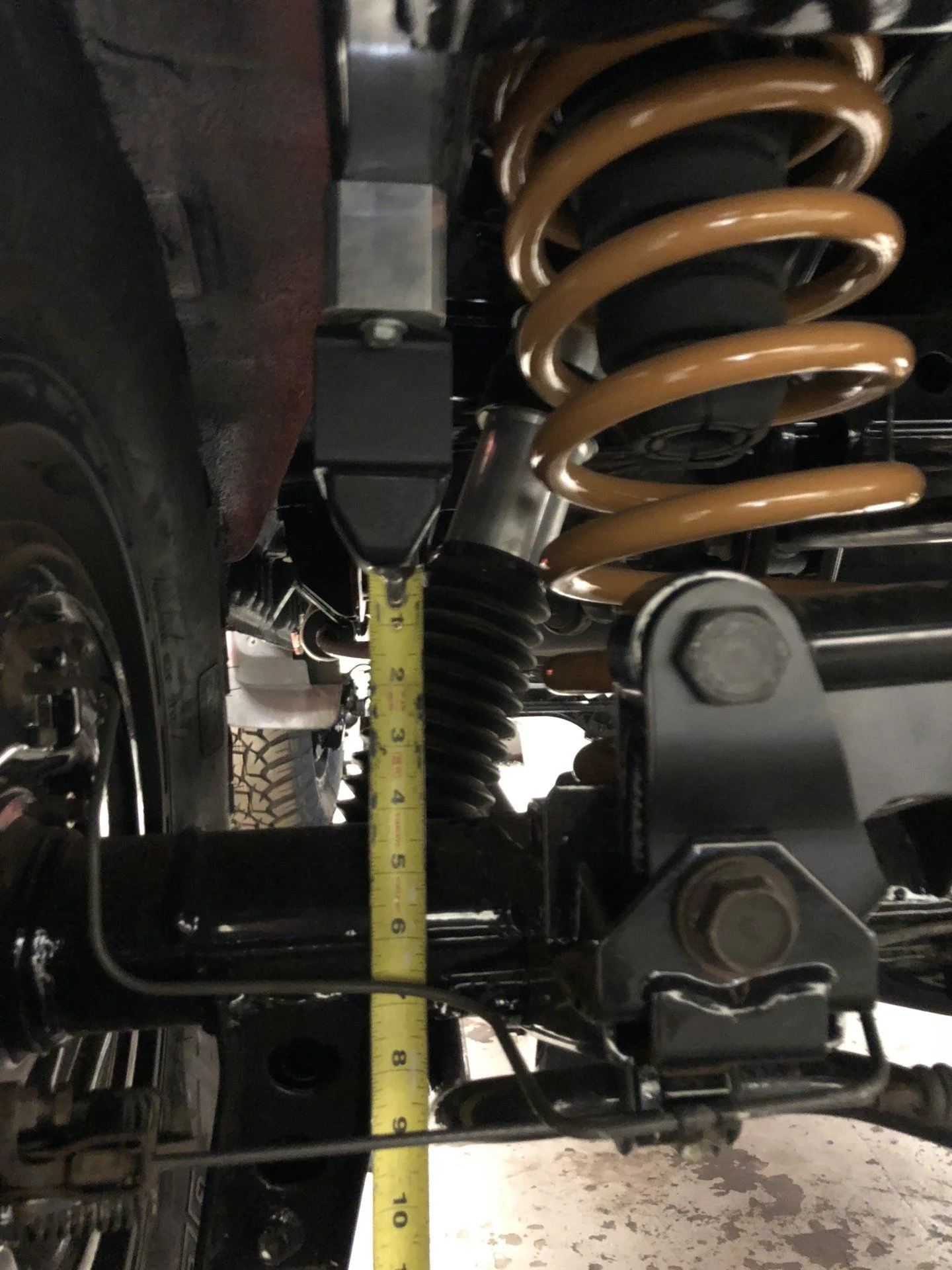

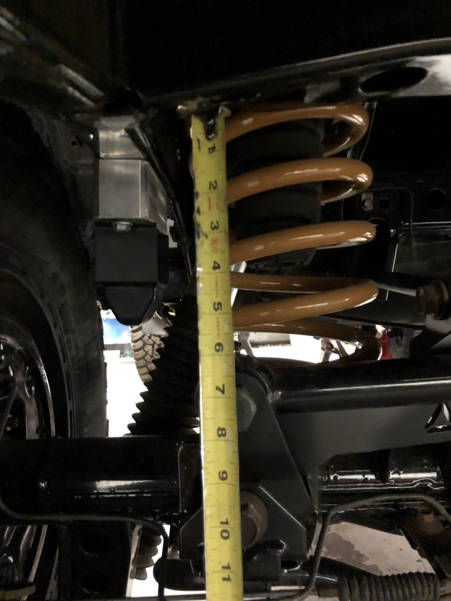

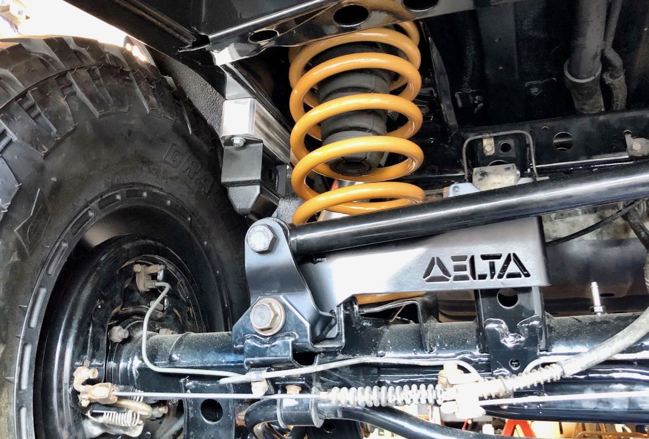

You can certainly order one and we will put it in with the next laser order (next week or so). YOU 100% MUST PUT SPACERS BETWEEN FRAME AND BUMPSTOPS IF YOU GO THAT FAR, OR YOU WILL HAVE INTERFERENCE. Will post a pic shortly.
And just because the other picture makes it look like the these don't move the panhard a full 3", here's another shot of it.

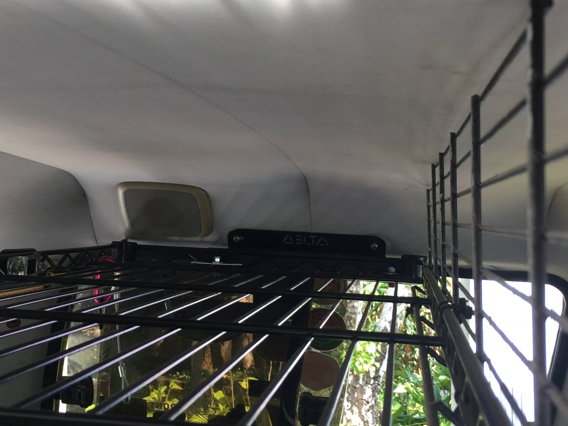

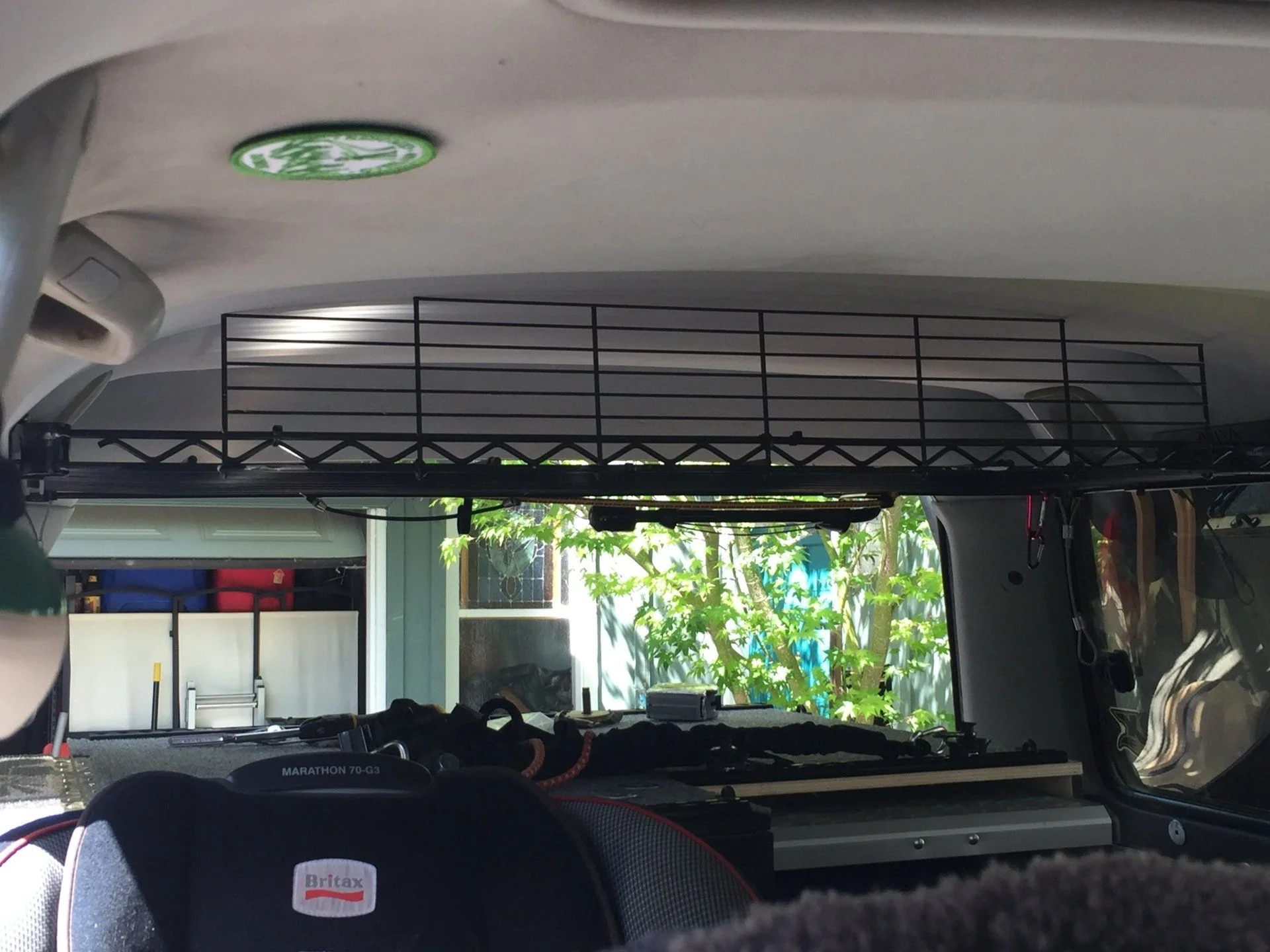

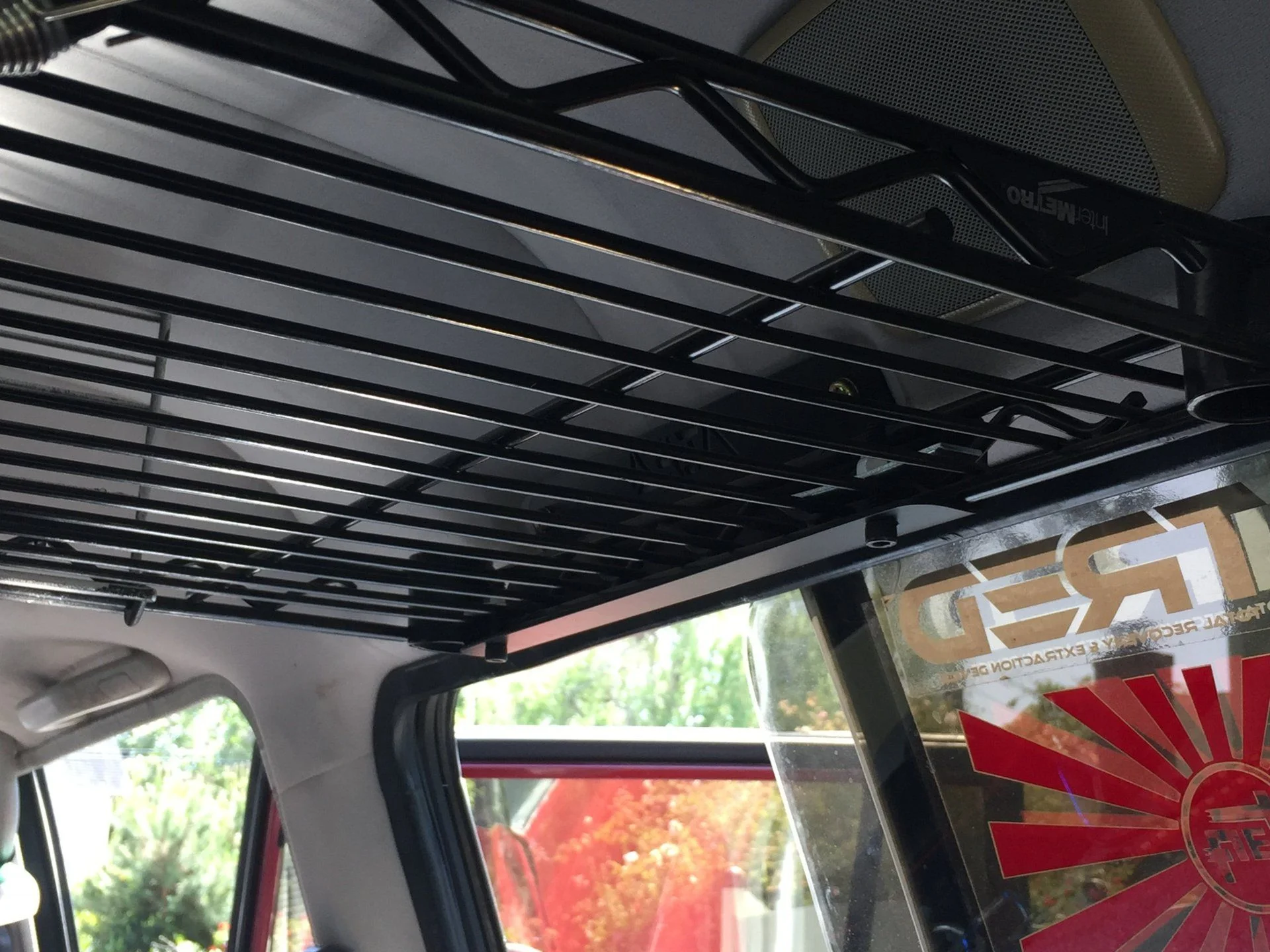

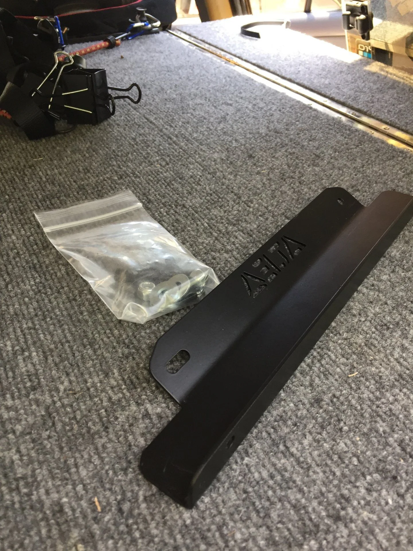

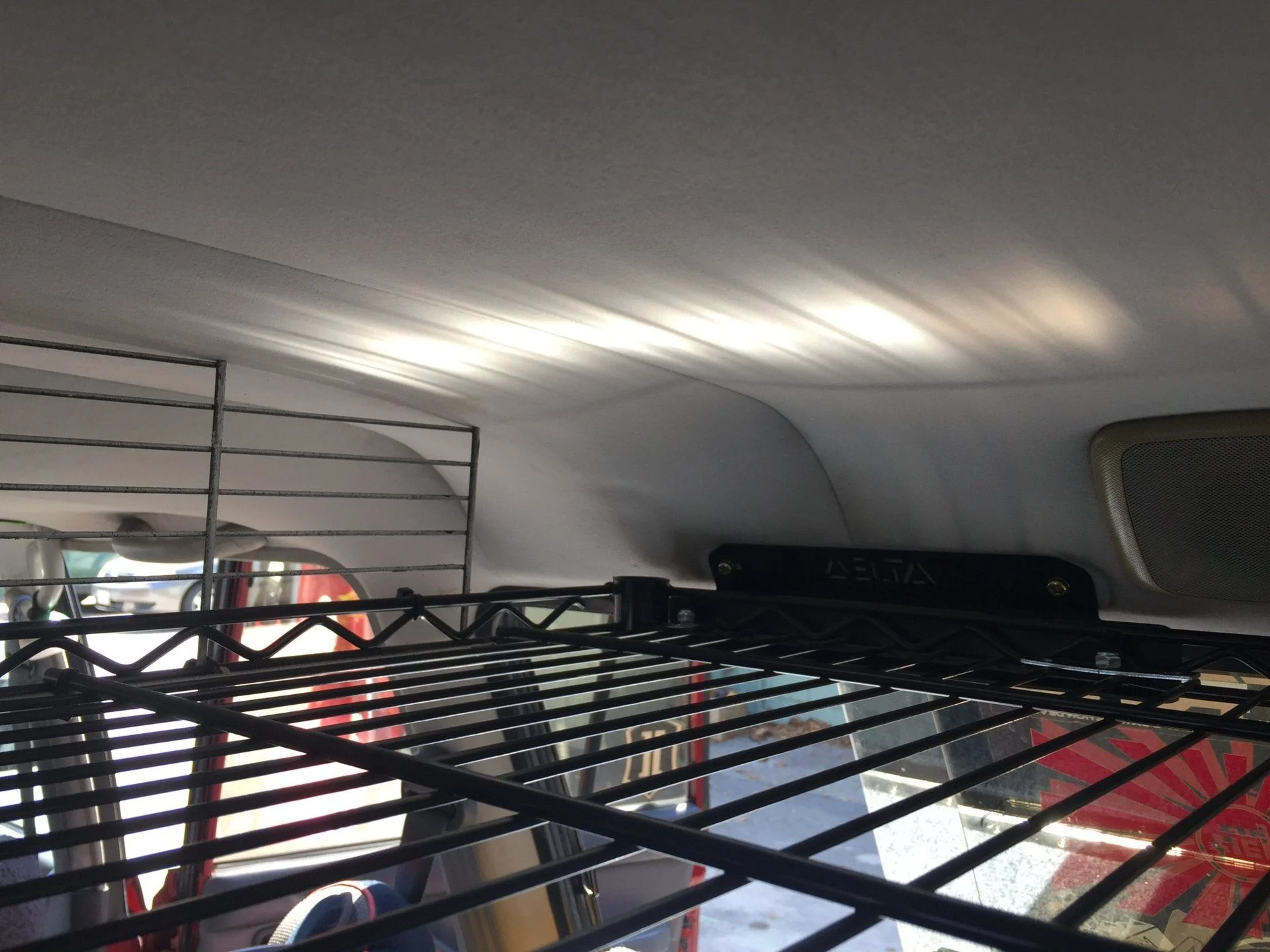

Installed my attic brackets a few days back. Pretty self explanatory but once removing the grab handles you see how flexi they are. I had a bit of movement of my attic before but it is solidly mounted now. There are two types of wire rack to use. Ones with the wire running front to back and one with the wire running left to right. Ideally the brackets mount better to the front/back wire style shelf. Ex: Additional Chrome Wire Shelves - 48 x 18" H-3182C - Uline
View attachment 1718990 View attachment 1718988 View attachment 1718987 View attachment 1718986
RAD! Nice install, very cool to see parts go in.
View attachment 1718761 View attachment 1718762
How much bumpstop spacing is needed for the 3” bracket?
I have the Slinky kit, want to see the 3” bracket will work with the extended bump stops that came with the kit.
We put 2” blocks in and that is more than enough. 1-1.5” would work just fine.
The 5” bracket (what we’ve decided to offer) will NEED larger ones. When it’s avaiable we will have that all spec’d out.
Was about to ask the same thing. I lost 1 1/8 inch of up travel already with longer shock body of 4 inch lift shocks, from the picture there is only ~4 inch max of axle up travel. What’s the bump stop extension length in the picture? 2 inch?

Rear panhard lift bracket. We looked hard for one of these before diving into the project and came up dry. Man-a-Fre used to make some, but they were on the wrong side and hung down quite a bit, and are no longer available. This product is very easy to adjust for any lift height, just have to make sure your bump stops get dropped the same amount as the panhard is lifted.
