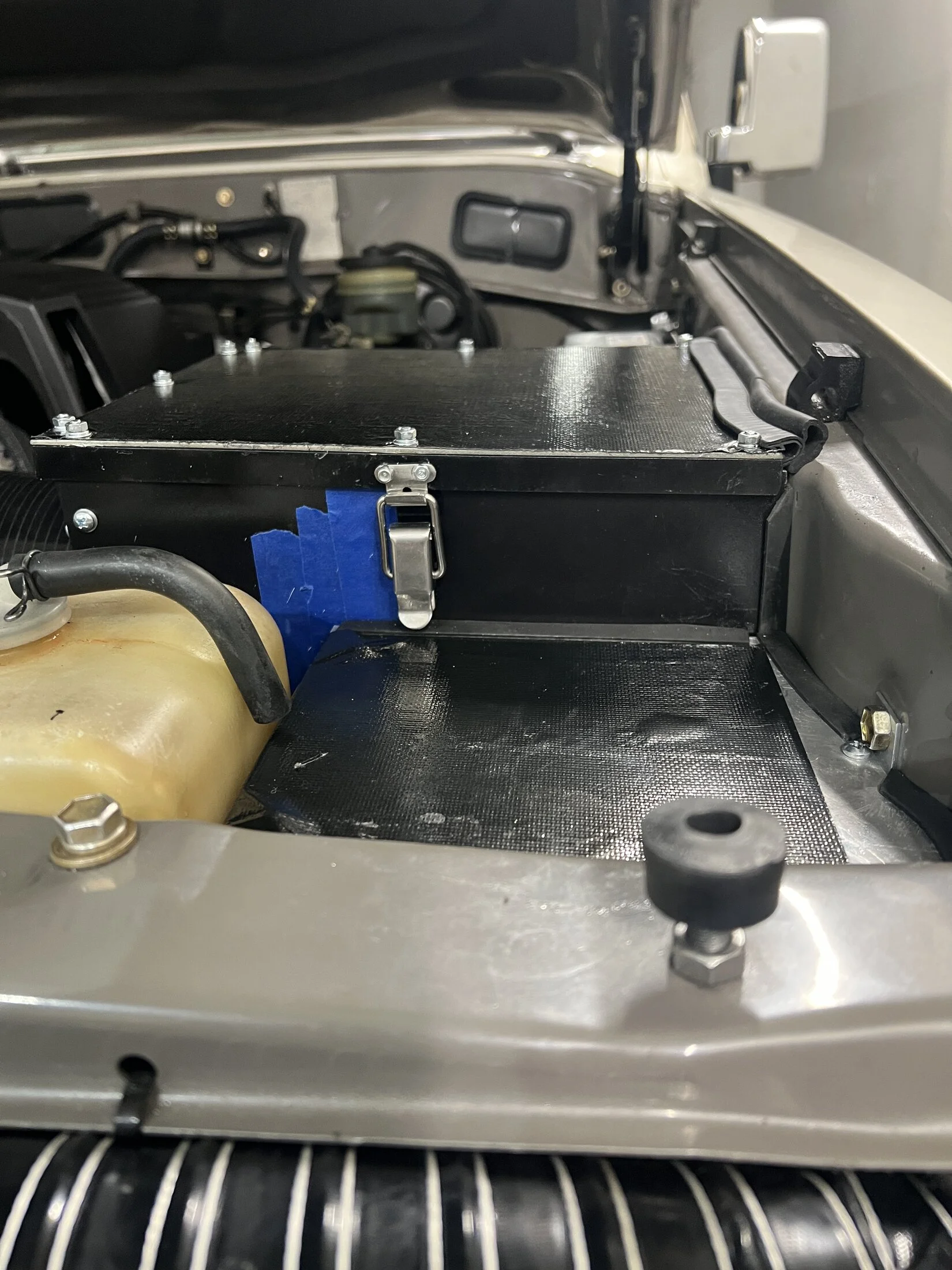

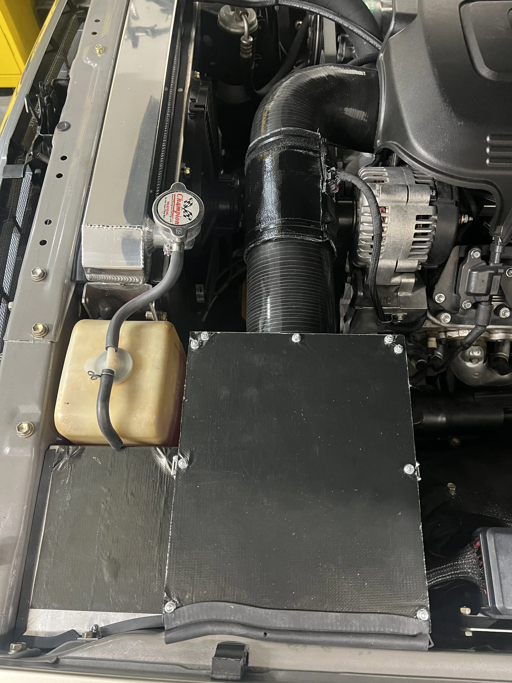

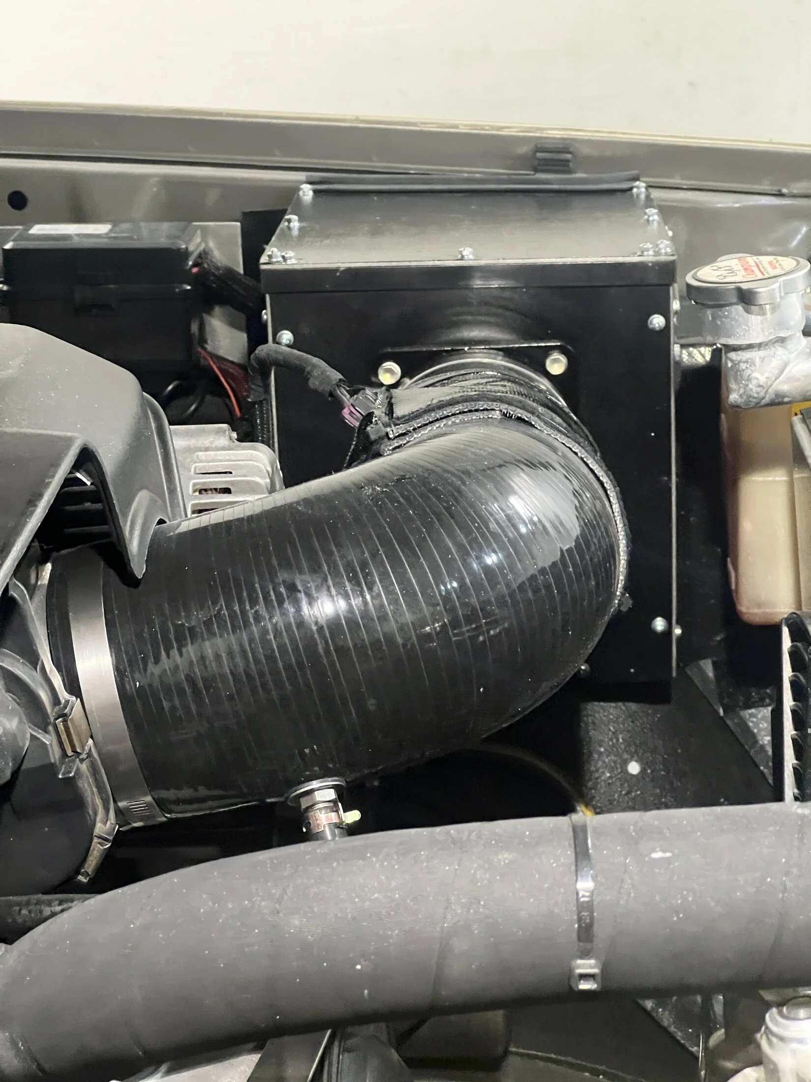

Some additional pics. I added a shroud around the intake to help IAT. The silicone tube replaced the aluminum
