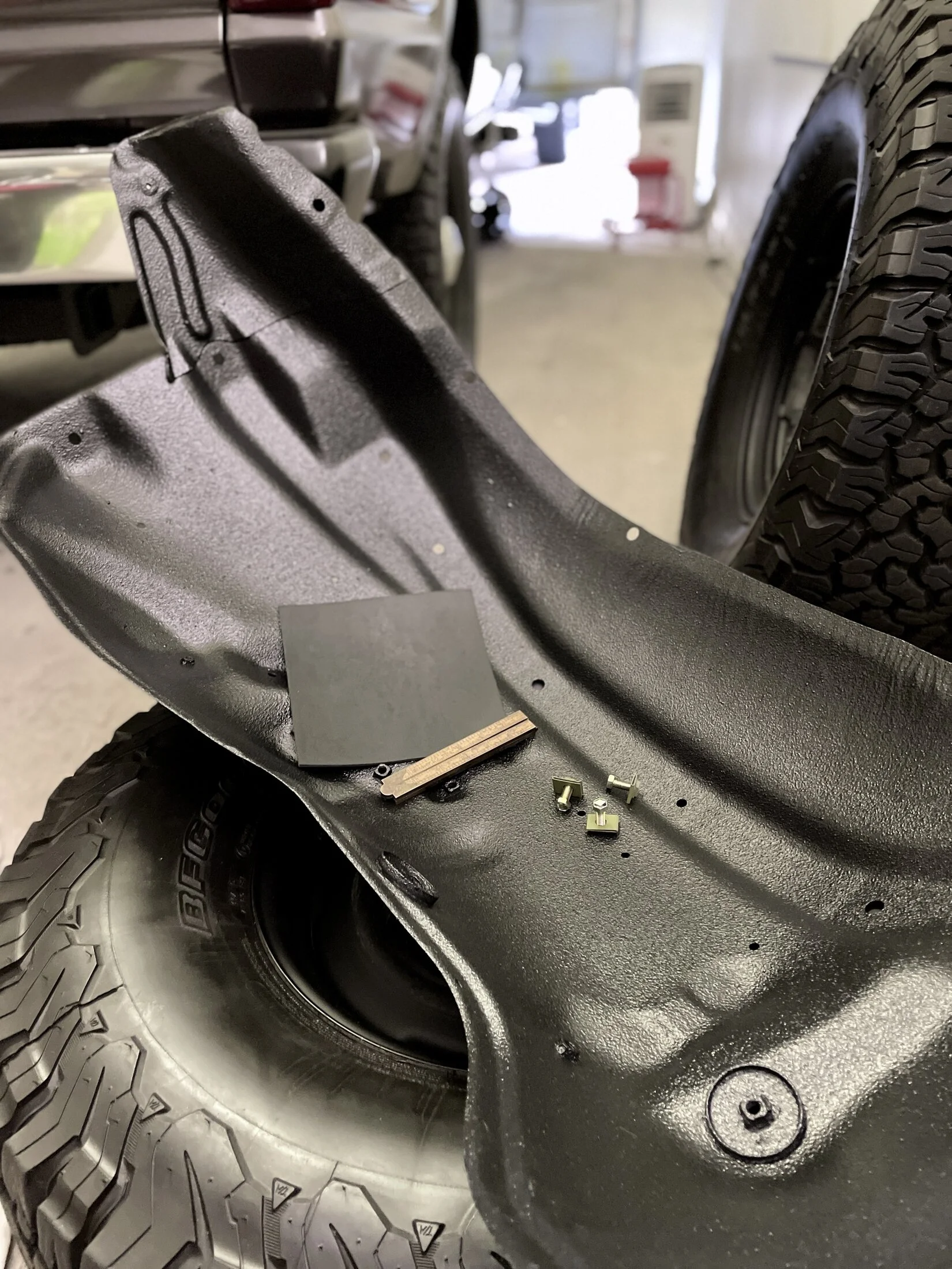

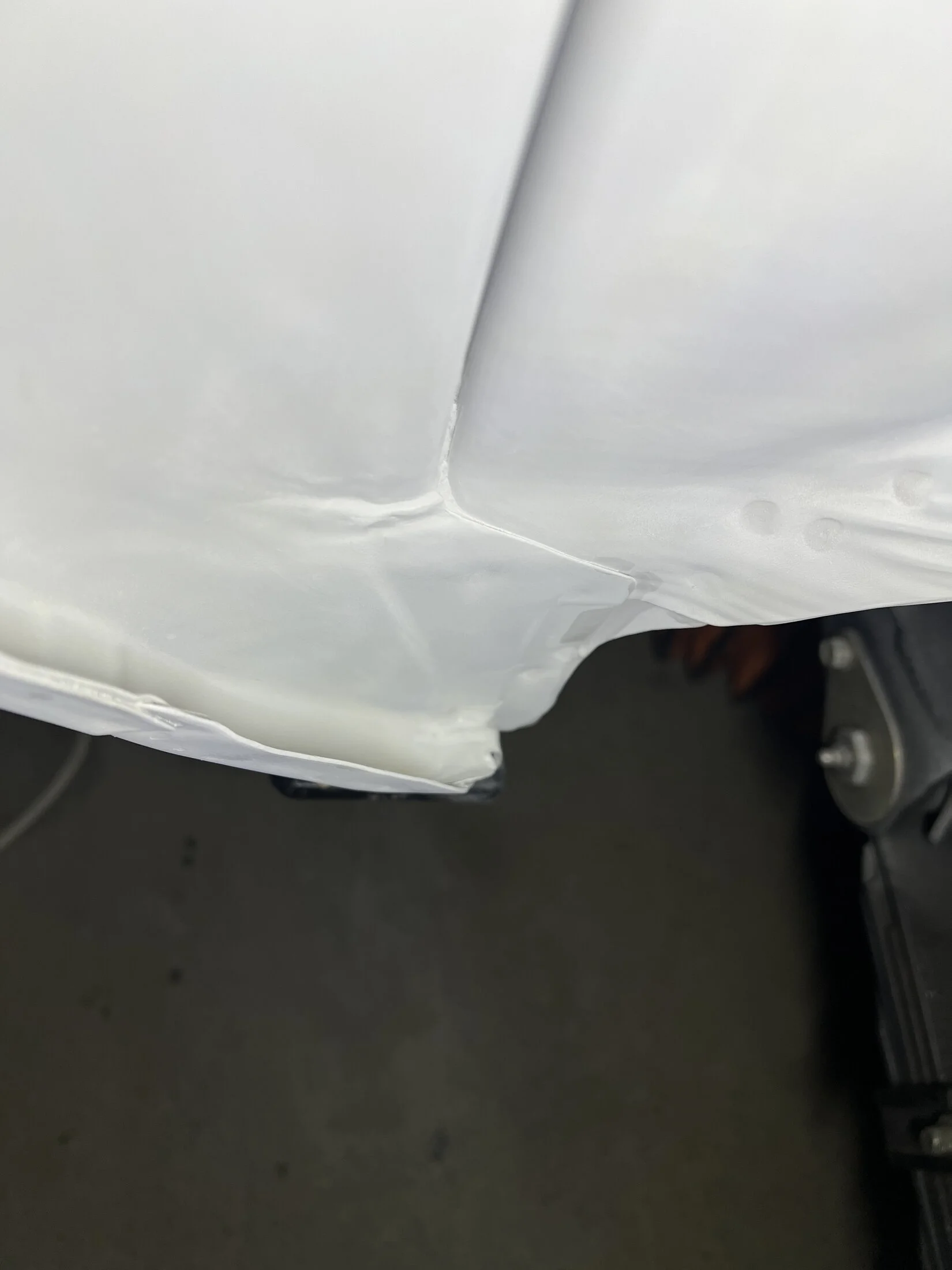

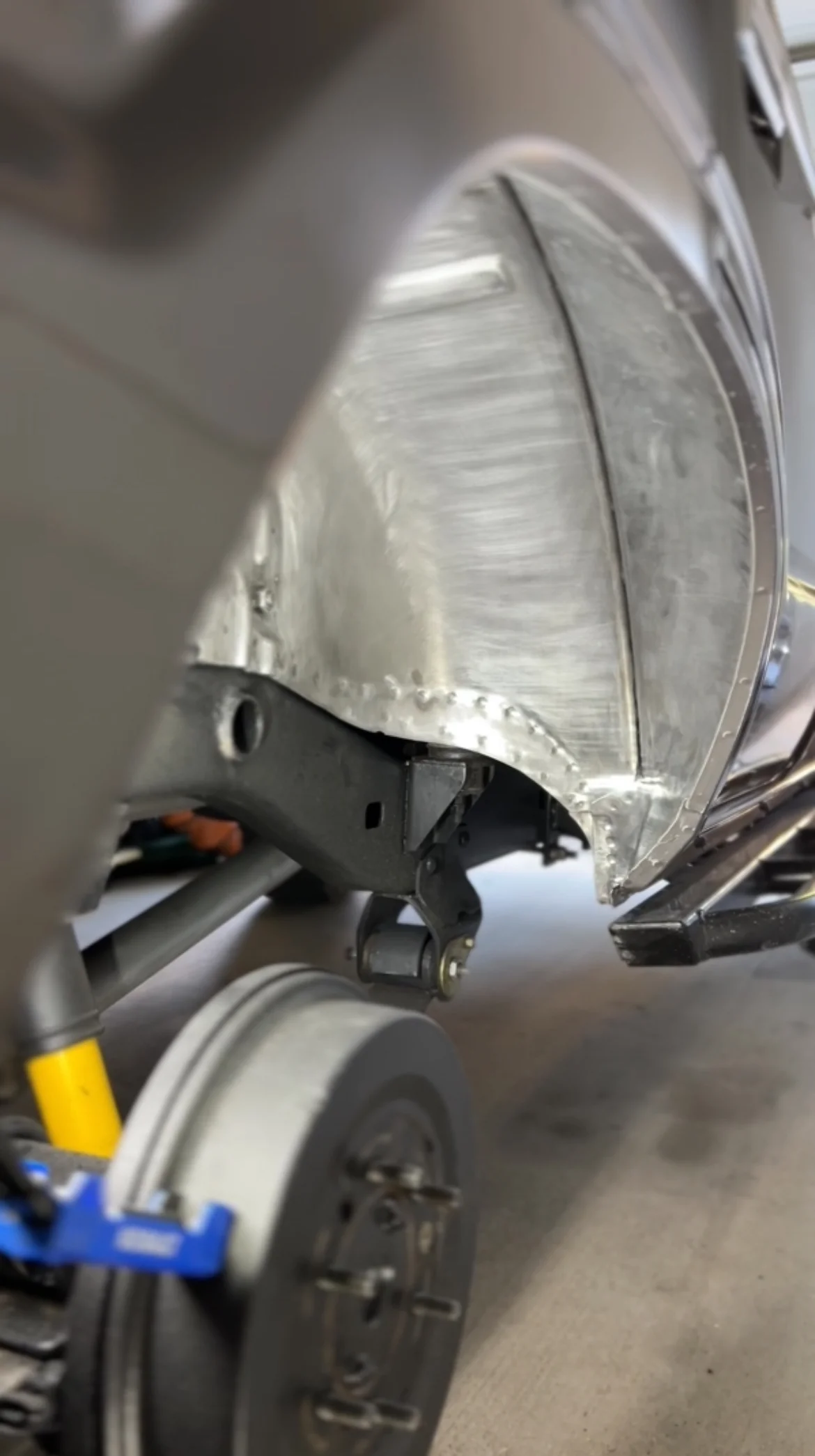

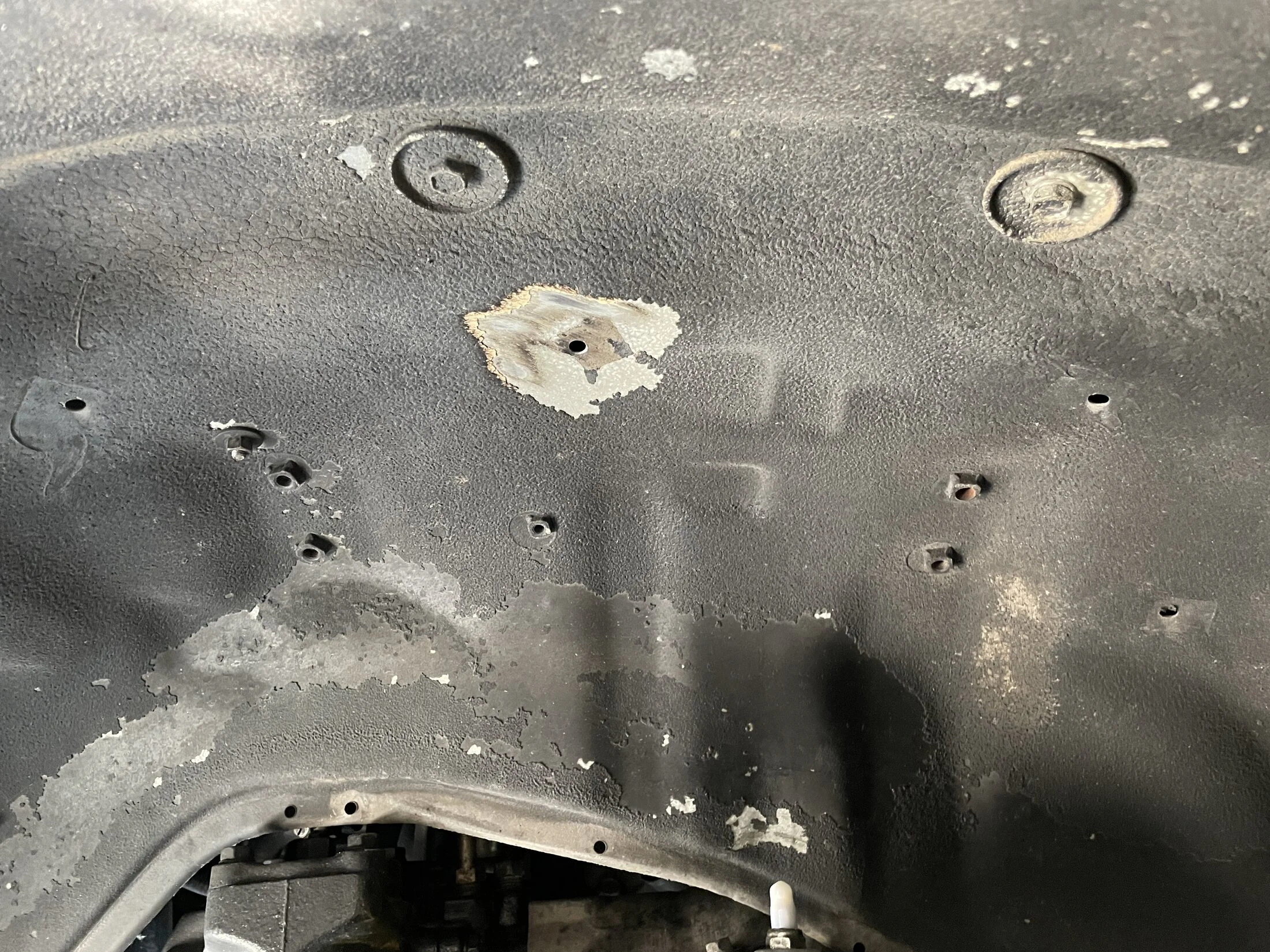

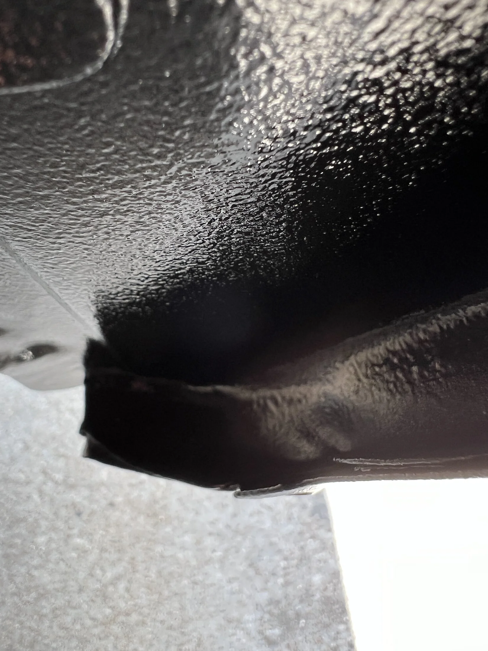

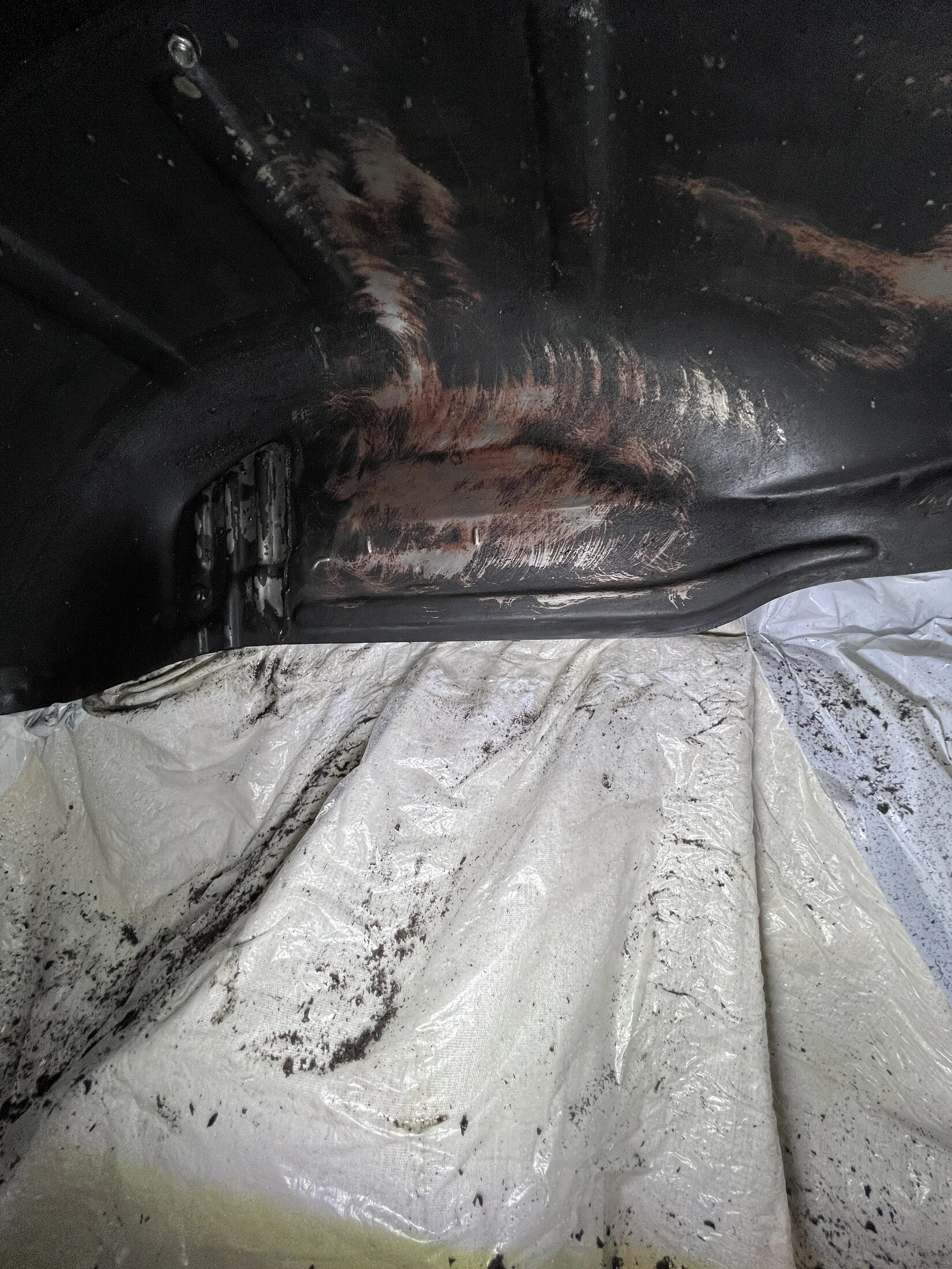

I had to take the bad decision I made out of the wheel wells from when I first got Cali. The rear cleaned up perfect. I’ve got color coat and 2 top 2k clear coats to do. Roughed surface with 120 grit and base coat SprayMax 2k Epoxy Primer. (That is rubberized undercoat) I was cleaning and saw what looked like rust, it wasn’t, was the rubber melting from cleaners….
Very impressive! I struggled with the front fender coating and gave up. Would love to hear how you handled those or if it’s the same as the rears

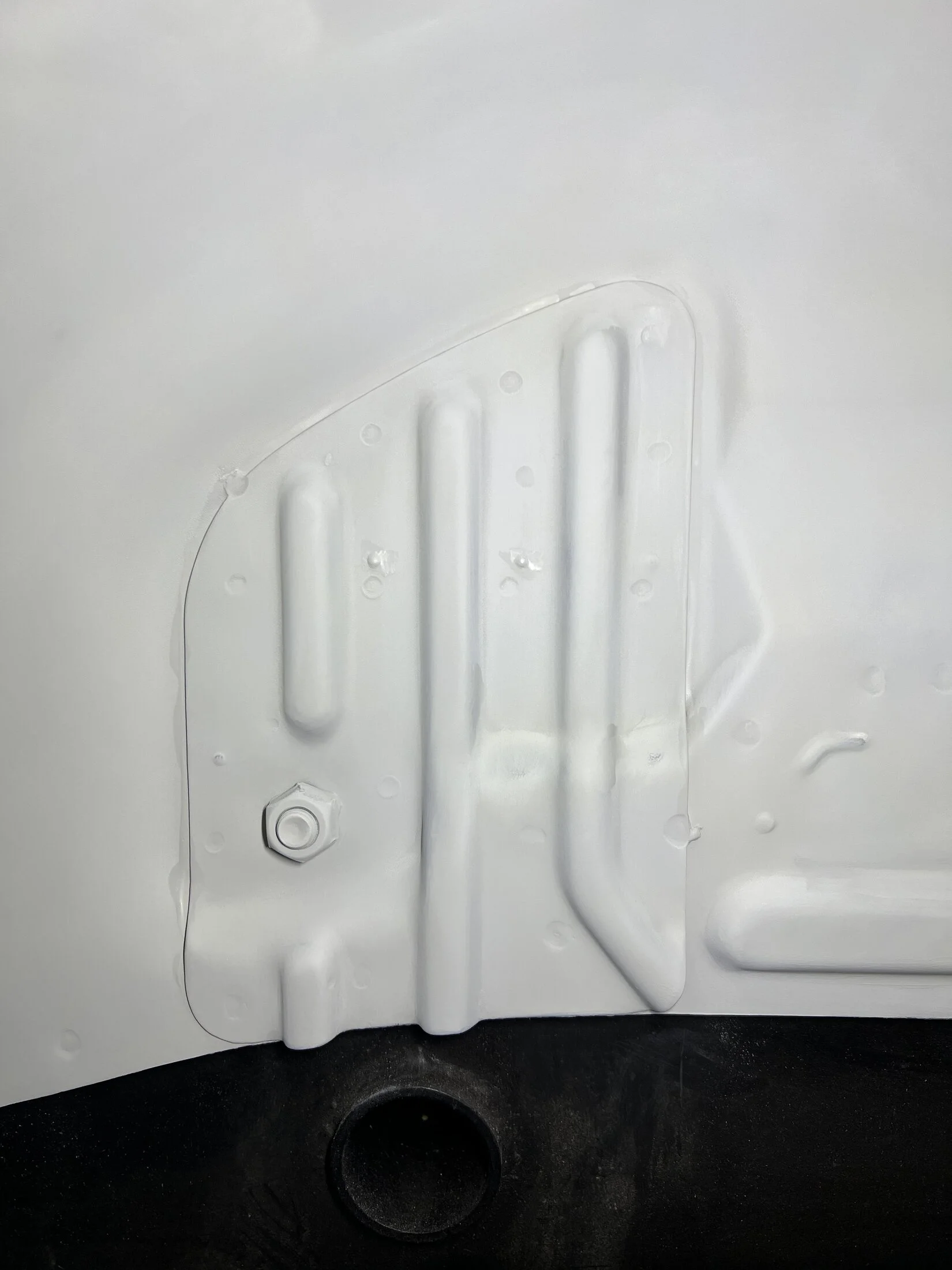

Wheel Wells FJ62

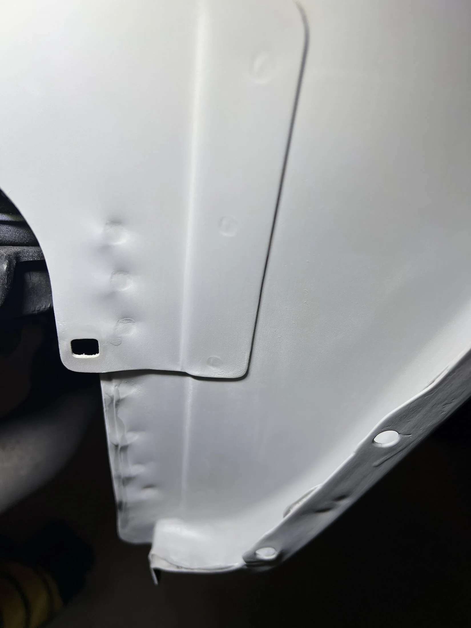

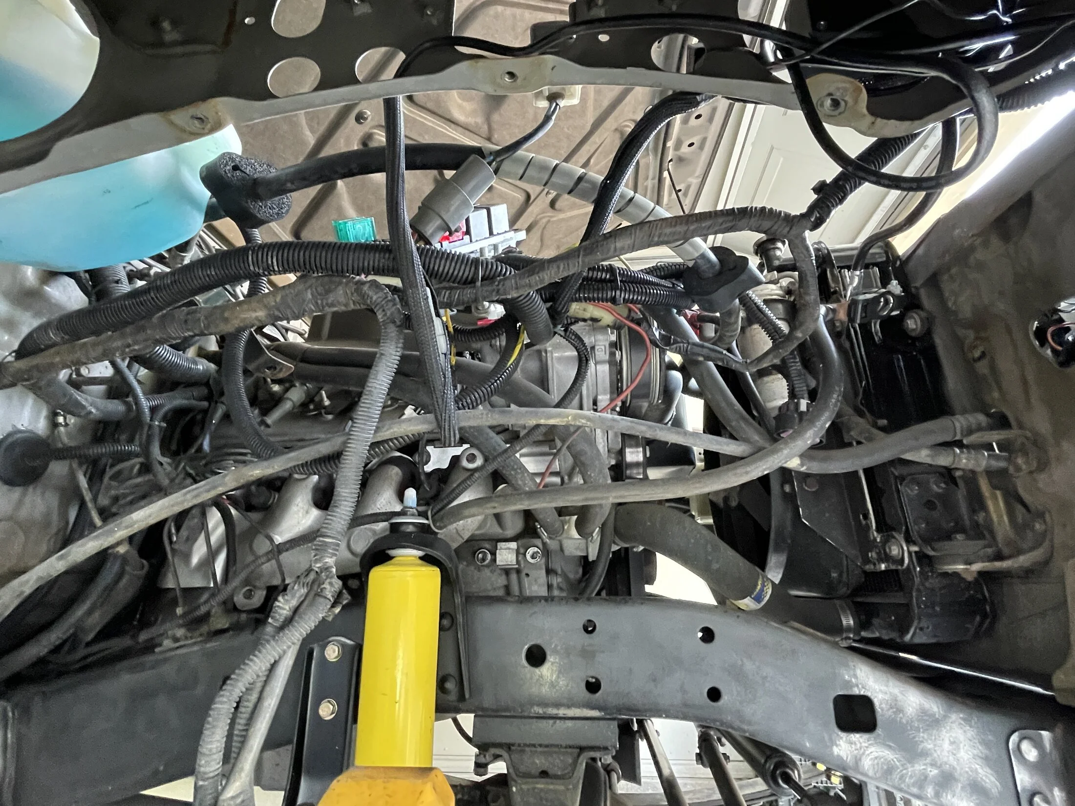

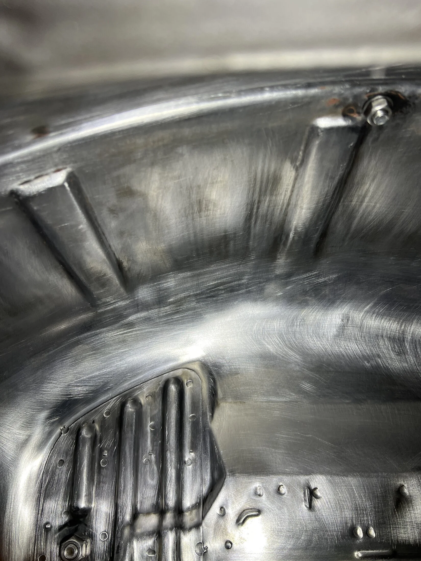

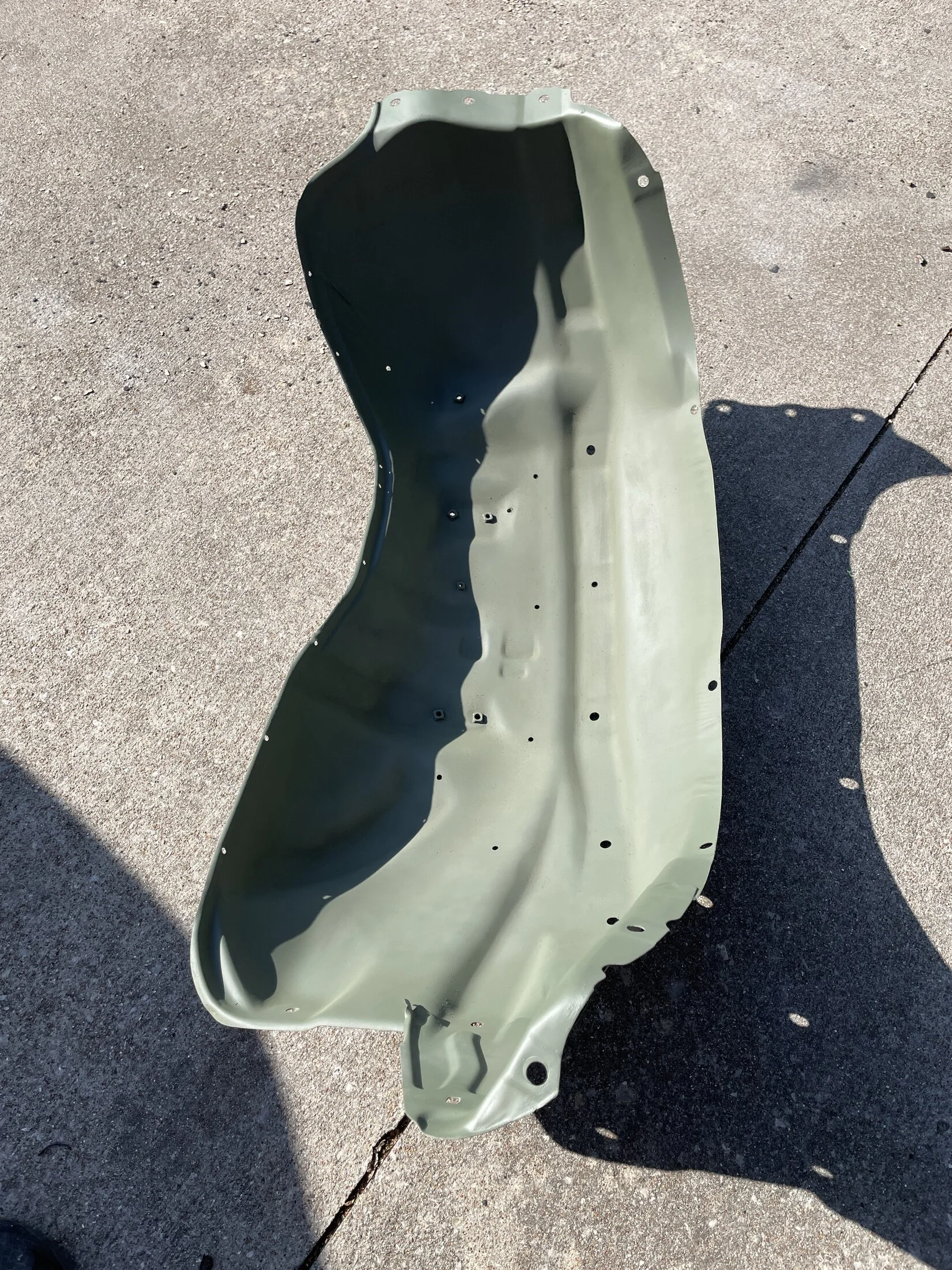

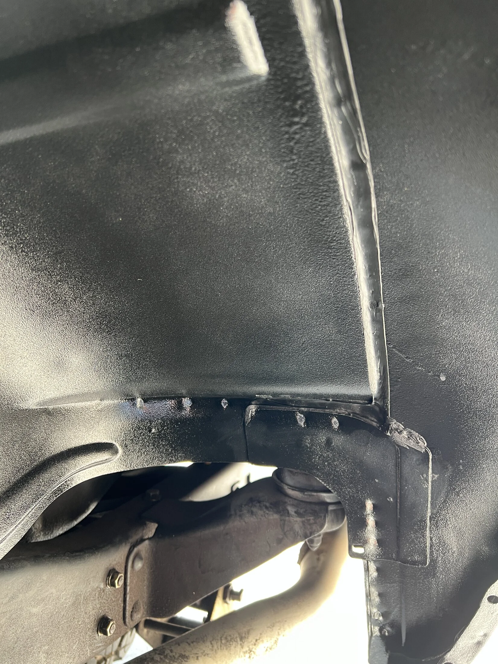

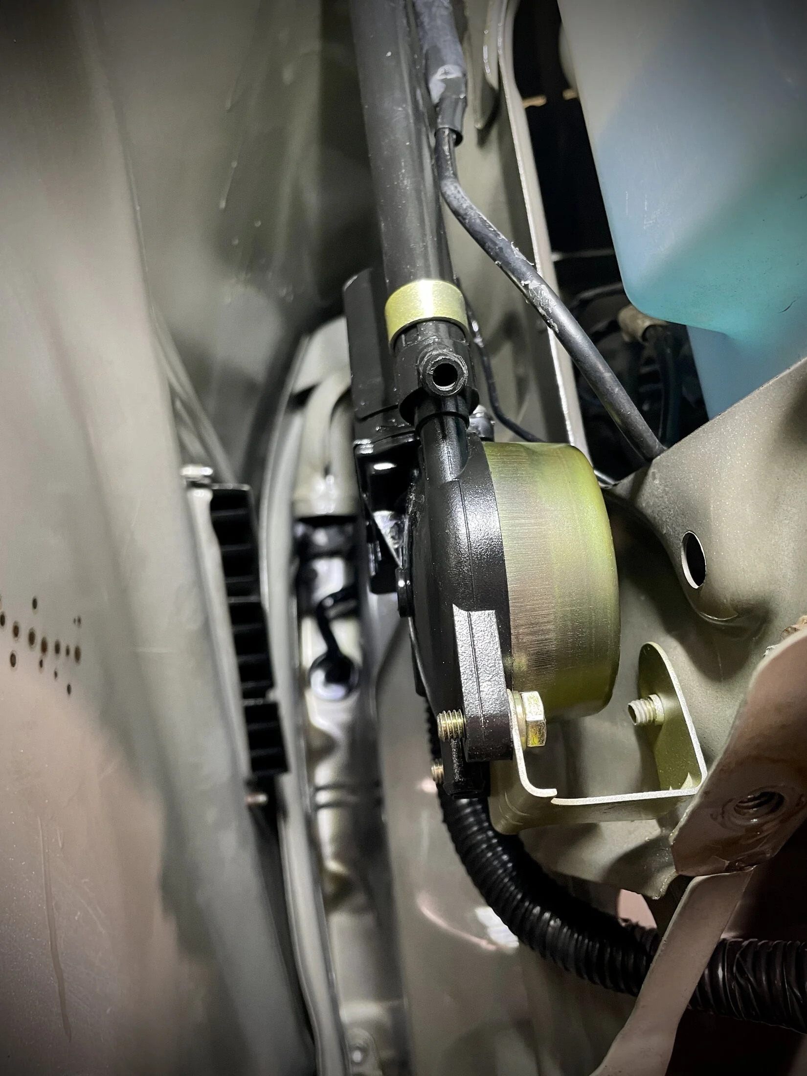

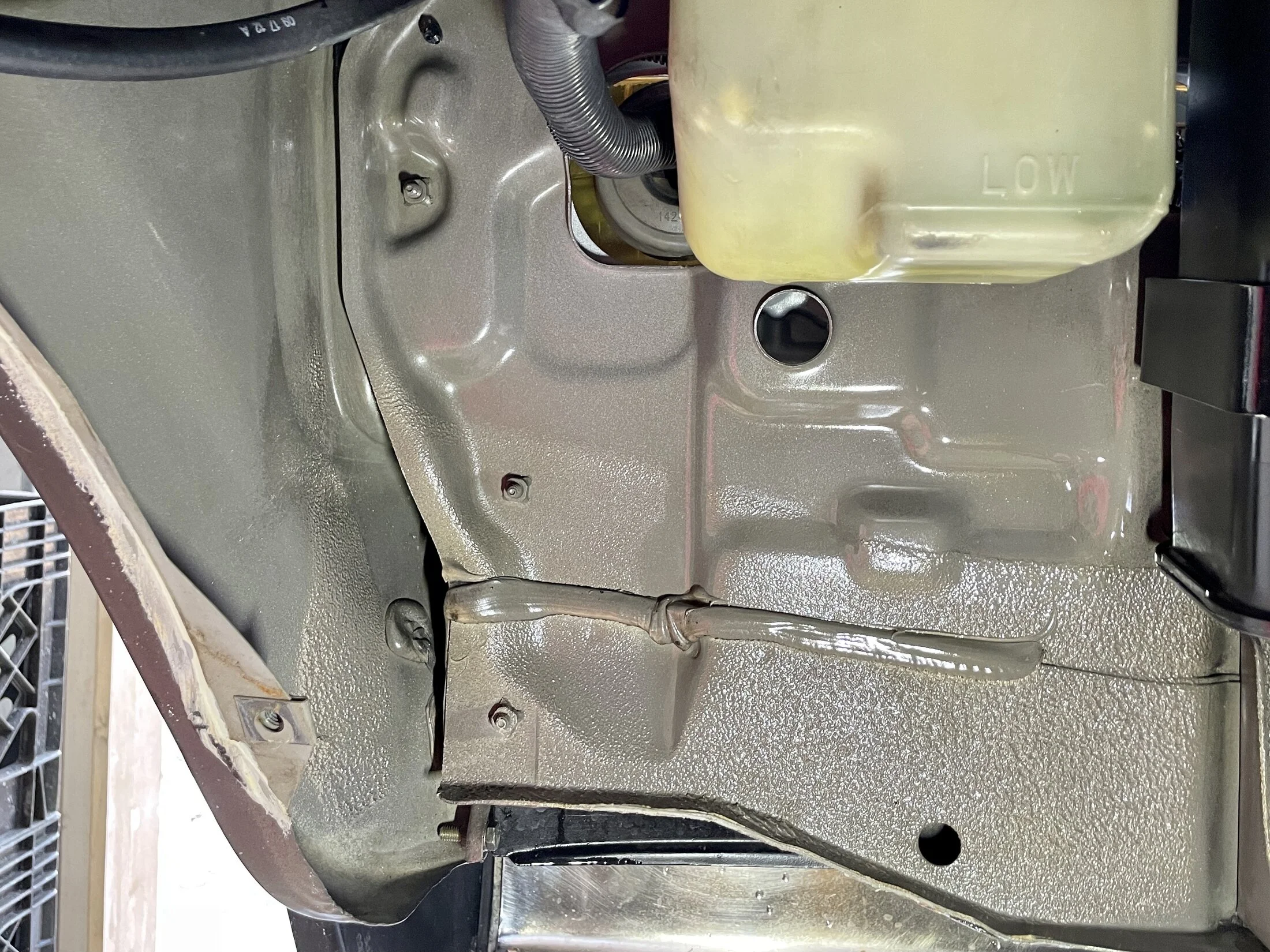

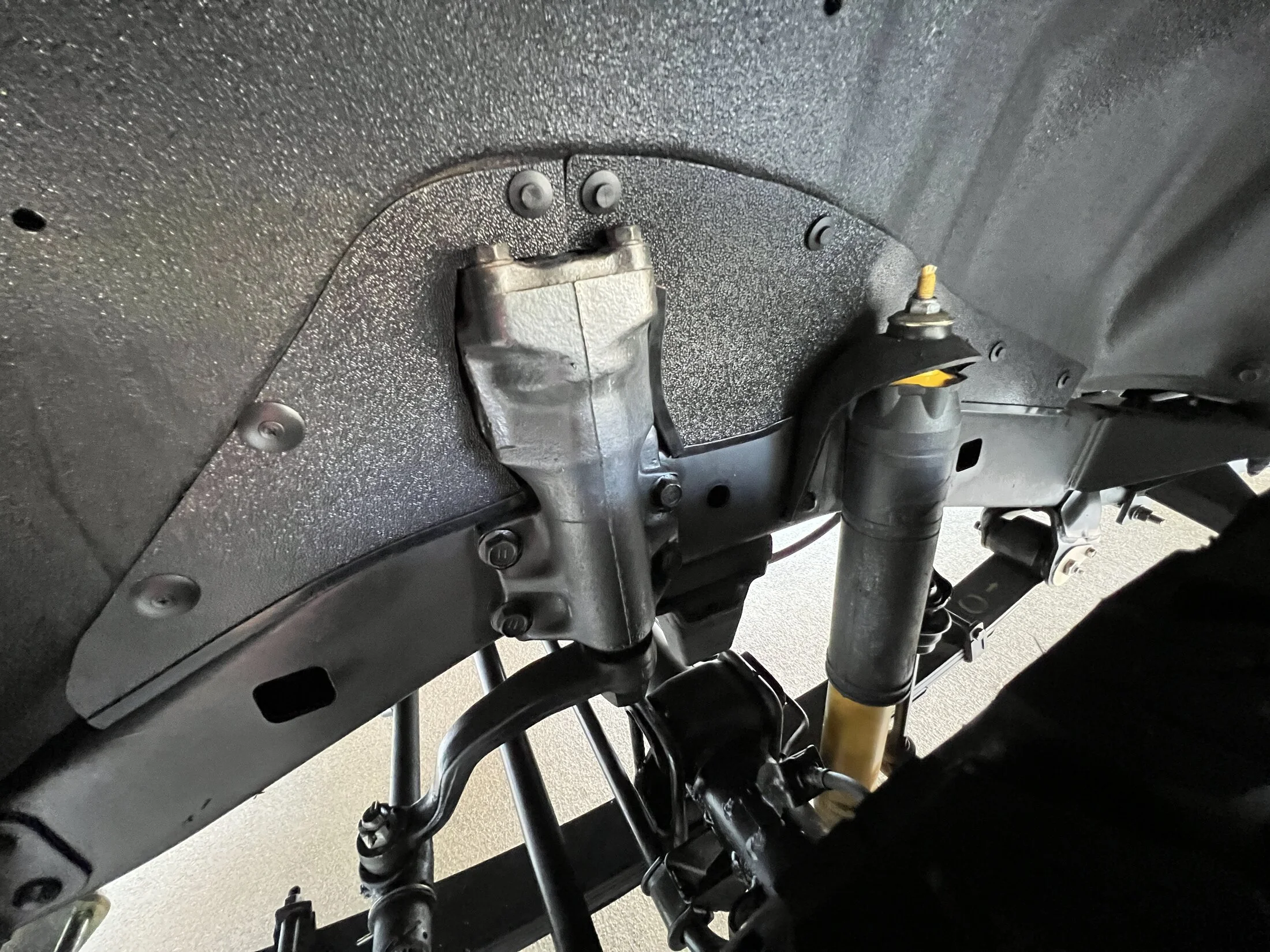

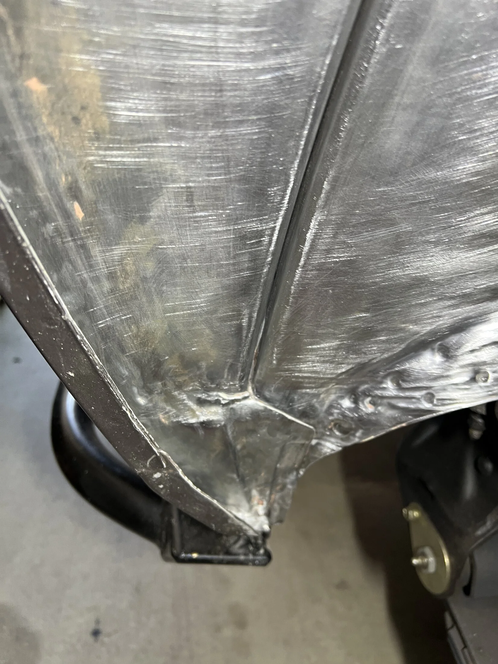

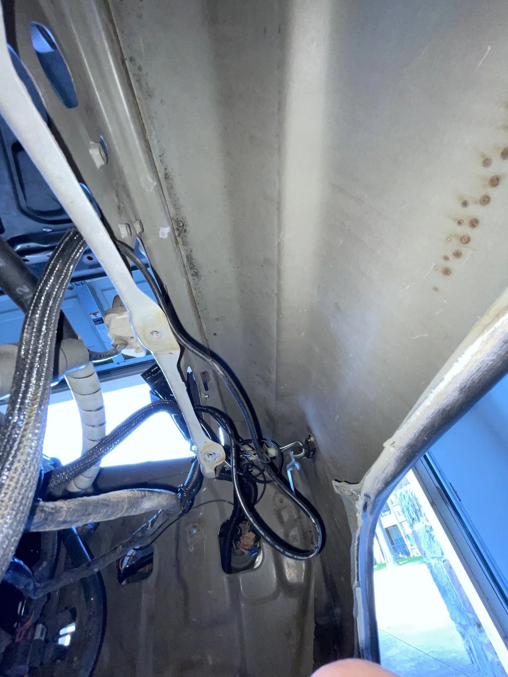

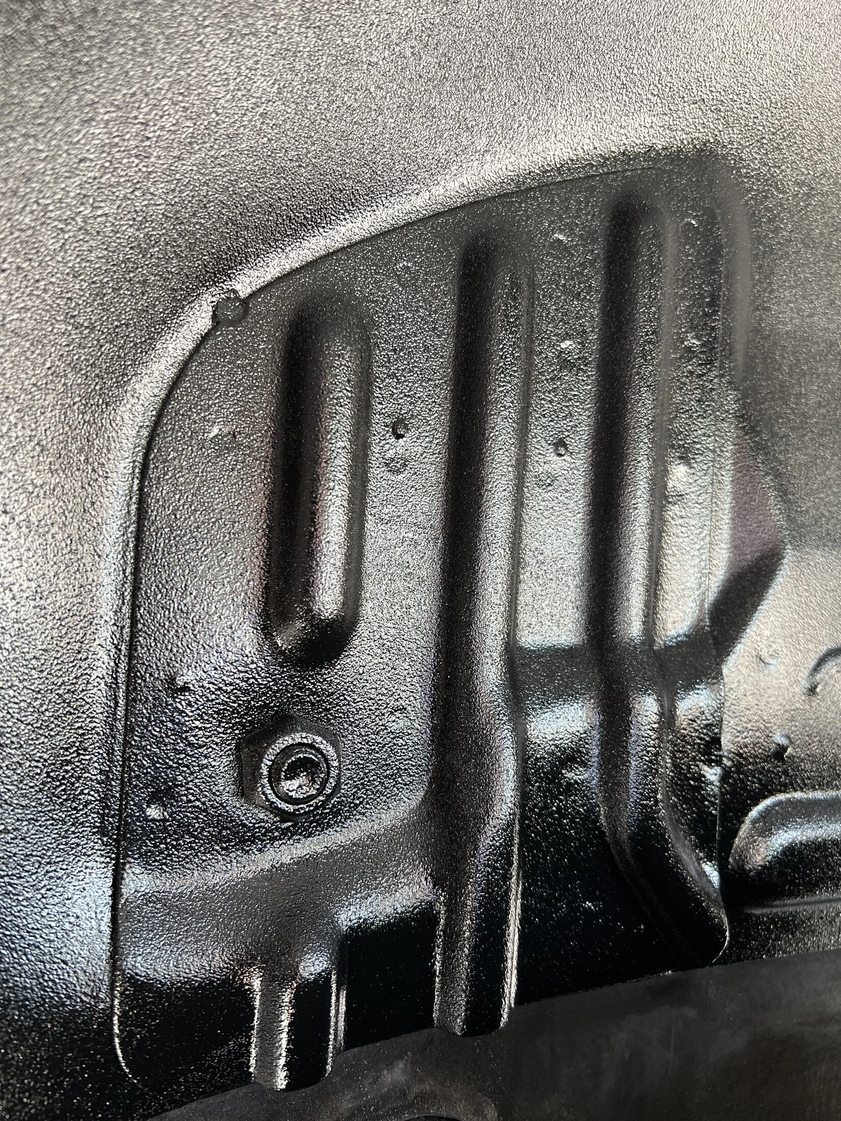

The front was easier when remove. I had the usual corrosion from battery and radiator. Weiler die grinder heads at full rpm worked good. The key was getting them on the bench. The front can be removed in 30 minutes a side, cut the seal, just lay down from Evercoat 2k. I’ll post after pics. Went on with Rhinoline up front. Was worth it. While opened fixed the wiring mess from PO. While the wells were out light scuffed the inside of the fenders and clear coated. The green primer is Marine Zinc Coat. Below waterline for corrosion. Then Rhino top
Really nice! Thanks for the suggestions. I’ll have to try that method out
Wheel Wells FJ62
Finished the rear wells with 2 coats of epoxy on texture coat. 2k base primer, black texture coating top, 2k clear. SprayMax offers color match in a aerosol can

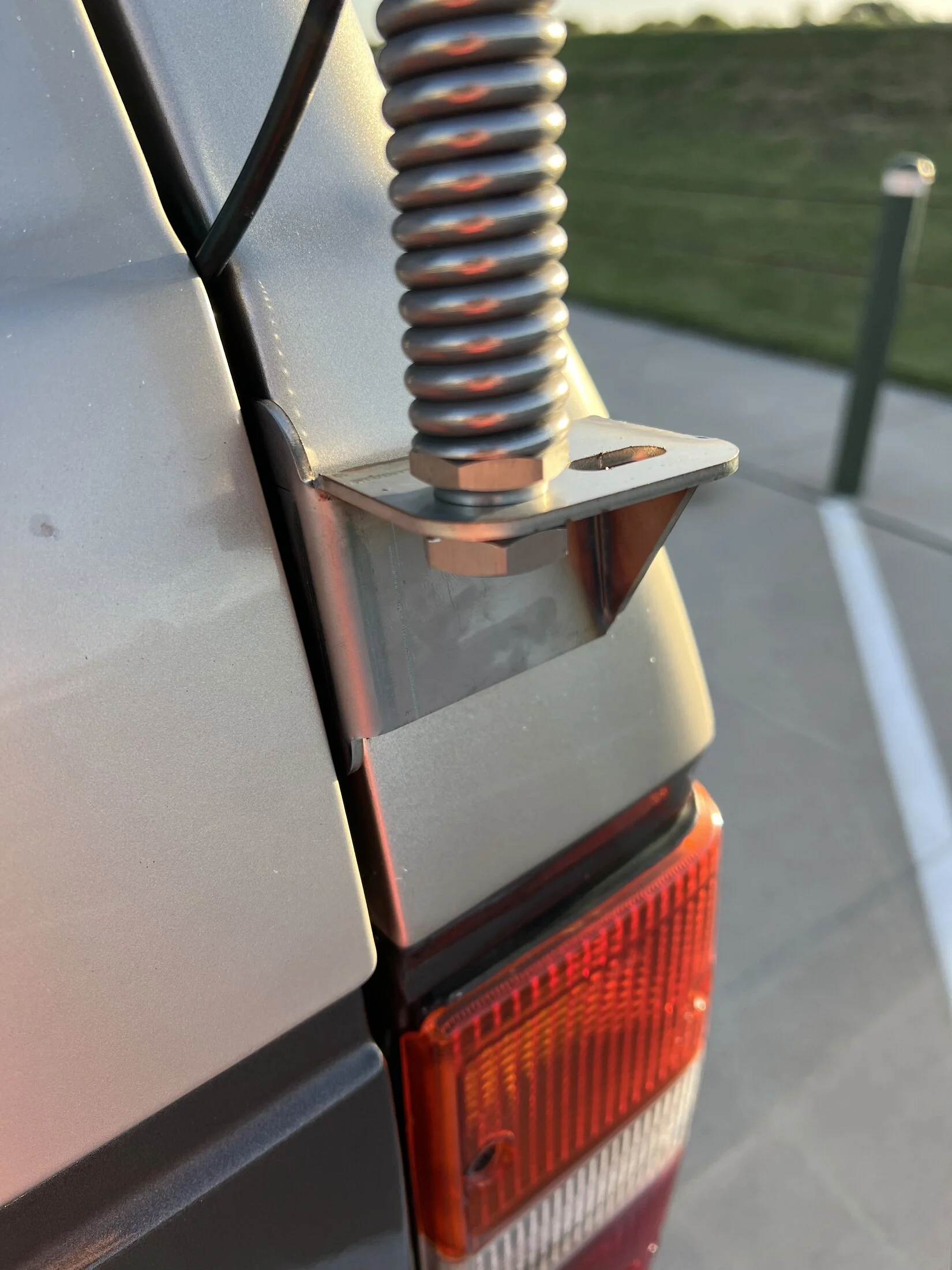

Antenna FJ60/62

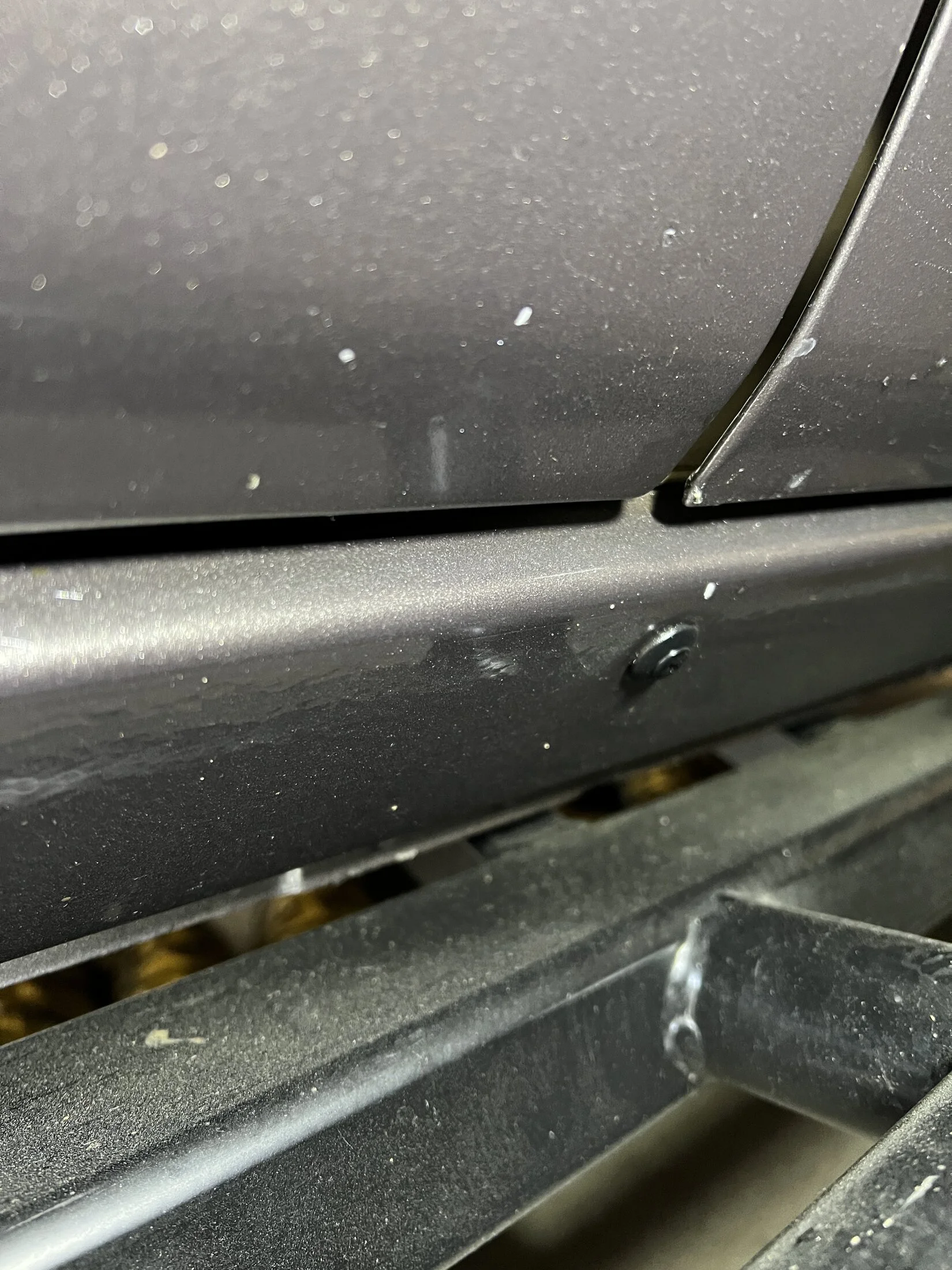

Got my Trail Tailer bracket put on for the antenna. Fits good, having to modify a gasket to be super thin for clearance. No biggie. I picked up a roll of Felpro gasket maker, maybe 1/32 and still too thick. After a few days to make sure no issues pulled off and 4-5 coats of black paint for rust prevention

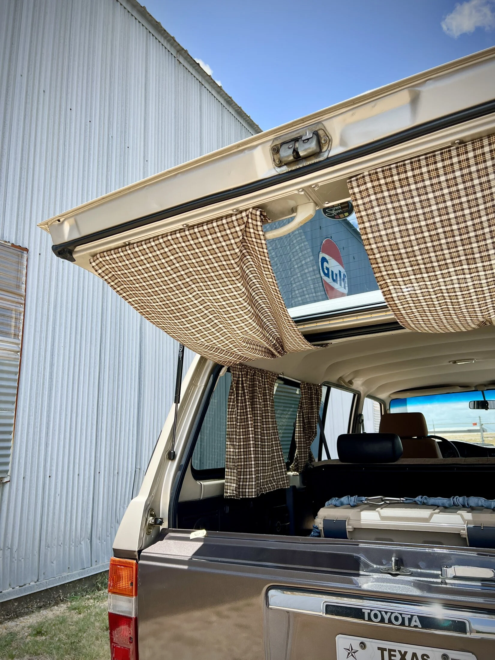

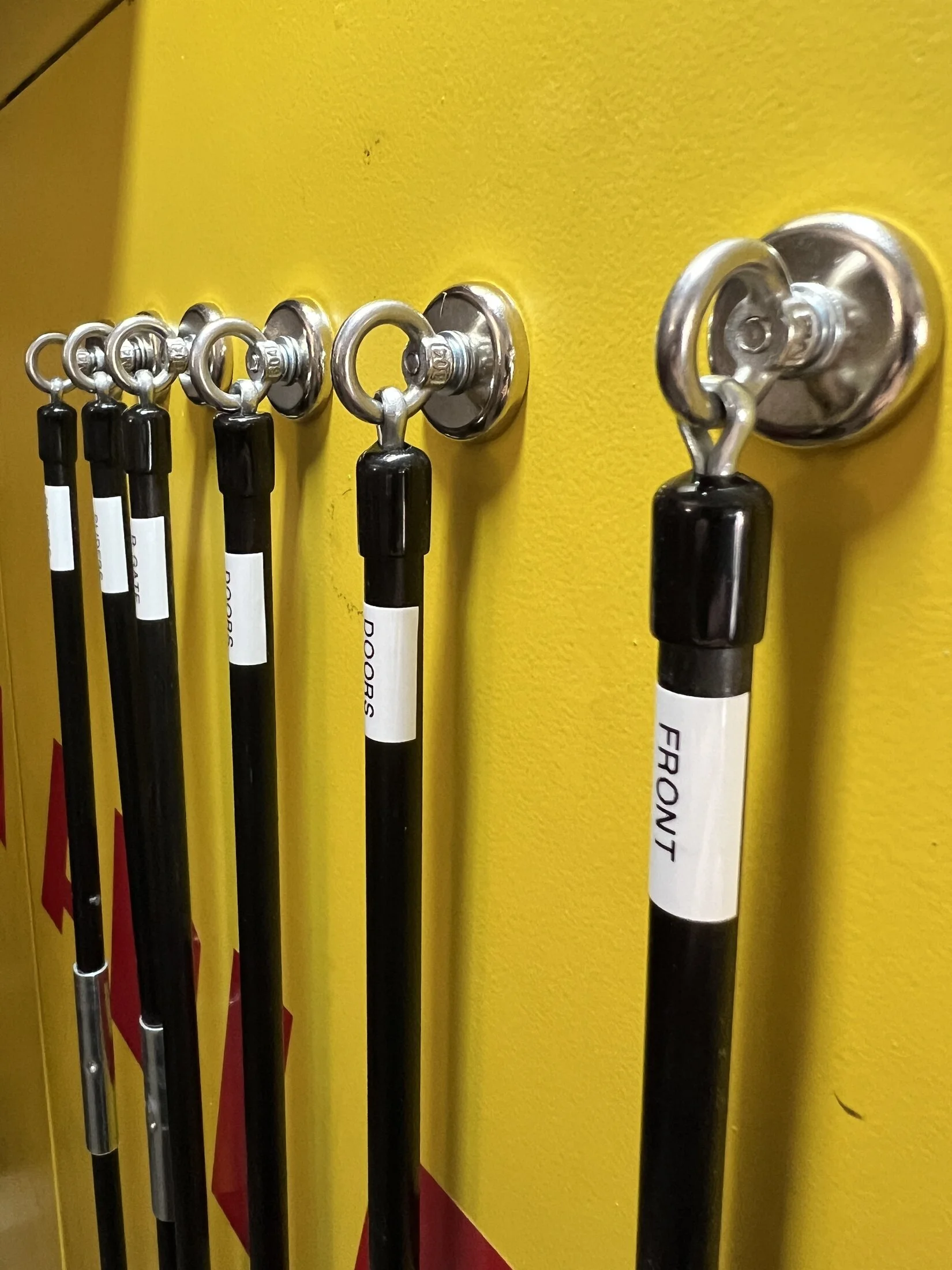

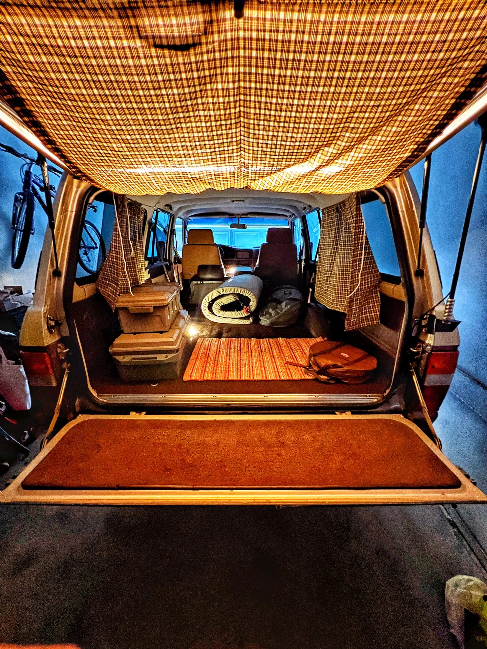

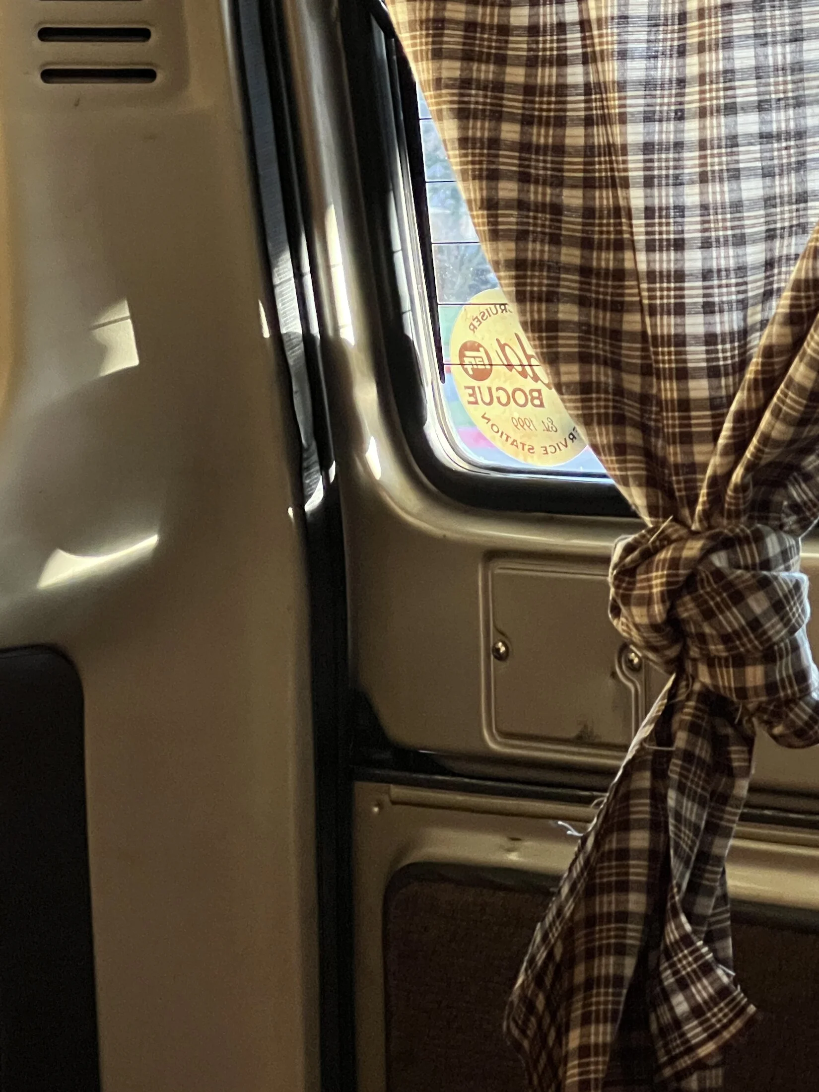

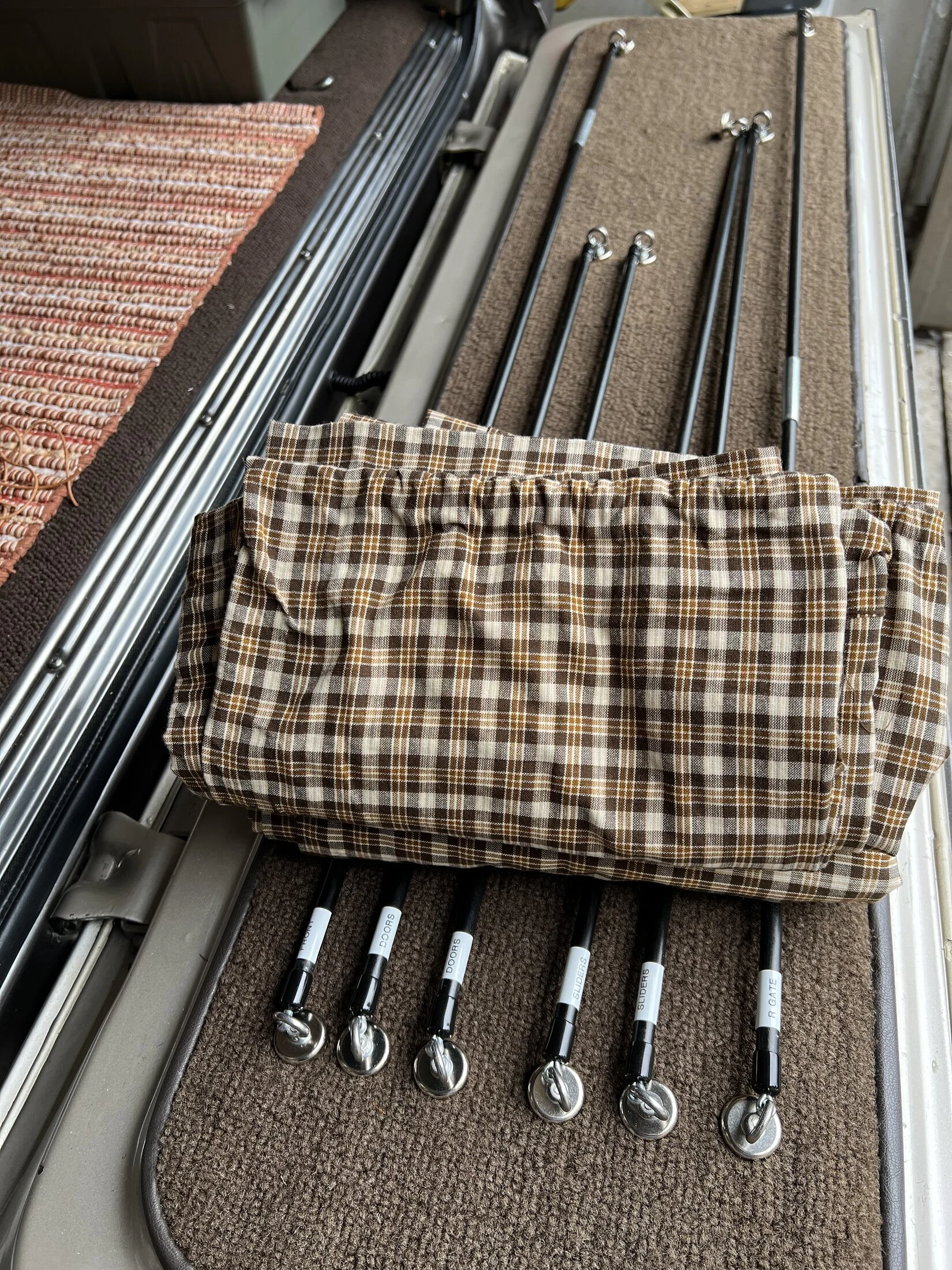

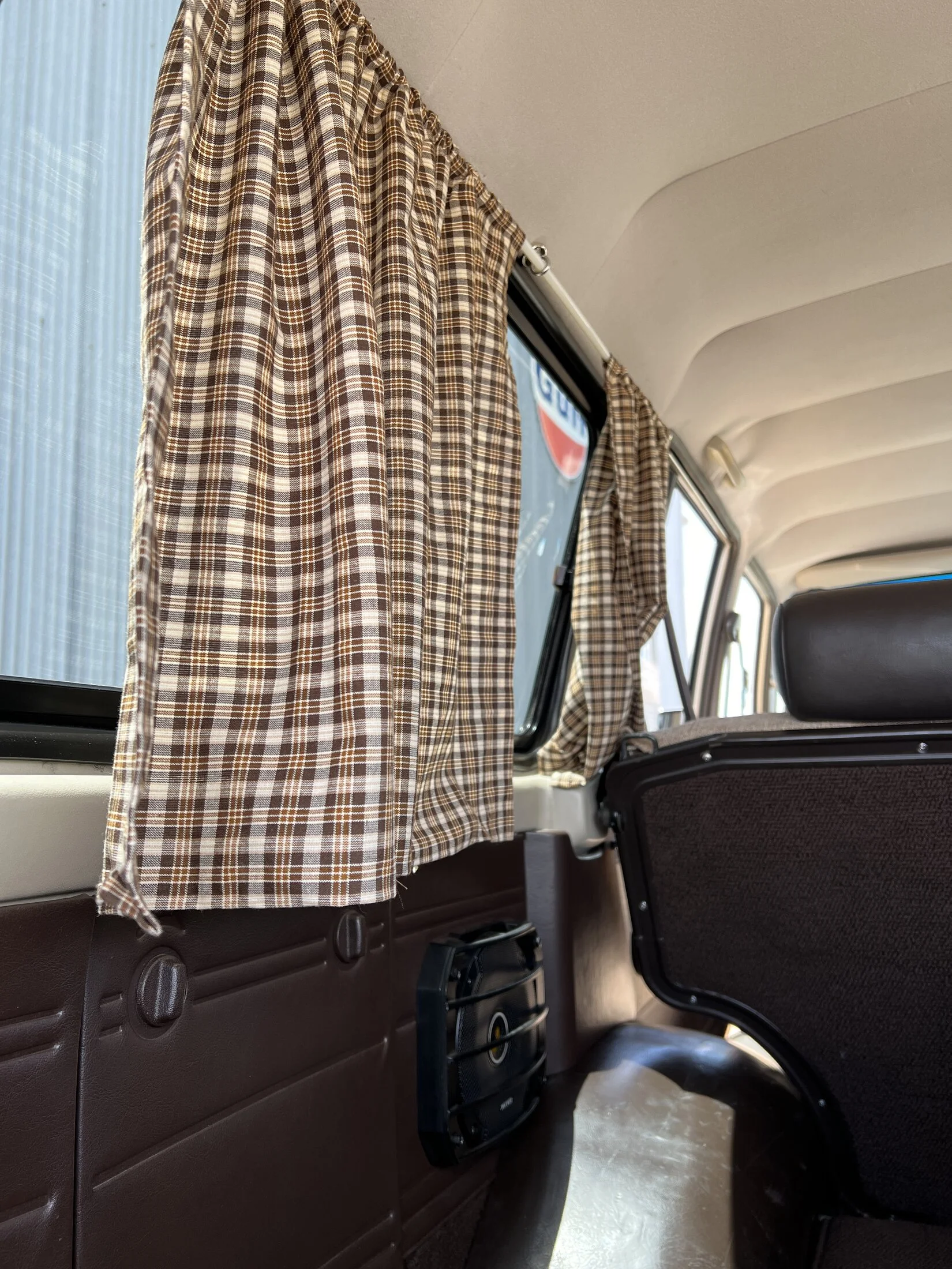

FJ62 Curtains

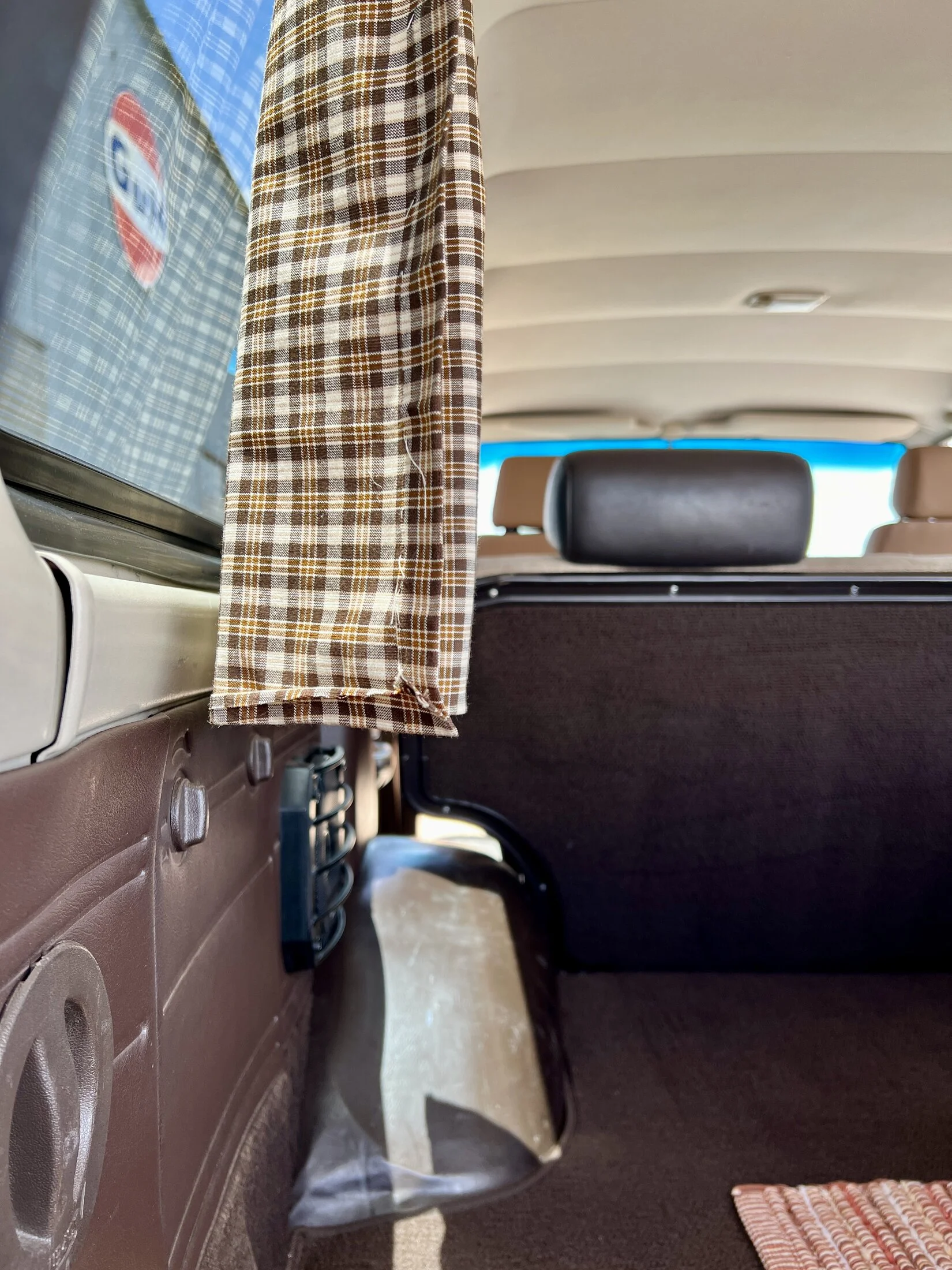

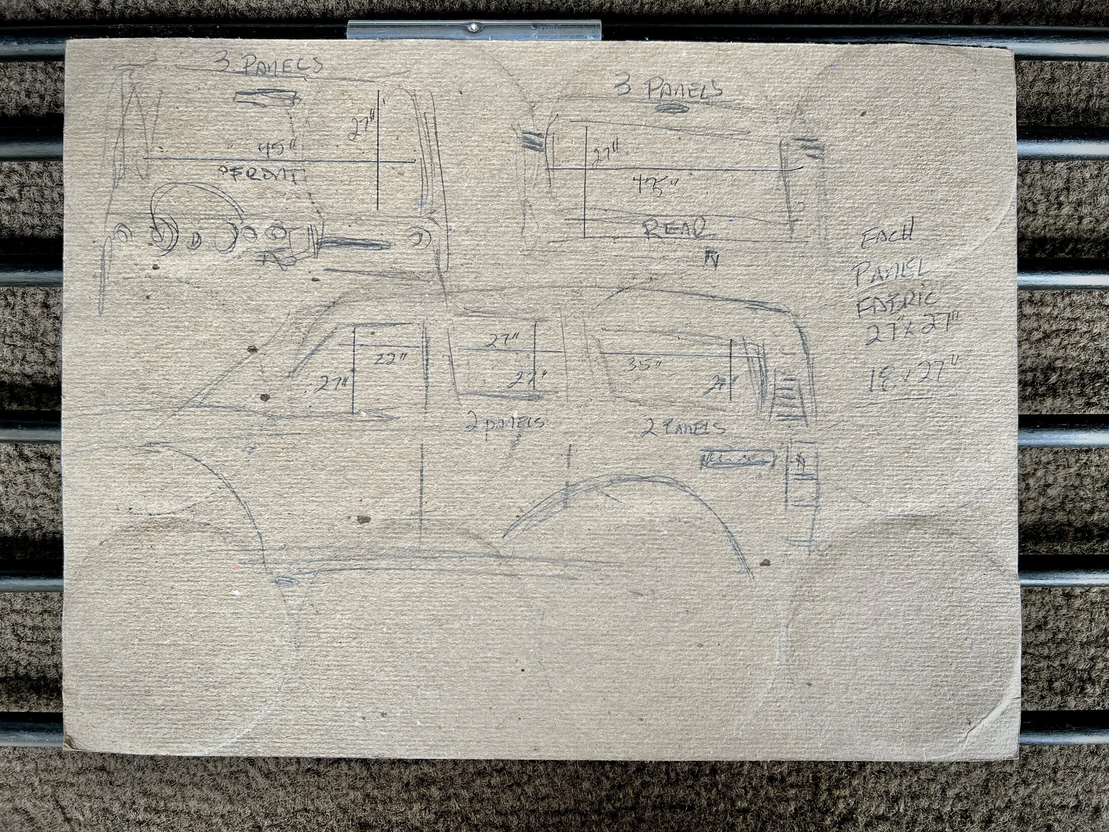

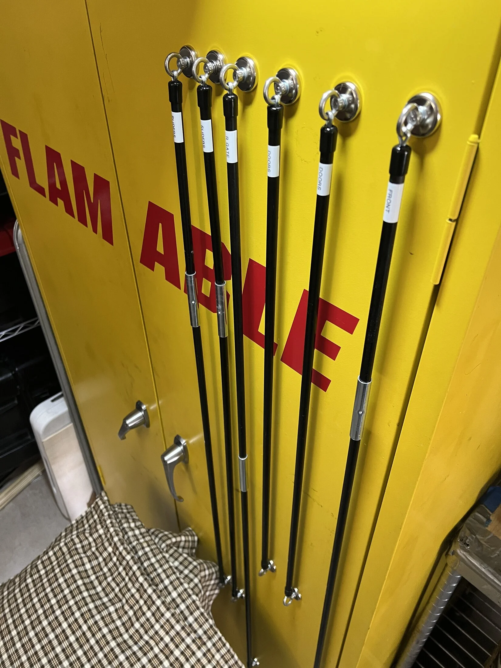

Finished up curtains for camping. Tent rods and the tips. 45lbs eyelet magnets and favorite plaid. Outdoor store has 4 rods $10 bucks. Fabric took 6 yards. Idea is easy to get parts that can be stuffed into stuff sacks in 5 minutes.
Edit: inserted cotter pins to eyelets that slide into the ends of the rods. Used the little black caps to close out the tips, that’ll help keep the rod from making any contact with my felt liner. Several of the pics are variations in the process

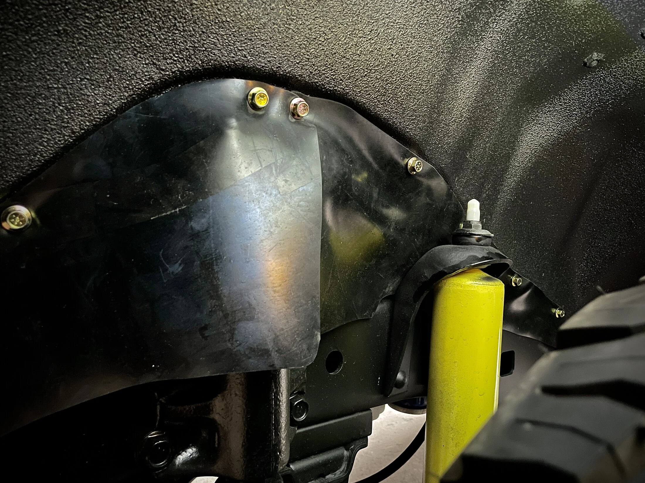

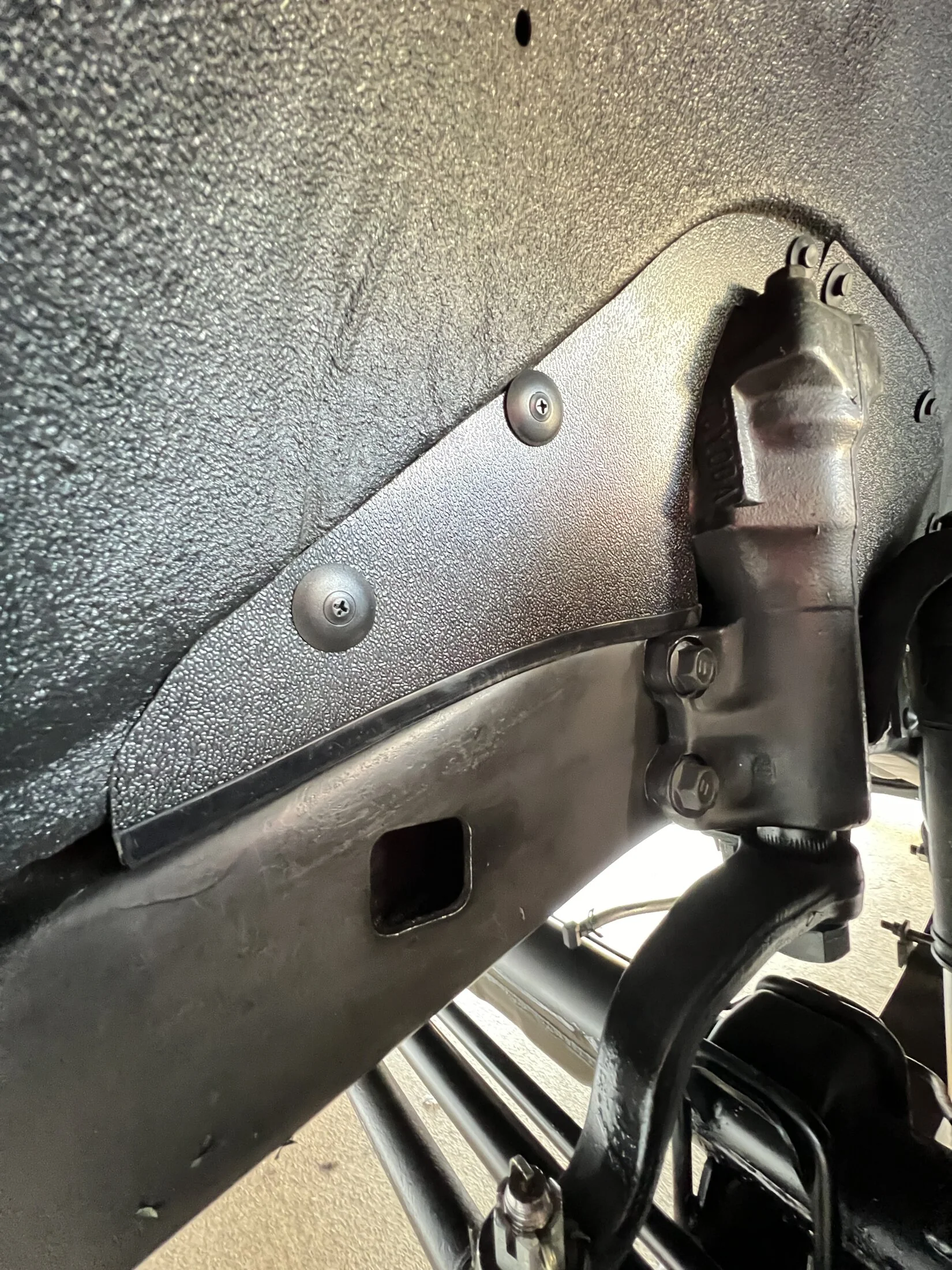

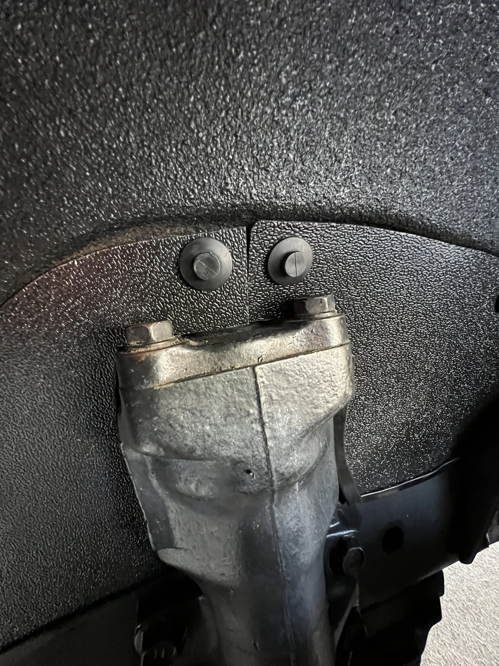

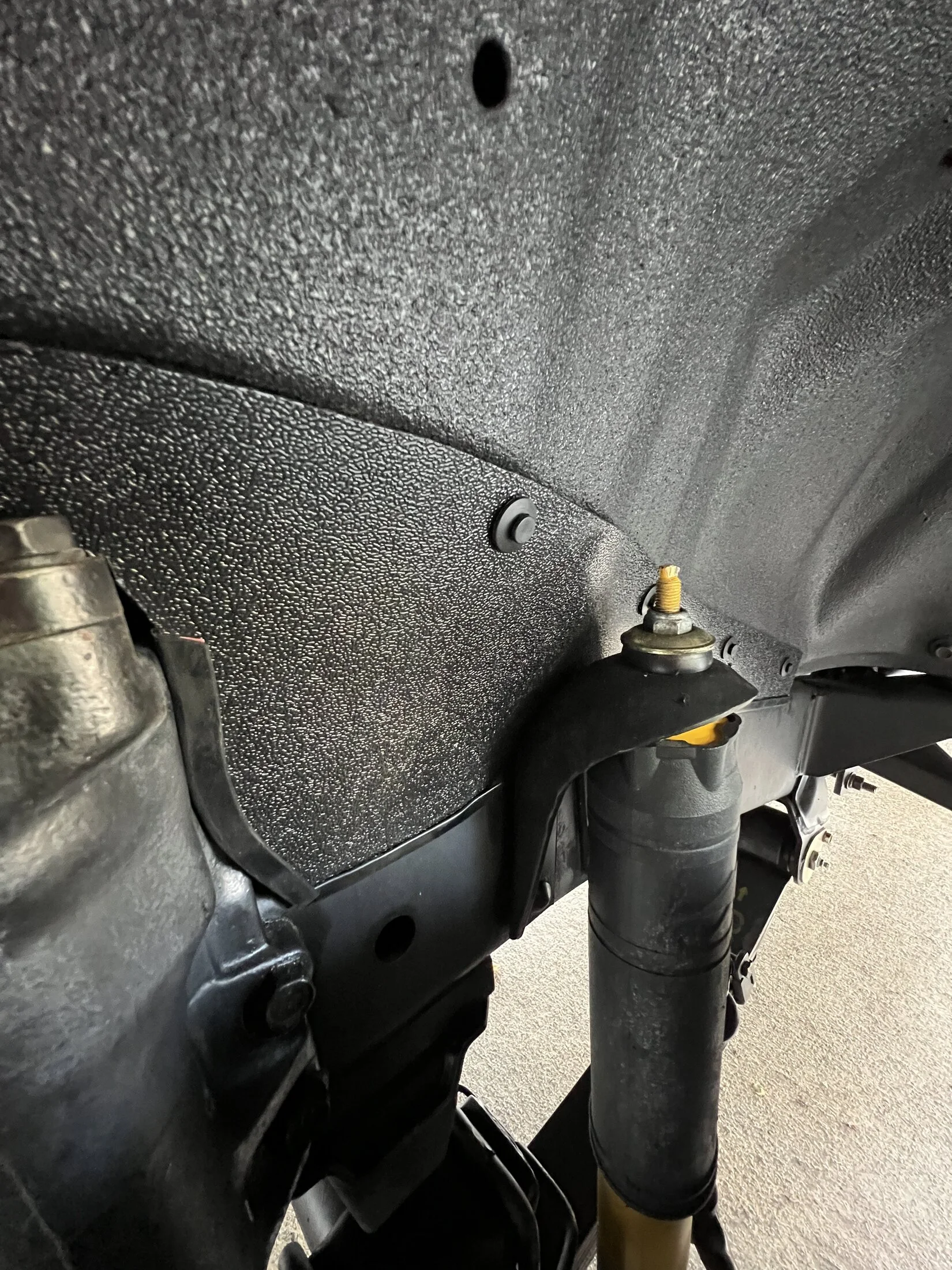

Brain storming lately more sturdy splash apron for front fenders. Some 1/16” black plastic sheets and some patience. Replacing the rubber is easy with scissors but a rigid piece has to be damn close. I’m happy with them. I’ve got some fine tuning to do and got some permanent fasteners to replace these.
Good idea looks sharp. I've put the other ones on my 60 and haven't had good luck. On the steering box side one of the holes has already torn out. Its a bummer.
