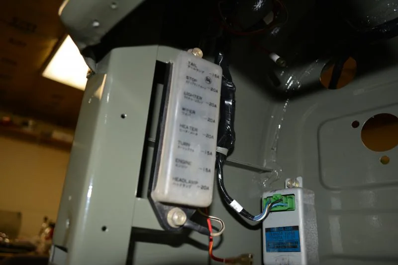

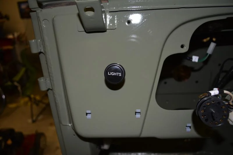

Coolerman rebuilt my front harness and built me a total new rear harness. He does amazing work. Thank you Coolerman!
I just ordered all new led bulbs for the gauge cluster and interior lights. As soon as they get here I will have the cluster in and onto the rest of the dash.

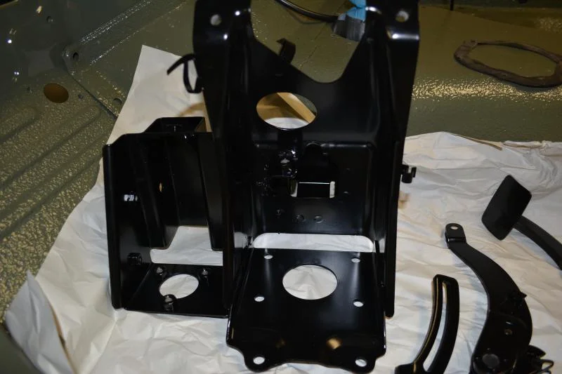

Looking to get my brake booster and clutch slave, brake pedal and clutch pedals all bolted up. Also finished the gauge cluster today with new LEDs so it will be going in too.

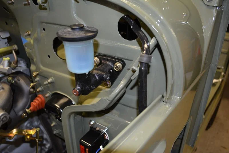

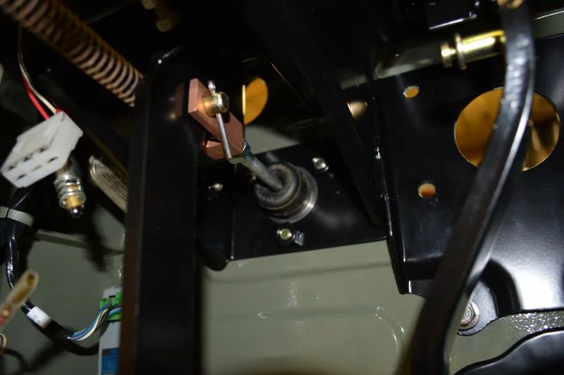

Today I installed the brake and clutch assembly and the clutch master. I also got the ebrake bracket installed.
My only snag now is that I took a part my ebrake to have it powder coated and for the life of me didn't take any photos. I also cant find the bag of parts I normally make when I disassemble something. So I quit for the night.
Ordered a new grommet and bushing for my accelerator linkage. So hopefully that will be assembled next week. Oh and I got a EGR pipe gasket.

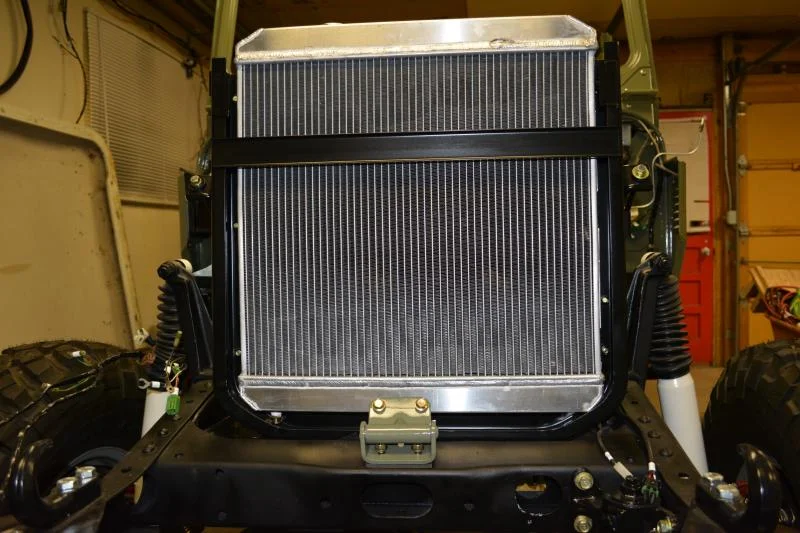

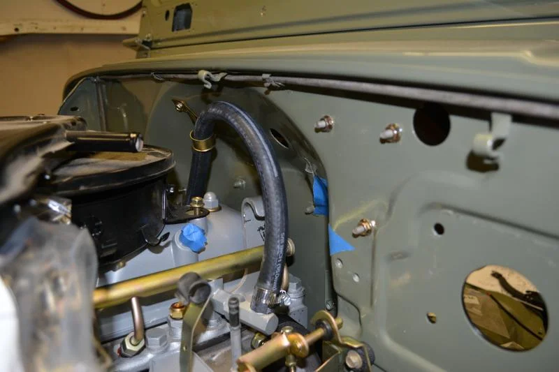

So thanks for everyones help last week. I ordered a new grommet for the accelerator linkage and a new bushing. It now is installed. I also put in a new aluminum radiator (3 core Champion) and new hoses. I also installed the hot water inlet valve and ran new hose on that as well.

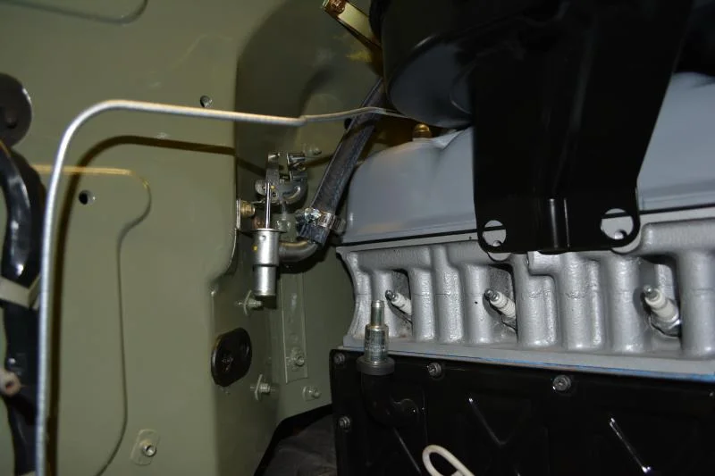

Today I picked up my EGR gasket and some ferrel's for my fuel lines. Next up is running the fuel lines from the fuel pump to the carb and then I will install the brake lines to the firewall and the clutch master lines.
Also from Toyota I have a new gas tank to install and I still need to bend up the two fuel lines that run from the tank to the fuel pump/charcoal canister.
