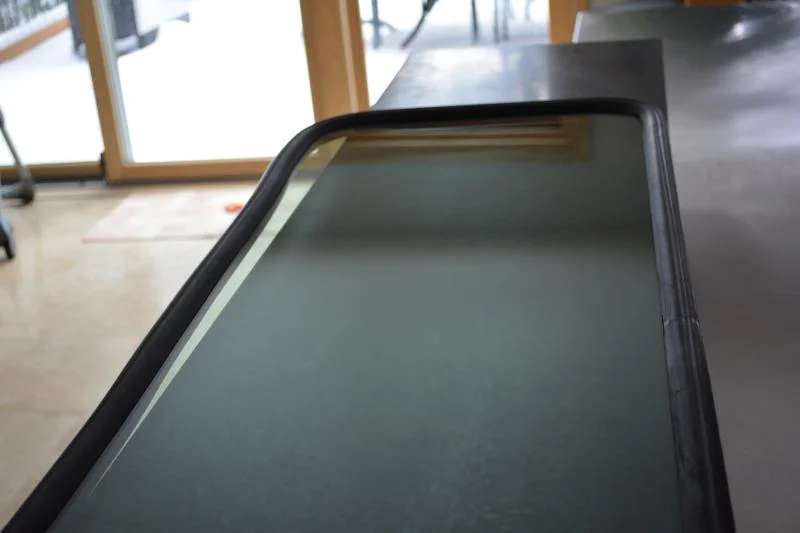

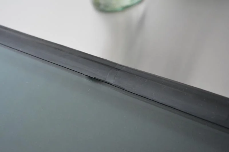

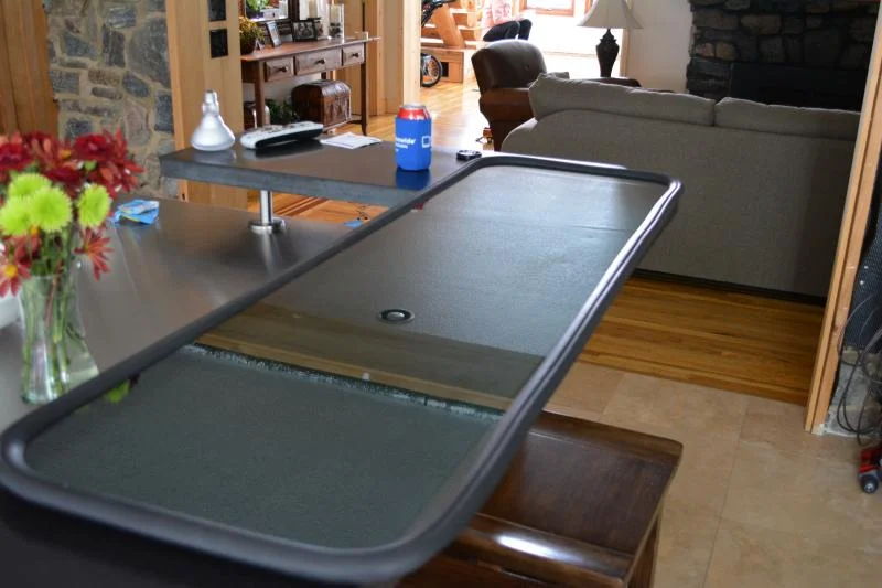

New Windshield...so I took my slightly scratched but still not bad old windshield into Denver yesterday and had a new one made for $90. I might have to post this as it's own thread as I want some opinions on if I need to remove the gasket and re-install it again. I know the seam is suppose to be in the center bottom of the glass. Mine started out that way but by the time I got everything in its place it had moved 1" so it is slightly off center. Will this matter? My fingers are still sore and bruised from stretching and pulling it yesterday. It might just bug me enough being off I will have to mess with it again. Anyway...maybe I can get this thing put in tomorrow.

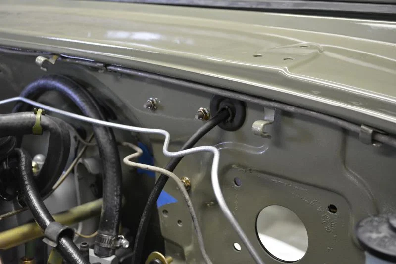

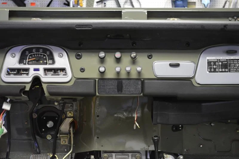

Shots of the speedo cable. Hope they help. I still will have to wiggle my brake lines behind the cable or unhook it from the transmission if I have to. But I think you will find it pretty easy to install. I would recommend NOT hooking it up to the transmission while you are messing with it. The cable is rigid enough that if will limit your movement. I did it the hard way.

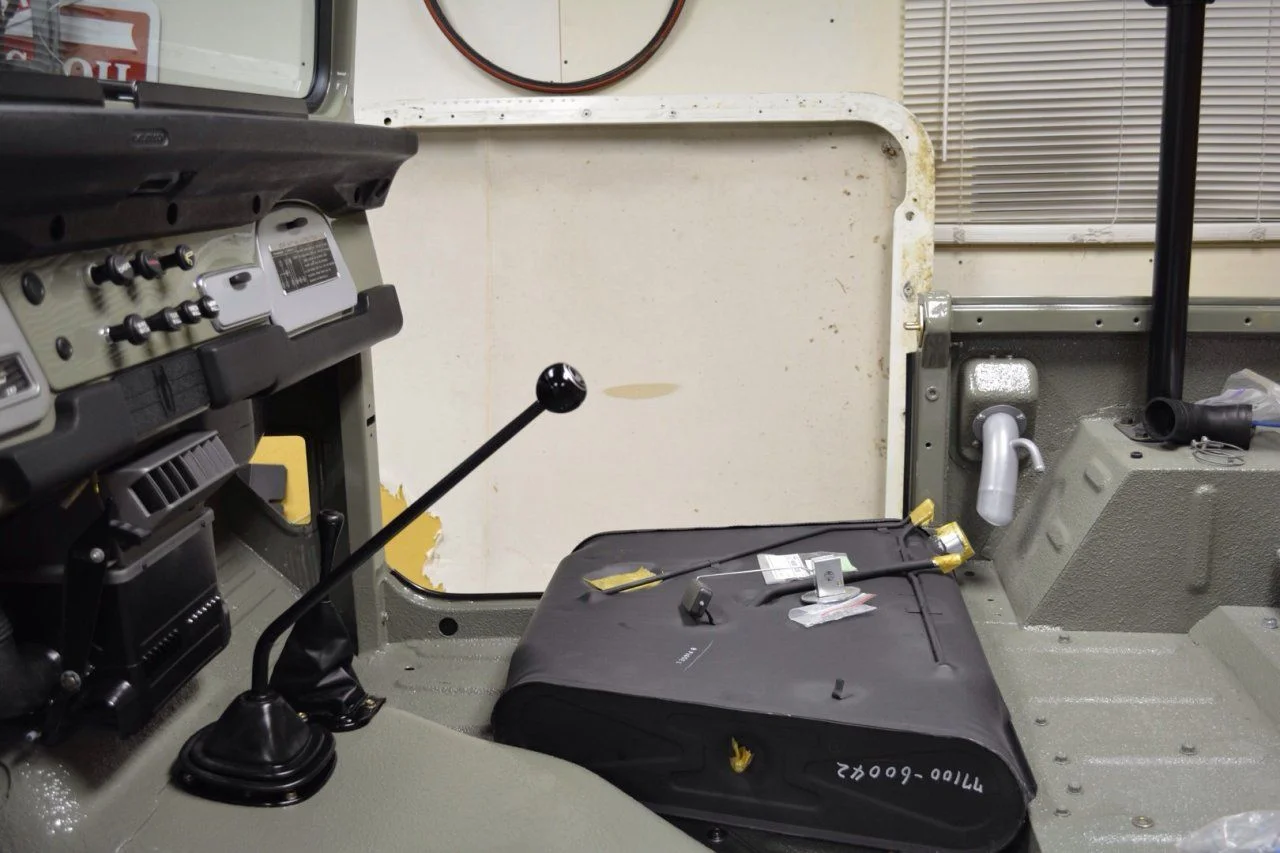

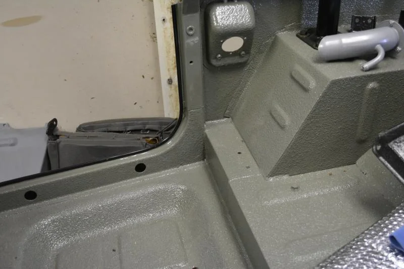

In the other photo is where I need your help. Below my fuel fill area is where a hole is suppose to be in the body for a metal tube to come up from below. I believe it hooks into the charcoal canister. I need to know about how big of hole to drill and where the hole come out under the body as it looks to go down through the support beam of the bed.
Once I drill that hole I can get ripping on the fuel tank and lines.
Thank you
Mark

Sarge just got done shoveling......again. I tell the wife if I'm not back in 45 minutes just call an ambulance ;) Mark I emailed you photos of that hole, a hard line does go up through there and run forward to the charcoal canister.

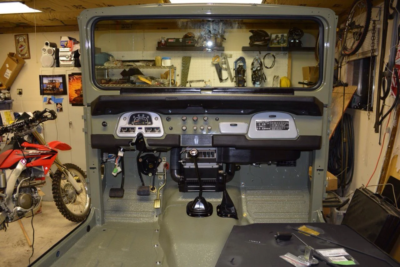

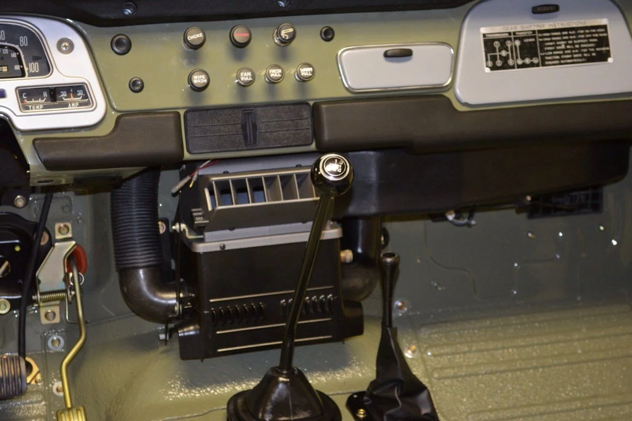

So it's time for another update. I have been long over due, but I have some good excuses. We brought home twin boys today so my life is getting more complicated every day. Since my last post in January I have installed a new windshield and gasket, my wiper linkage and wiper motor. I also installed my tranny hump with new gaskets, as well as my transmission shifter with new seals and shifter boots. I also installed my fill neck, gas fill door and assorted hardware. I installed my rear wire harness, front heater, defrost ducts and soon....gas tank, tank cover and hook up fuel lines. Then I need to attach the brake booster and install the e brake handle and button up the brake and clutch pedals.
