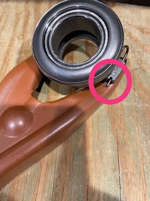

Are we supposed to bend the bottom of the retaining clips to fit in these grooves? I've looked for pics on here but haven't found any yet that show whether or not they are supposed to be bent. Moving this hub just by hand on the fork they seem to come out pretty easy.

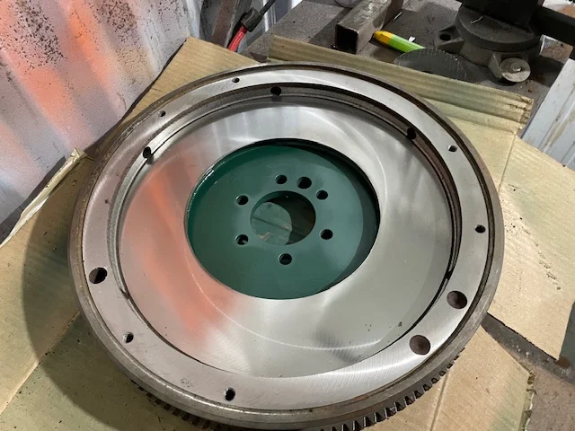

I haven't found any alignment marks for the pressure plate connecting to the flywheel. I have a brand new pressure plate and flywheel as been machined. So can I just slap it on in whatever position?

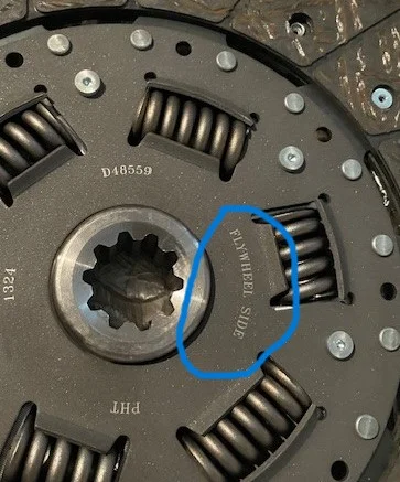

Does anyone have any advice about this? The MFG put the flywheel label on the wrong side I believe. Coolerman's site says the protruding part faces the flywheel. I agree with him as the shape fits into the gap on the bore of the crankshaft.

Ask many many people (including me 30-40 years ago who did it wrong!
Thanks for the advice. Will try to post pics when it's done. Also was able to get the springs to bend at the end to fit in that groove. It was bothersome seeing how easily they slipped out.
