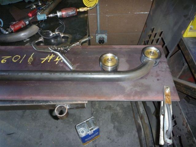

Starting to mock up the rear 4-link. Trying to set the lowers outside the frame and the uppers inside. Gotta nice bend to at ride height it'll be just about parallel with the ground. Once we get the uppers in we'll see how it cycles. Should clear the frame. Running a 60 series Full Floater.......stay tuned.
Single triangulated 4-link in the back? Running a panhard?
Why the bend in the lower, for rock clearance?
