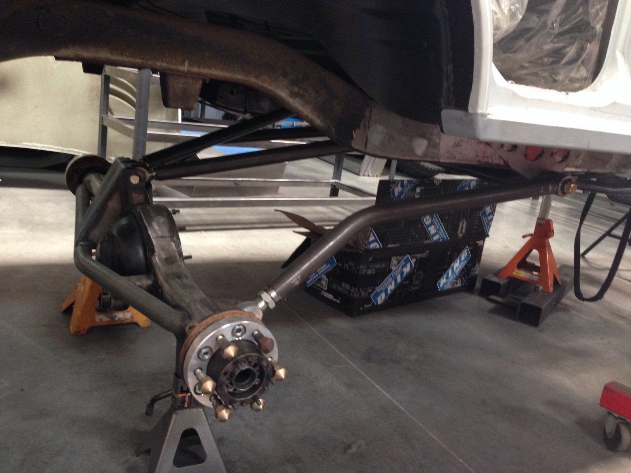

Front tires fit also......checking for clearance for steering arms.....Full bump front and back...
Rear Cantilever idea is coming together. On paper it looks like around 16"-18" of travel using a 10" Coil-over.
My rear cross-member was pretty bad, so I'll incorporate a new one into the rear shock mount....going to be fun doing this crazy sh**...

Wow, didnt really know anything about the Rear Cantilever setups. Super impressive like Delancy said. Really interested to see how this comes together. What type of shock are you planning on using?
