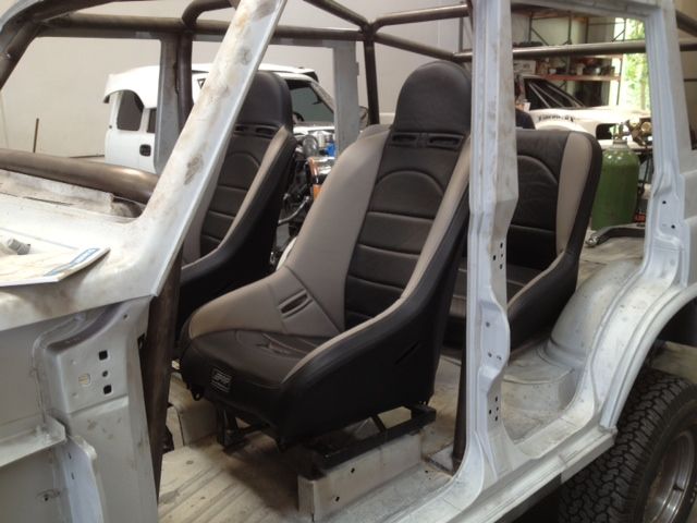

Seats are in......
Got my PRP seats.....they're really comfortable. We're going to make a new bracket in the front instead of using the Corbeau bracket that's make for the FJ55( I'll be selling this one if anyone's interested). And need to make one for the back that has quick release if I want it out. Now they can finish the cage and get that checked off the list......

Put me down for the seat bracket. I'm going with the Corbeau Sport seats. We'll have to check if your bracket will work on those seats.

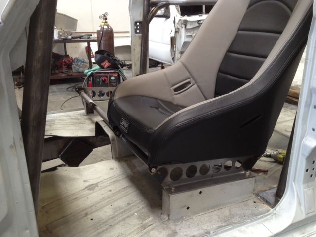

Seat Mount
Got the new Seat Mounts almost done. Look pretty trick. We might make a few and try to sell them on MUD to other PIG owners. Can be made to fit any seat and we can put sliders on to adjust the seats up and back. Got the Tuffy mocked up also. It's gonna work good.

Man, you did a good job on that. It looks like race car.
I was thinking about the steering wheel height and how it affects the seat height. Did you do some fitment with the wheel or just address that later, with the column position.
