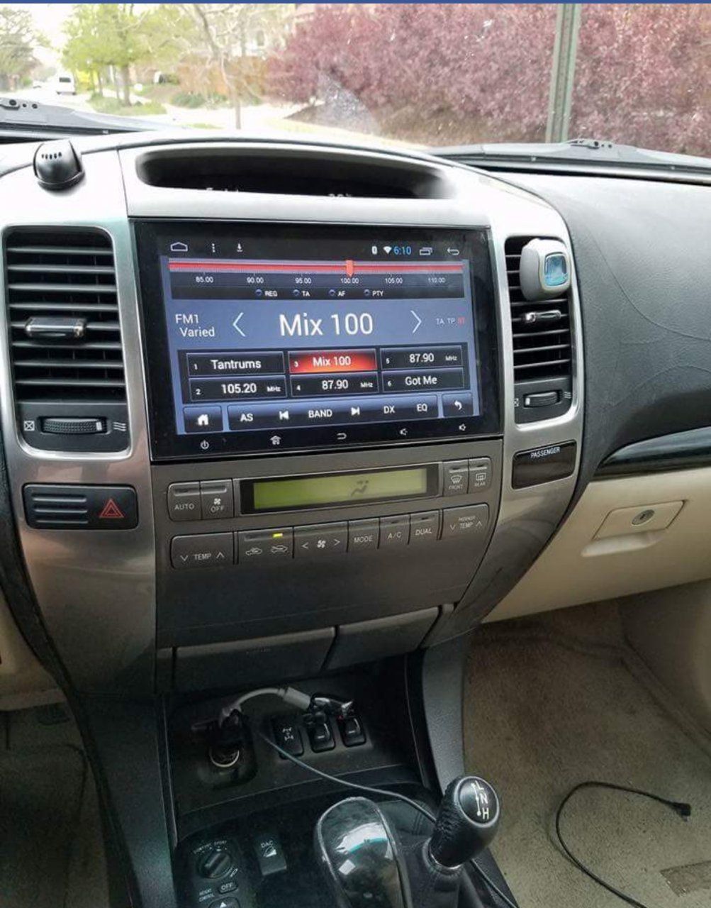

last picture is a non nav
How did they get such a huge screen in that last photo? It doesn't need any trim around the display! I hate that none of the trims offered are painted to match the brownish silver of the stock console. I bought the cheap surround off of Amazon and have been looking for some spray paint that is close so I can try to match closely to stock.
took mine to paint shop in Phoenix and he painted it for $40, looks close
if you have hobby stores or model toy stores, you might try them
