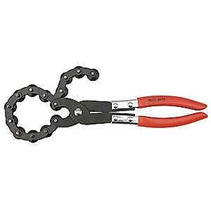

You could also cut it with one of those pipe-cutter thingys if there is enough room for the tool to roll around the pipe.
