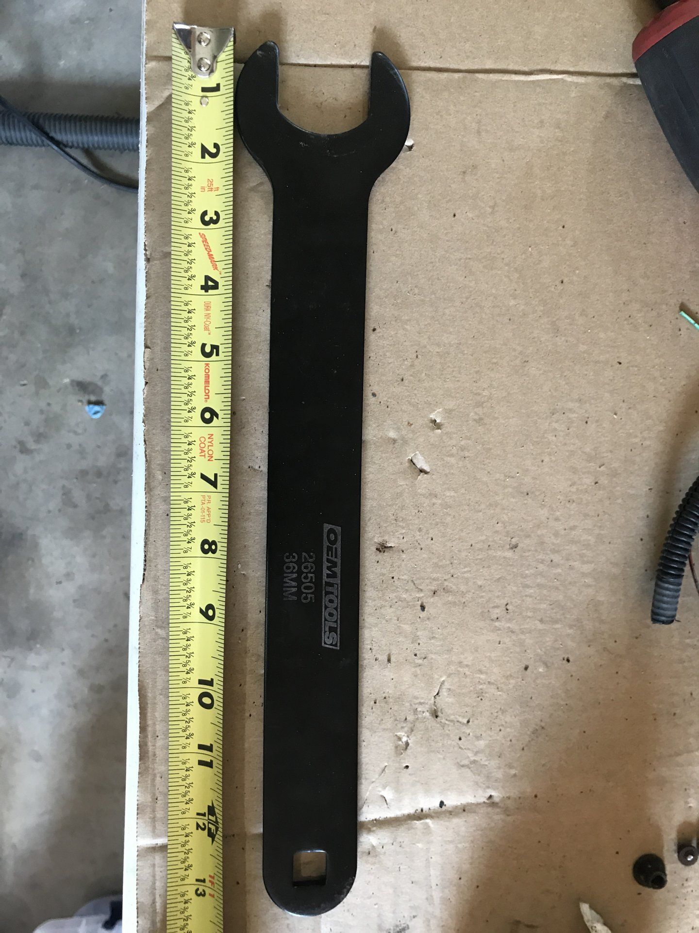

Went yesterday to harvest 4 globes. Unfortunately what was there Thursday was gone Saturday. I did stop at Auto Zone on the off chance they might have some sort of wrench to aid in Globe removal. So while I missed out on globes I did score a b👁tchin’ wrench. The smaller head is a 36mm, wrench is 4.2mm thick. $25
Hammer and chisel is a great inexpensive way to get globes off.
