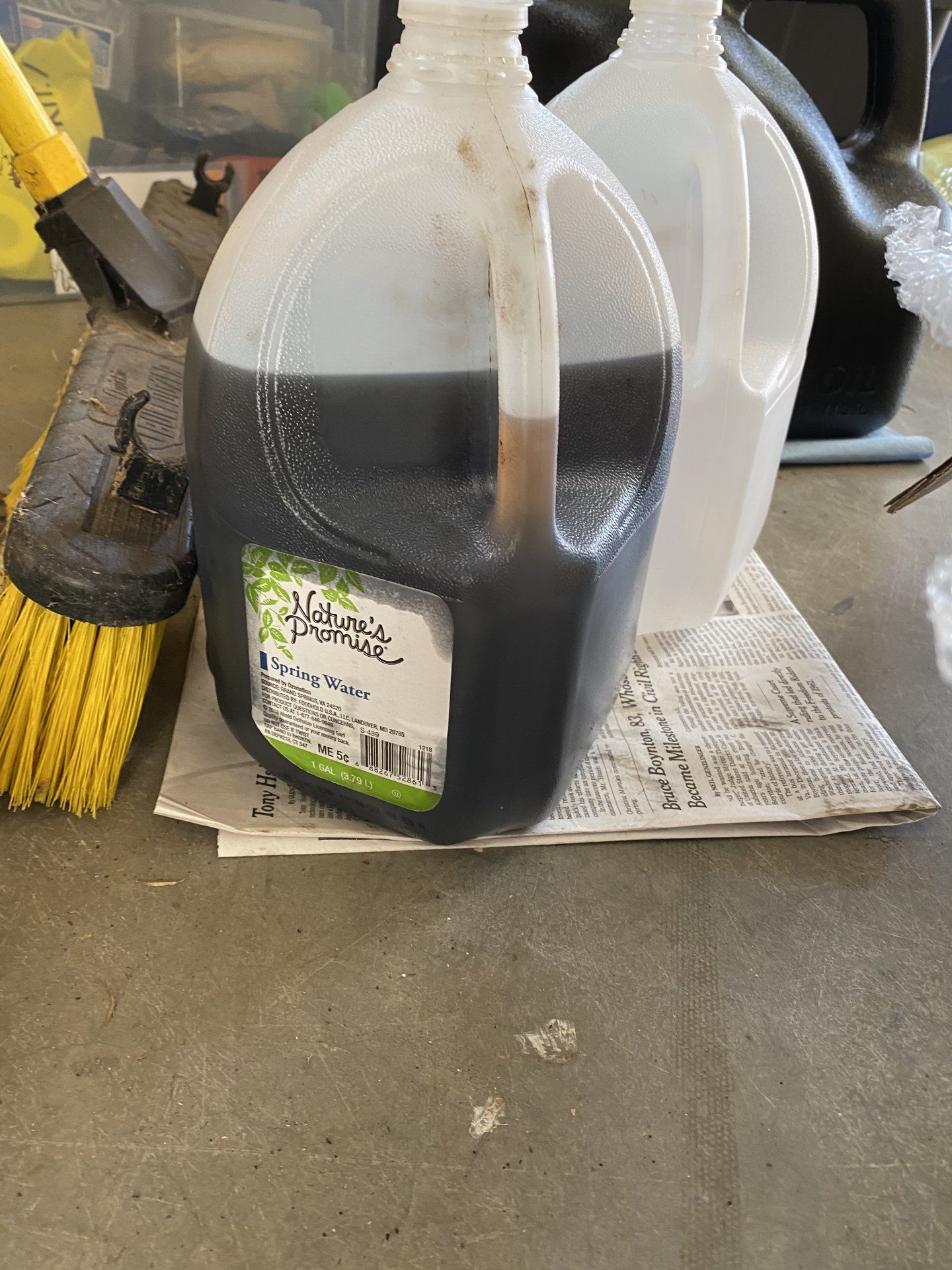

I did the @PADDO thing and put under three liters in. Everything was pure and pink on the final bleed. Here’s what came out/was replaced:
I bled all five after the new globes were on and it was very briefly (first couple of seconds) a little bubbly on all the corners, but not much.
