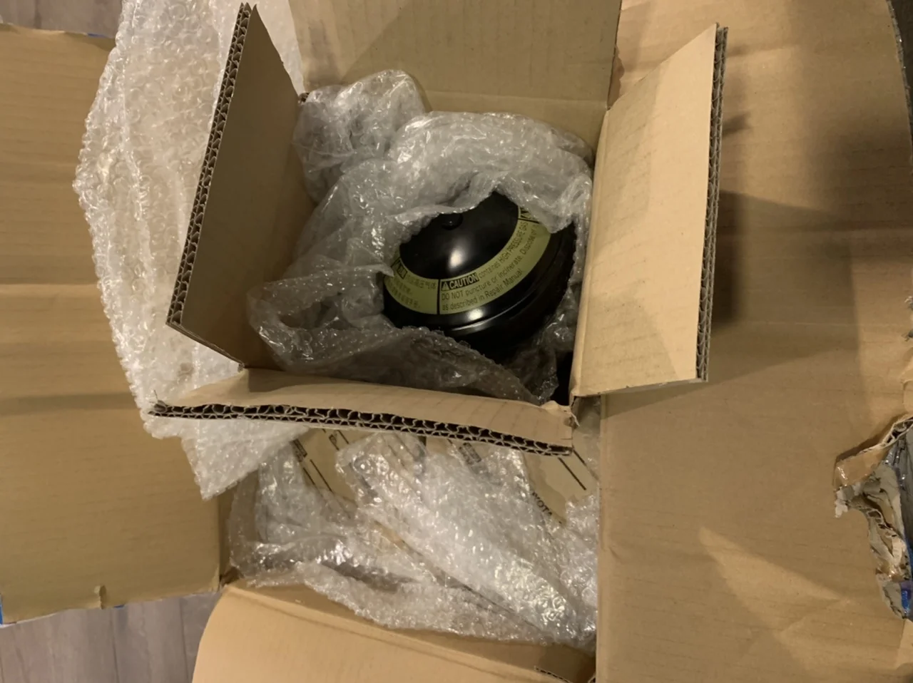

My globes arrived today. I placed the order on 6/9, so two weeks exactly from order to receiving. My total cost via Paypal turned out to be $708.37, which must include various fees from the credit card I used because the yen to dollar conversion doesn't match. There were three transactions. One for the globes, one for shipping and then an additional $1.90 in shipping. Tracking this transaction from the IMPEX website and via FedEx tracking was okay. The information was slow coming and a little late, but I did feel comfortable that the order was going through as planned. Now I'm waiting on the AHC fluid from McGeorge to arrive.
My globes arrived today. I placed the order on 6/9, so two weeks exactly from order to receiving. My total cost via Paypal turned out to be $708.37, which must include various fees from the credit card I used because the yen to dollar conversion doesn't match. There were three transactions. One for the globes, one for shipping and then an additional $1.90 in shipping. Tracking this transaction from the IMPEX website and via FedEx tracking was okay. The information was slow coming and a little late, but I did feel comfortable that the order was going through as planned. Now I'm waiting on the AHC fluid from McGeorge to arrive.View attachment 2712005
