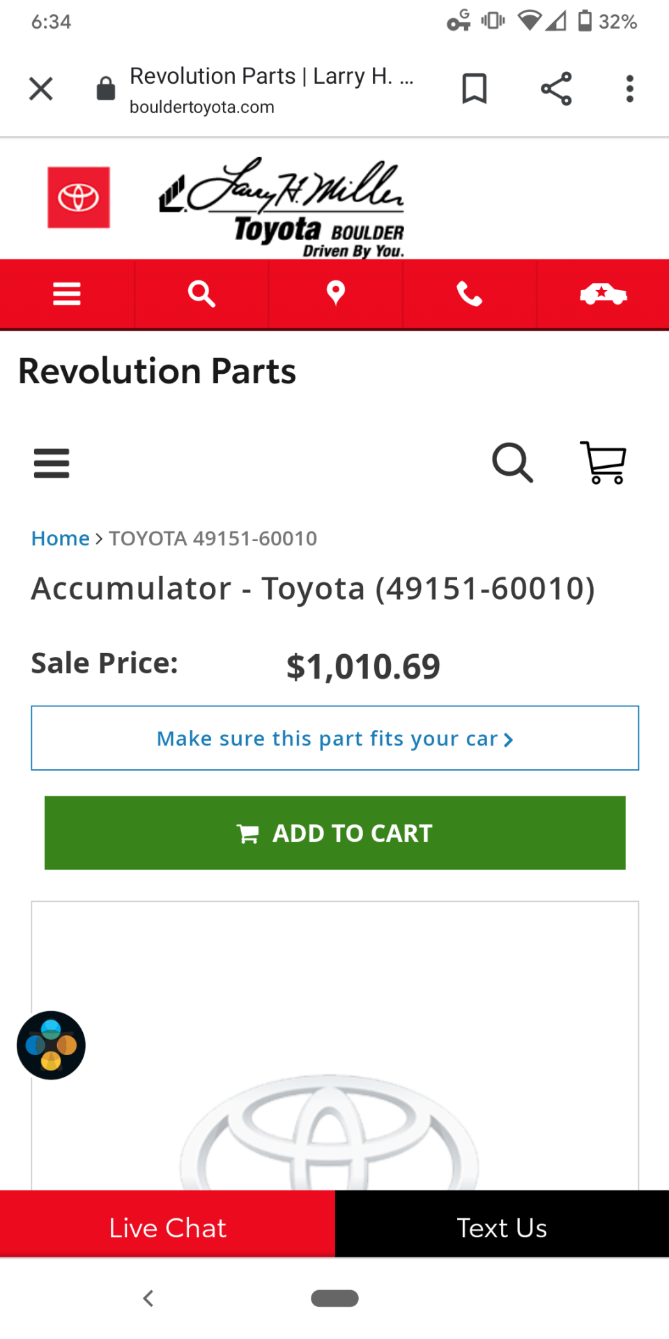

Holy shĆ·t! Is 1500 or more of that labor?
$4400 with labor is actually pretty low. My local dealer is $4000 before labor or sales tax. I figure $5k+ with labor.
When the exact same part made by the same factory with the same testing/branding/packaging is priced different by a factor of 8, something is broken with the market.
This stuff is part of why the "Expensive AHC" myth started. Take out the inexcusable dealer markups and the parts are all quite affordable.
