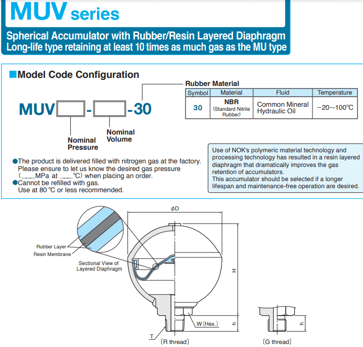

"MUV: spherical accumulator with rubber-resin layered diaphragm." This is from the site ekkeagle.com, which also says "The MUV series incorporates a plastic laminated diaphragm produced by polymer materials..."
EKK Eagle is a Japanese company making such globes.
The -400 corresponds to the capacity of the front globes. The rear ones would then be -500.
The 200 corresponds roughly to the nominal pressure in bars (226 bar for the fronts) but is more likely just the model series.

EKK provides a catalogue and some information of interest concerning MUV type accumulators, as identified by @uHu:
https://www.ekkeagle.com/en/wp-content/uploads/2017/01/EKK_Accumulators_EN_201510.pdf
Interestingly, (for those who like to get into such details :bang:), the EKK catalogue notes that:
“Use of NOKʼs polymeric material technology and processing technology has resulted in a resin layered diaphragm that dramatically improves the gas retention of accumulators. This accumulator should be selected if a longer lifespan and maintenance-free operation are desired.
Cannot be refilled with gas. Use at 80 °C or less recommended”.

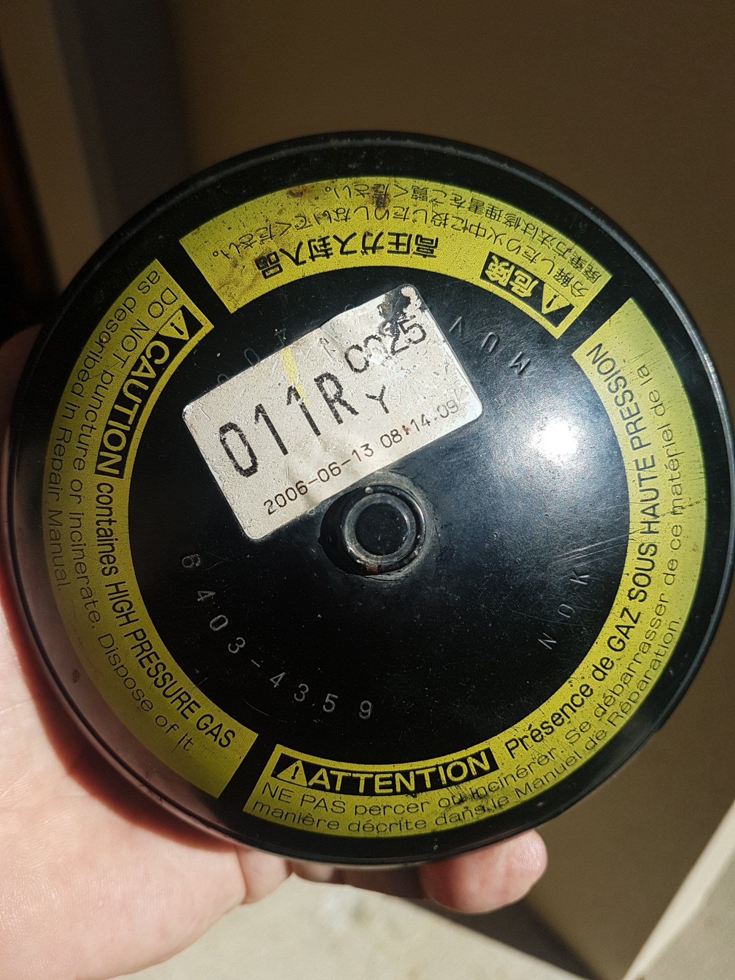

Different to my replacement ‘globes’ reported earlier in this thread (and which arrived without a date sticker), the original ‘globes’ on my June 2006 LC100 (Model designation HDJ100R-GNAEZQ) have the initials “NOK” engraved or stamped on their top face (under the sticker in one case). Two examples are shown in the pictures below. The date stickers are clear and may refer to the date at which they were supplied to Toyota after nitrogen had been added. The following numbers also appear:
MUV 200 – 400 (on a Front ‘globe’)
6403 - 4359
MUV 200 – 500
(on a Rear ‘globe’)
6412 - 0642
6403 - 4359
MUV 200 – 500
(on a Rear ‘globe’)
6412 - 0642

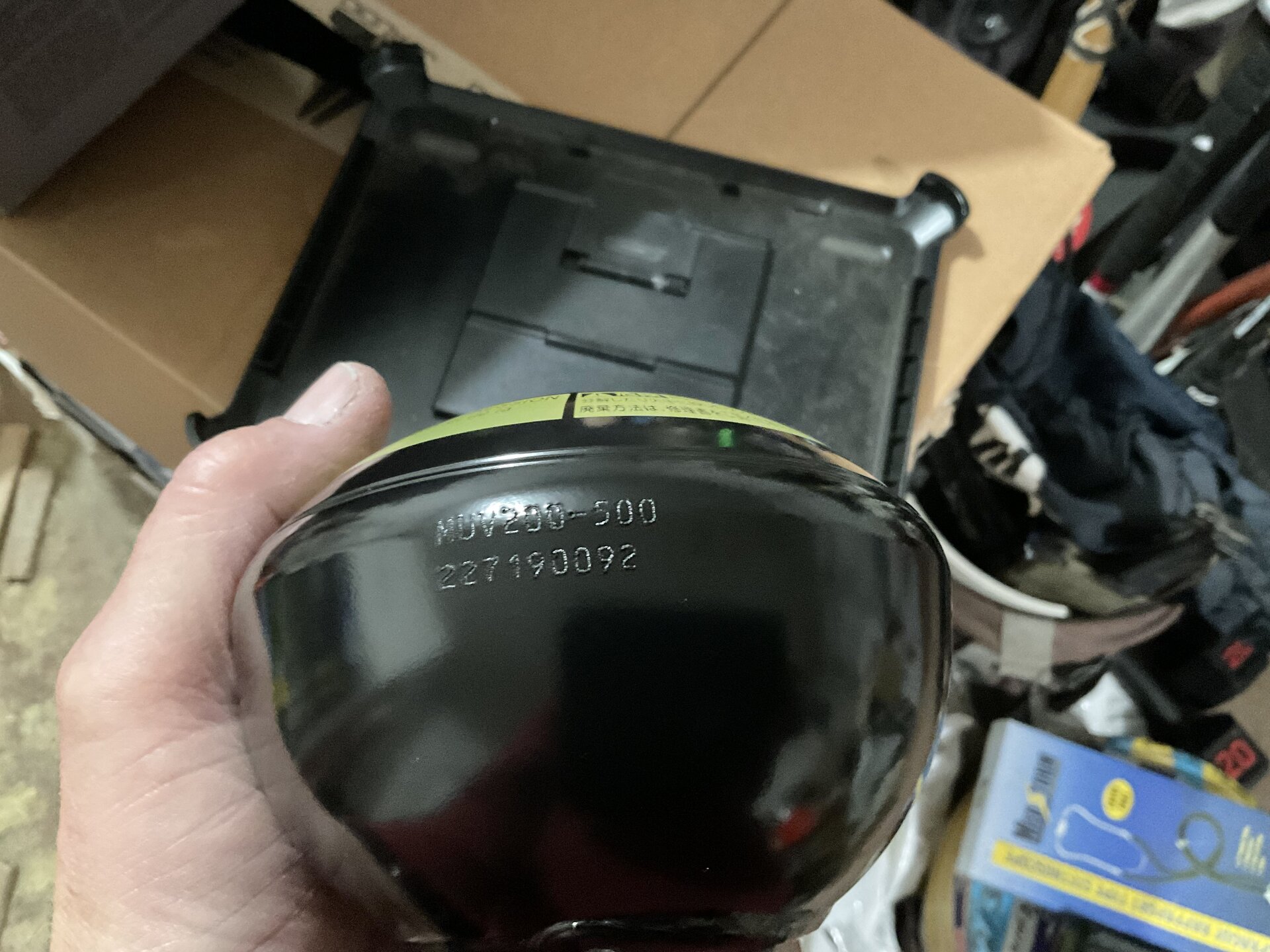

Bad news. Someone on Instagram got new globes and was kind enough to send me numbers:
MUV200-400
211220679
211220624
MUV200-500
211120273
211120190
No “Y” in the codes like others. I think my original theory is probably out the window. At leas mostly incorrect. Hoping the 21 at the start of all of these is year 2021, but that seems optimistic.

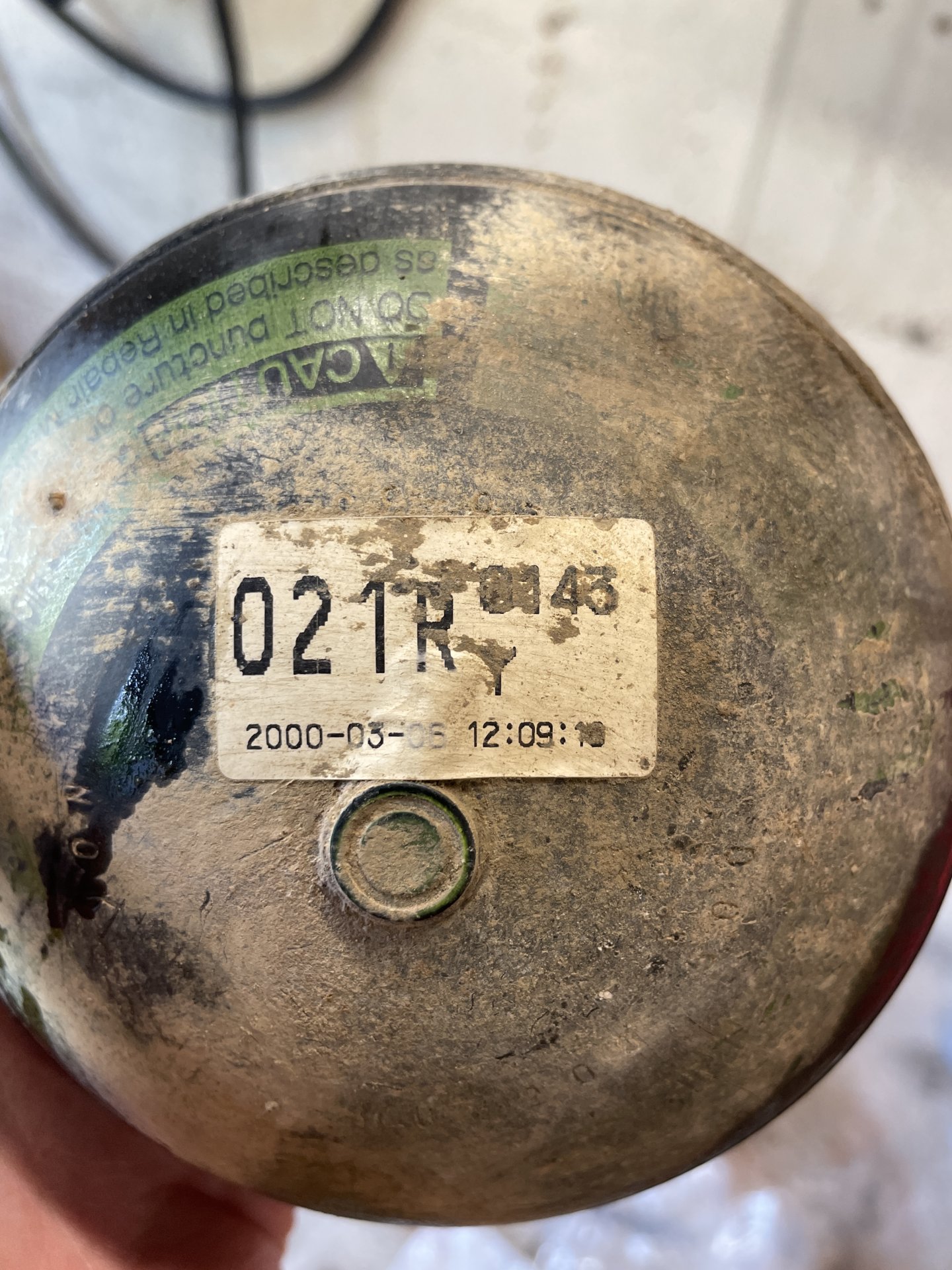

More data. Did my own globes yesterday, got new ones form Impex Japan. Old ones were original from 2000. How do I know? Becuase Toyota makes very high quality stickers that have survived my mudding, submersion, and God-knows-what else:
Looks like they aren't putting stickers with dates on any more obviously. One of my new globes had a similar manufacturing code to our previous examples. Starts with 22, so I am hoping the first two digits are manufacturing year given that we had others in the past that would have reasonably correlated with this theory.

Wondering what are the numbers engraved/stamped on the metal case of the original OEM 'globes' removed from the vehicle -- below the muddy surface? These are almost visible when the pic of the old 'globe' is enlarged but are not clear ....
I will go clean them off sometime when I have the chance. I have all 4 originals. I think it's the "MUV-xxx" numbers but not certain either just glancing at that photo.

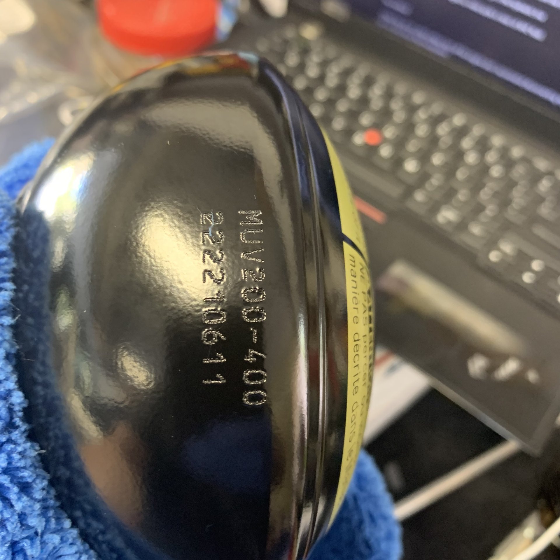

Here’s two of mine from this past weekend install

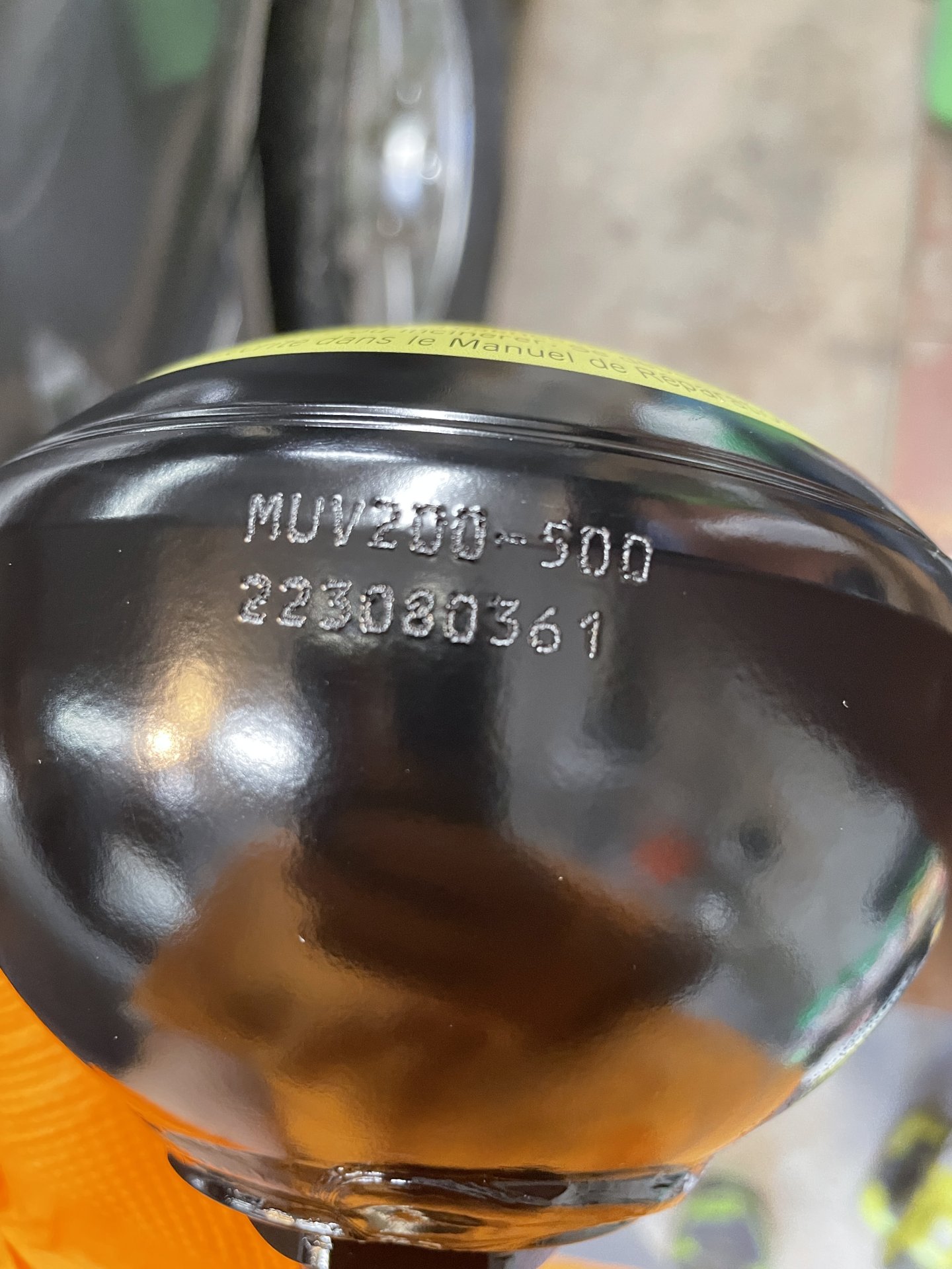

Received my new globes today from IMPEX Japan… 1 sample of each, rear and front.
Is it probable that the Globe Code is YY/M/DY/daily 4 digit serial number…?
month being 1-9, X is 10, Y is 11, Z is 12.???
