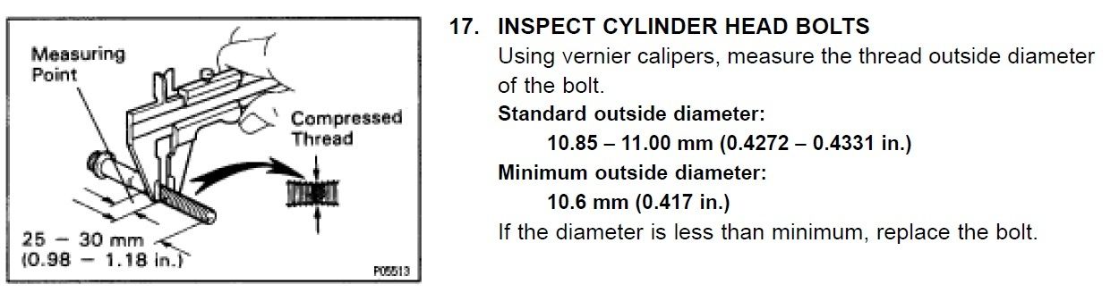

You should be fine to reuse them. One time for sure.
You have to measure the thickness per the FSM and if they aren't stretched too thin you are good to go
How much is your engine worth? If it's less than the cost of the head bolts, go ahead.
In my experience 1FZ head bolts are usually re-usable at least once, sometimes more. They do need to be measured for minimum diameter to confirm serviceability.

While I agree with Dan, I must say on my second 1FZ-FE HG job I did purchase new OEM bolts. (On an earlier engine build I reused the original bolts.) For me, that amount of money was worth it. I was building the engine to do another 20 years and the comfort of stretching fresh, quality bolts was worth it. The reused bolts felt different when I did that last 90 degrees.

Its fine, just make sure to run the calipers on them per FSM.
As said already...reuse those that are in spec according to fsm. Replace those out of spec or at the ragged edge. Also report back here if you dont mind the measurement of the bolts that were removed adjacent to the headgasket failure pt. The only bolt I removed that was out of spec was the one right next approx 10oclock to no. 6 cyl. Which was also where my HG failed..another bolt was close to outside spec so I replaced that too...it was also near no.6. Have fun. Its not a job I am anxious to repeat....

I reused all but .one had corrosion and had been stretched to the point it wasn't in spec. Got oem Mr T one, and only one it was 13 bucks and change but shipping from Florida was another 12 bucks. Piece of mind I guess but honestly I really think I could have reused it.
