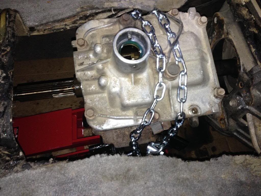

You don't have to. I rhino lined my floors and did not want to remove the trans cover. I recently pulled my trans/transfer and it came out from the bottom side just fine like most any other vehicle.

On the E-80 40 & 50 series, place jack under transmission.
Remove the 3 bolts in each BH mounting ear, lower the rear of the tranny/transfer down until the shift tower just clears the bottom of the shifter hole in floor.
Support rear of engine at that angle.
Remove 4 trans/BH bolts, slide trans rearward & remove.
Install is reverse of removal.

No, not necessary. On the E-80 40 & 50 series, place jack under transmission. Remove the 3 bolts in each BH mounting ear, lower the rear of the tranny/transfer down until the shift tower just clears the bottom of the shifter hole in floor. Support rear of engine at that angle. Remove 4 trans/BH bolts, slide trans rearward & remove. Install is reverse of removal.
