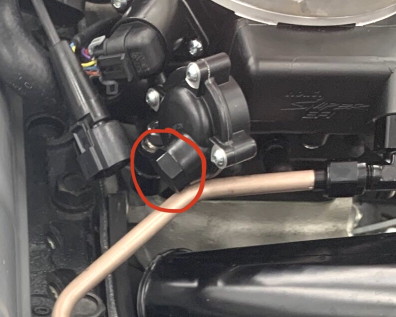

The air cleaner adaptor with the 1/2” spacer was pretty close to the intake on the unit itself. We decided to mill the Redline adaptor and use the 1” spacer. It looks much better and won’t be as restrictive. Also peeled the fuel pump off, replaced it with a 3FE block off plate and played with some NiCopp fuel line. I had to call it a day as need to get a 45* fitting for the sniper inlet to clear the rear air horn.
There isn’t a lot of space for fuel lines between the F air cleaner and the Sniper. I tried a 45* -6AN but it was too long, the 90* swiveling adaptor was just right. The fuel line on the engine is complete, the regulator and pump are where they are going to be mounted. A few more hours of plumbing and wiring and we should be ready to fire it up. The old alternator has also been swapped for a reman.

I will be running mostly hardline to the Sniper so a small fortune in AN fitting is required. After scouring countless sniper threads, the LS regulator was mentioned and I will be using one downstream of the pump to eliminate the return being in the engine compartment. The return port will be plugged on the Sniper.
