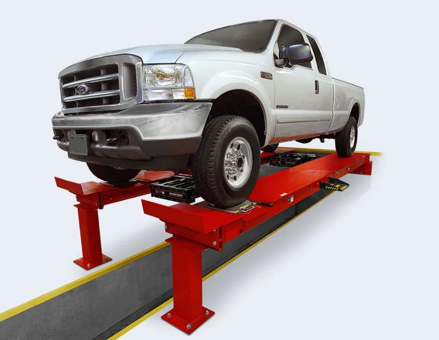

One of the biggest PITA of the job, which I need a solution for in future jobs. Is torquing nuts once laden (tires on ground and T-bar set). Because getting a 1/2" or 3/4" torque wrench on the bushing nuts of bolts to torque to 170ft-lbf, I've just to little room to swing the wrench. I'm thinking about using drive on ramps.
BTW: I torque all 8 (LCA bushings, shocks lowers and links bolts), once laden.
Good deal. That finishing torque touch I had to pay to get it done on one of these machines. It wasn't cheap since it's not part of a routine alignment.

Issue too with many lifts, for just general service. Is blocking some points, I need to get to. Ideal lift would have 4 small point of lift, come up out of floor up to ~6 1/2 ft. Those being at jack-stand positions fame points. They then pull back into floor flush hidden away.

But for this job a scissor jack will not work. Wheels must be on ground, or a ramp as pictured above.
It's best to have vehicle level, with weight on all wheel in a neutral stance normal empty (unloaded), full tank of gas. Just like when adjusting T-bars. The reason for this is same reasoning behind adding spacer to bushing. We do not want rubber of any bushing loaded, while vehicle in neutral stance driving on flat ground.
