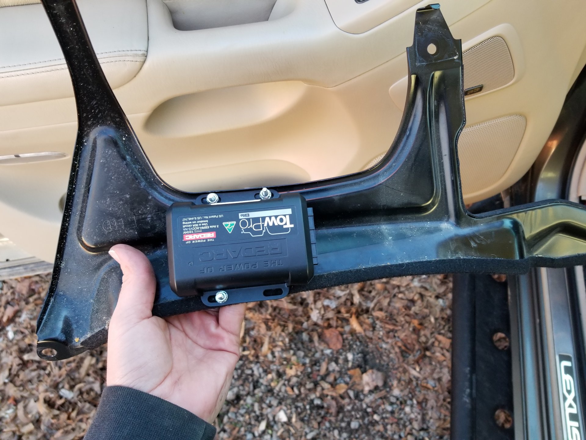

Today included finishing the install of a Redarc Tow-Pro Elite brake controller. I used a Tekonsha harness between the OEM Lexus plug and the Redarc (which still required splicing, but at least the colors were the same and the OEM harness is intact) and mounted the controller to a metal plate/shield under the steering column. I put the actual controller dial on the enter console below the DAC button, as I figured this would be the easiest place to access the dial while driving (as the Redarc allows brakes on the trailer only to be applied by pushing the dial). The height control/suspension buttons are also reserved for future F and R e-locker buttons.
Overall this was a pretty easy install and turned out well. Now we just need to get a camper and make use of it!

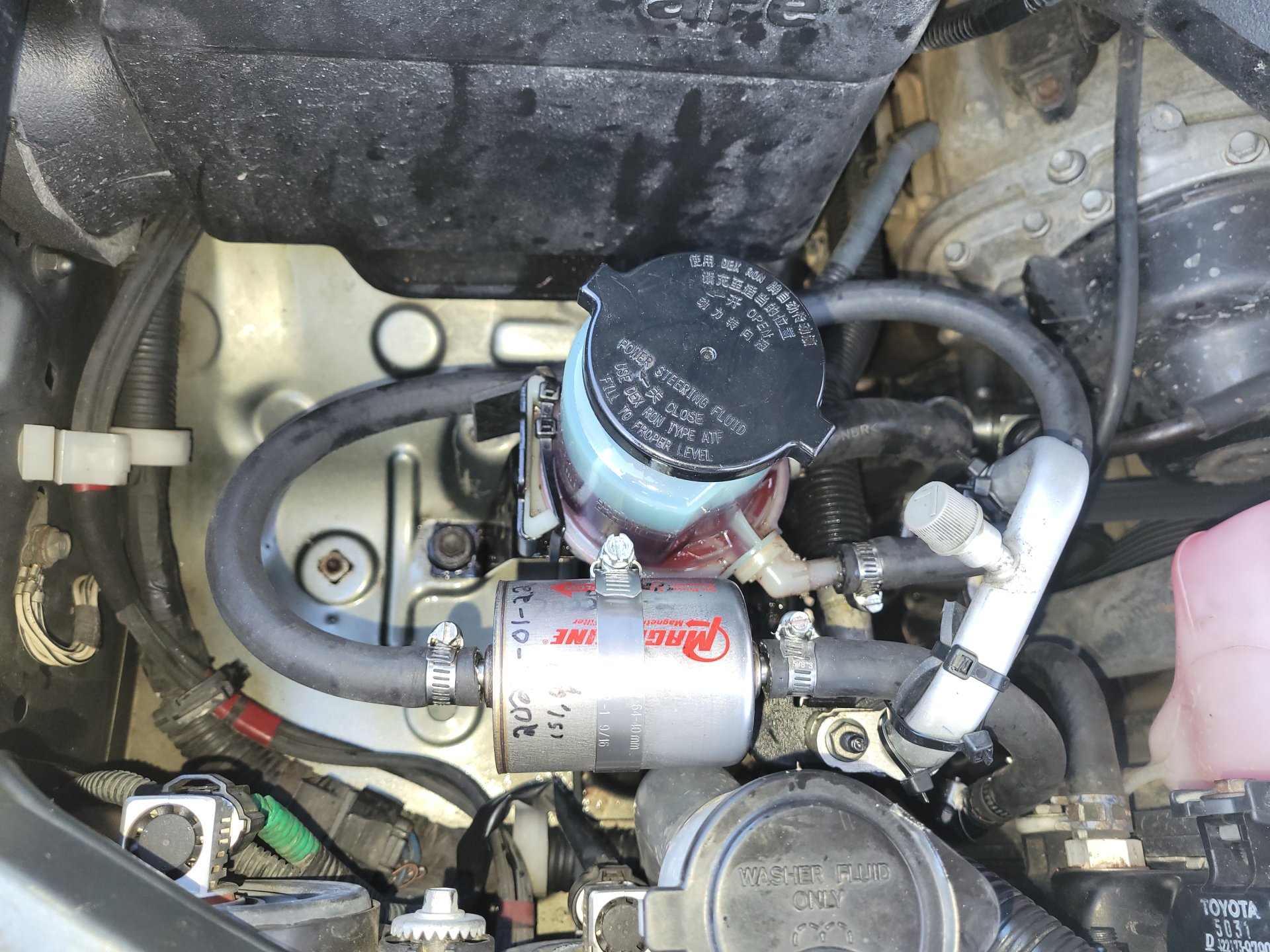

The first order of business was installing a power steering filter, as I had noticed some metal flakes in my power steering fluid from last weekend (within the drain pan when I poured it out). Not sure if it was from the old rack or my pump, but at this point I'd prefer to have my old pump and new rack last as long as possible. I used a Magnefine filter and mounted next to the PS reservoir, on the low-pressure line, and wrapped the line around the reservoir. In the future I'll swap out the filter every time I flush the PS fluid (probably ever 30k or so).
I mounted the filter on a simple C-bracket I made from some 1" steel flat stock. I painted it flat black, bolted it to the PS reservoir foot, and secured the filter with a hose clamp and piece of rubber.

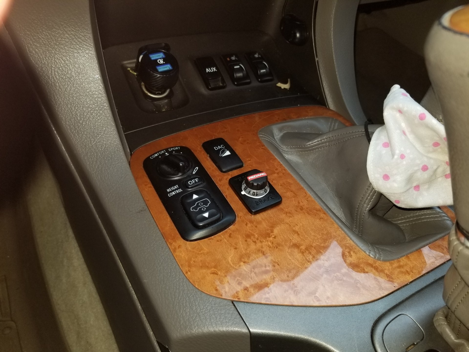

And last was a zero point calibration (ZPC). My VSC had been acting weird since lifting the GX (it would kick in randomly around corners), and my VSC OFF lights had been intermittently on since getting an alignment on Monday. I used a few pieces of wire and twisted them together during the ZPC. It seemed to drive fine around the neighborhood; hopefully it stays that way.

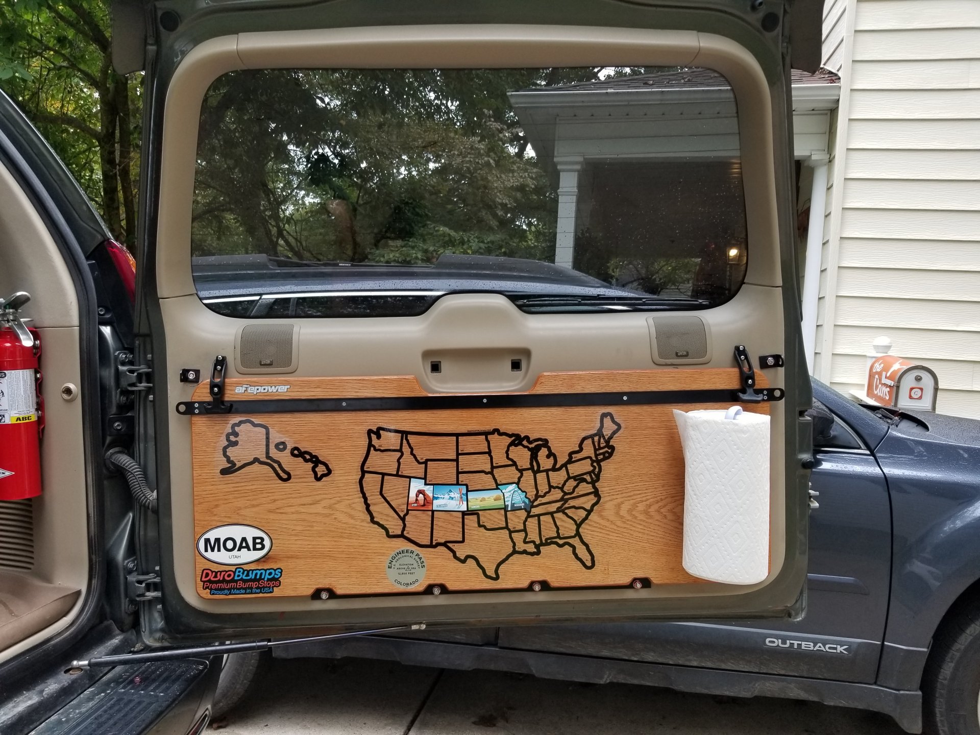

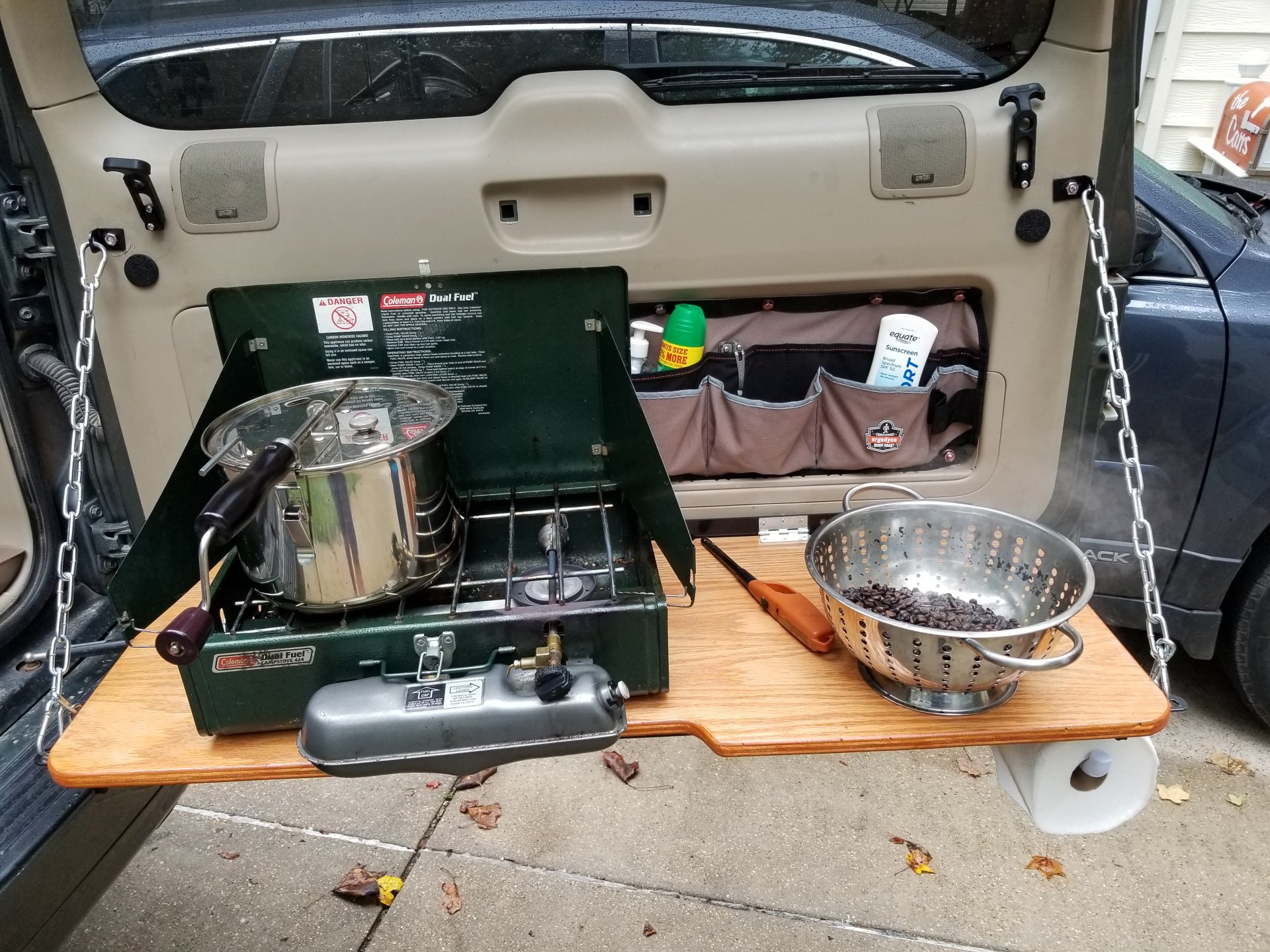

Finally finished the DIY rear table today, and broke it in by roasting ~2/3 lb of Sumatra beans (90% of the use of my Coleman stove, the rest is actual camping). Overall it turned out great and I'm very happy with it. It's super-sturdy and I'd be comfortable putting 40 lbs on it or so. The chains rattle quite a bit, so they get pulled off after use and dropped in the canvas pouch.
The bottom of it will be our family vacation map, though just limited to trips in the GX (we've been to quite a few more states, prior to purchasing the Rednexus). I like stickers, but not necessarily plastering the outside of a vehicle with them, so having something more secluded (and not painted) is ideal. We have a camping trip to Arkansas planned later this month and will get to add another state and use the table more.
Source for the pouches on the right side?
