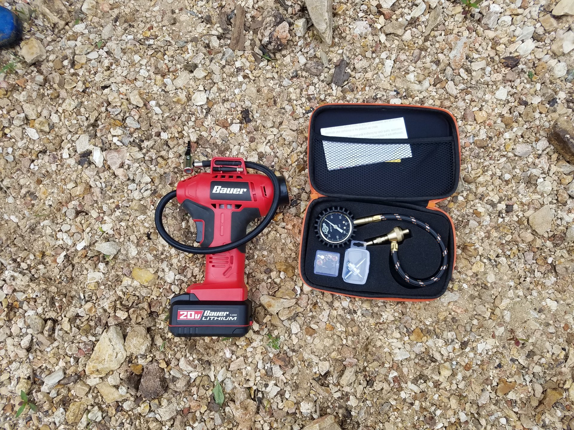

This is my $110 air-up/air-down setup. The deflator was $25 on Amazon (knockoff of an ARB) and works great. The inflator is a Harbor Freight special - nice to use the same batteries as my impact driver, weed-eater, etc. It was able to air up each tire in around 3-4 minutes from 18 to 32 psi and still had 2/3 of a charge after all 4 (using a 5 amp-hr batter). Total cost was $25 for the inflator and $60 for the battery.
That's great. did not know that option existed for inflating. Very nice to know. I air down in my woods truck for everything but I always end up going back to the house to air back up (I live in the woods by the trails). Does this take the Milwaukee 18V battery pack?
It probably does not take the Milwaukee pack but Milwaukee might have their own version. I'm surprised more people don't go this route. It's marginally slower than an onboard compressor and much more versatile. You can run lights, chainsaws, impact drivers, etc off of the same battery pack.

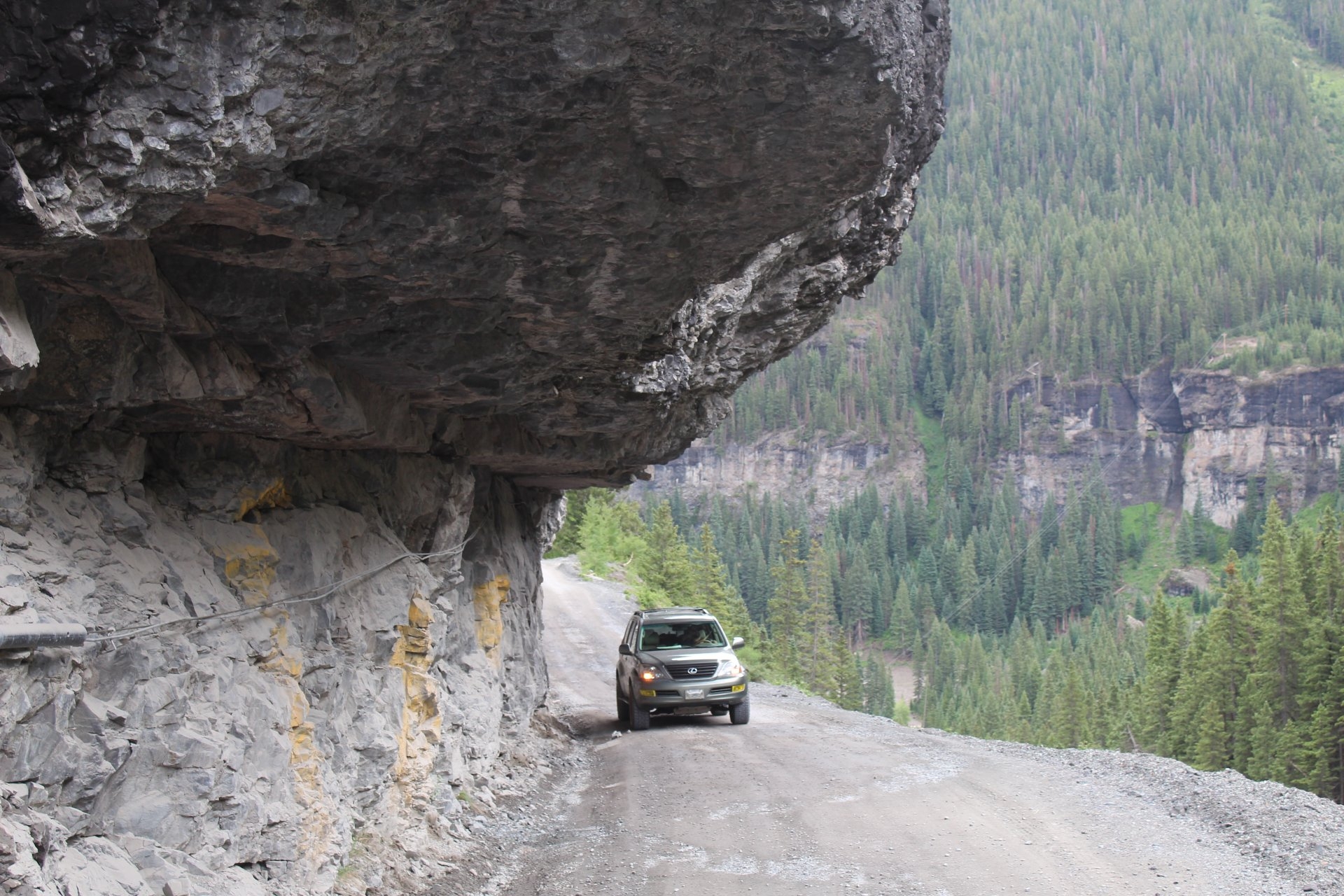

Yankee Boy Basin Overhang

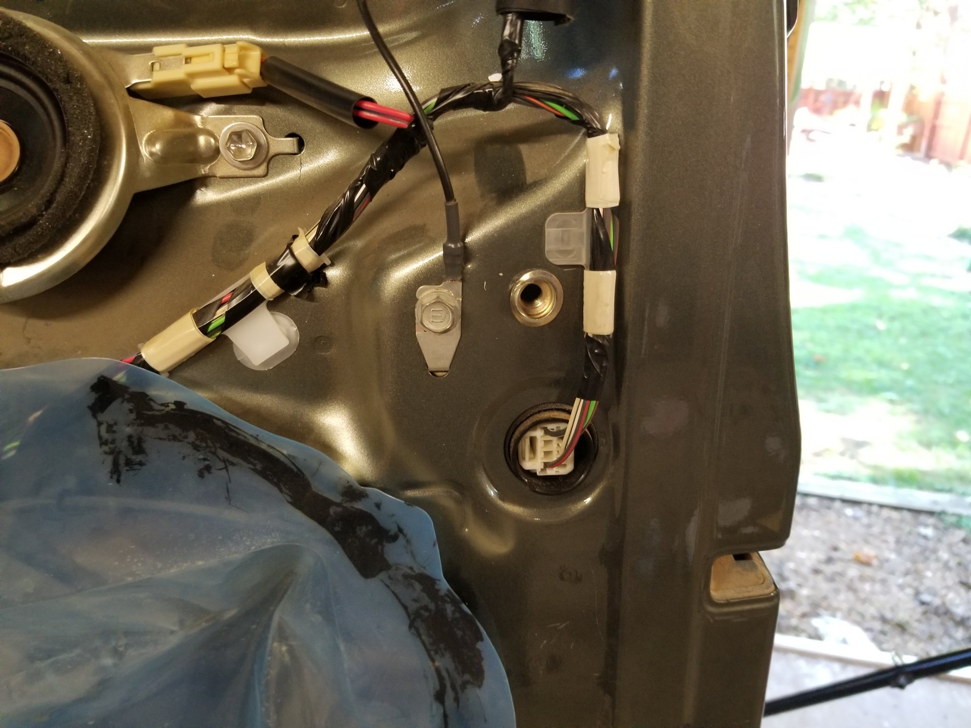

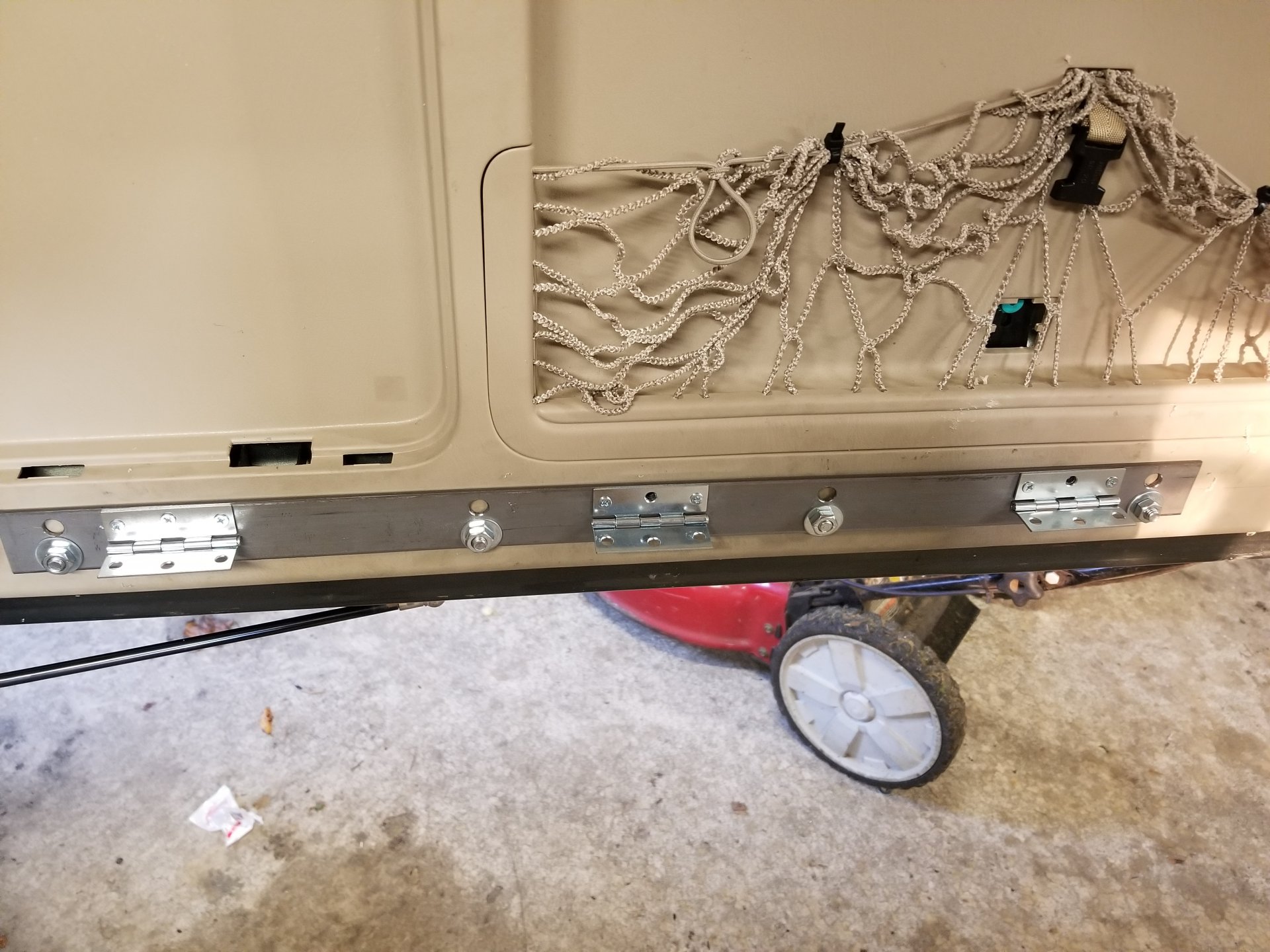

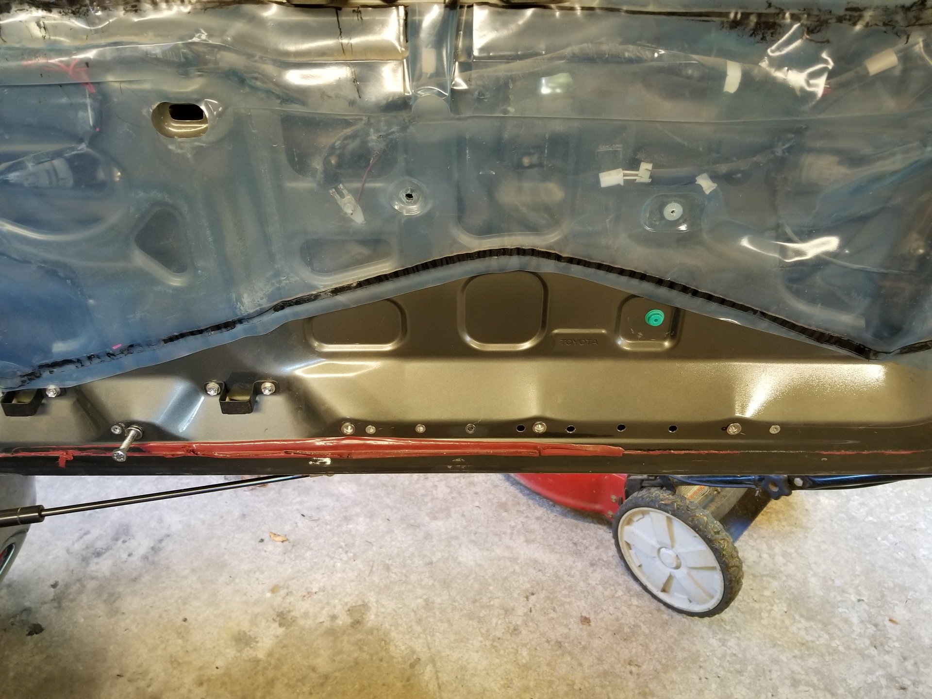

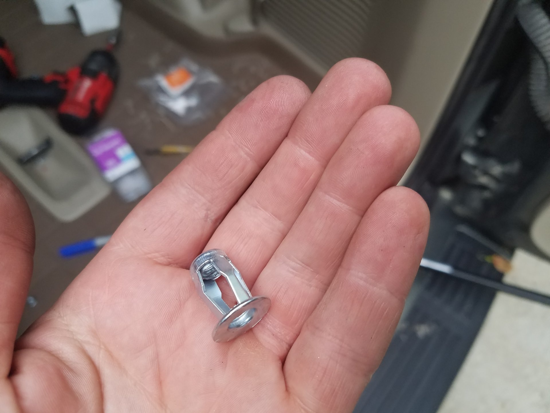

Tonight I completed the rough install of a DIY rear door table. This one is 100% metal-mounted. I drilled out the rear door panel plastic fasteners at 4 locations on the bottom and 2 on the top and installed M8x1.25 rivnuts in their holes within the actual door. I then used studs to attach 1.5" steel flat stock at the bottom, attached hinges to that, and made some angle brackets at the top. The table is supported by two pieces of chain and charabiners, and held in place with some plastic cooler latches. The actual table is 3/4" oak plywood. Overall, it is super sturdy, although I may swap the chains out for some paracord. We're going to the river this weekend so I'll test it out before disassembling, painting the metal, staining the wood, and coating it with polyurethane.
I really like the rivnut idea. My table is a similar design, but doesn't cover the factory tool kit. I had parachord on mine for quite a while and recently just swapped it for nylon coated cable. The 550 chord had too much spring to it for my tastes. Ace hardware sells the cable by the foot. You just swage the collars wherever you like. Very easy to work with, they can be crimped with a hammer and a drift/punch.
Thanks, I'll skip the paracord then. The chain is good but not adjustable at a fine level - although looking at my pics again the upper bracket on the left is not quite level, so maybe that's why my table was a bit off of level too :).
So far this seems sturdy, but I think the failure points are bending the sheetmetal around the rivnuts, and probably at the top. A heavy load would bend the studs down. It's still probably sturdier than a plastic-anchored table, however.
Finally finished the DIY rear table today, and broke it in by roasting ~2/3 lb of Sumatra beans (90% of the use of my Coleman stove, the rest is actual camping). Overall it turned out great and I'm very happy with it. It's super-sturdy and I'd be comfortable putting 40 lbs on it or so. The chains rattle quite a bit, so they get pulled off after use and dropped in the canvas pouch.
