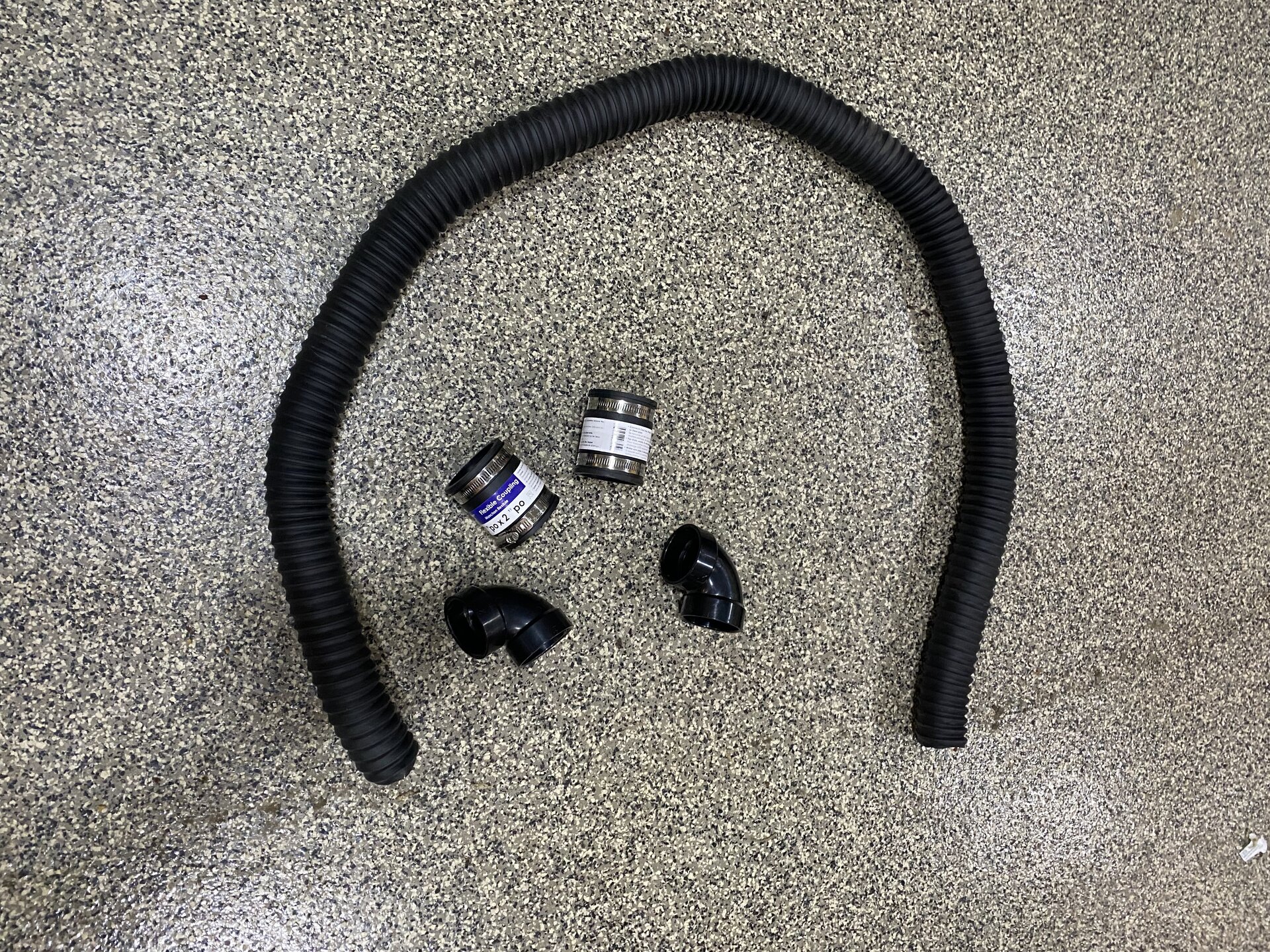

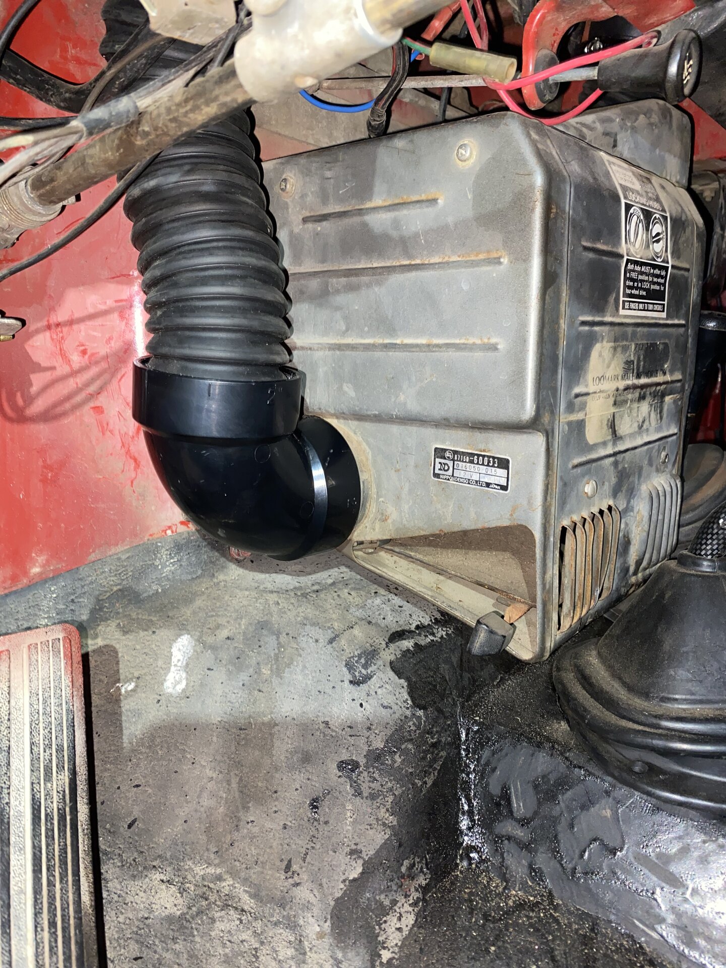

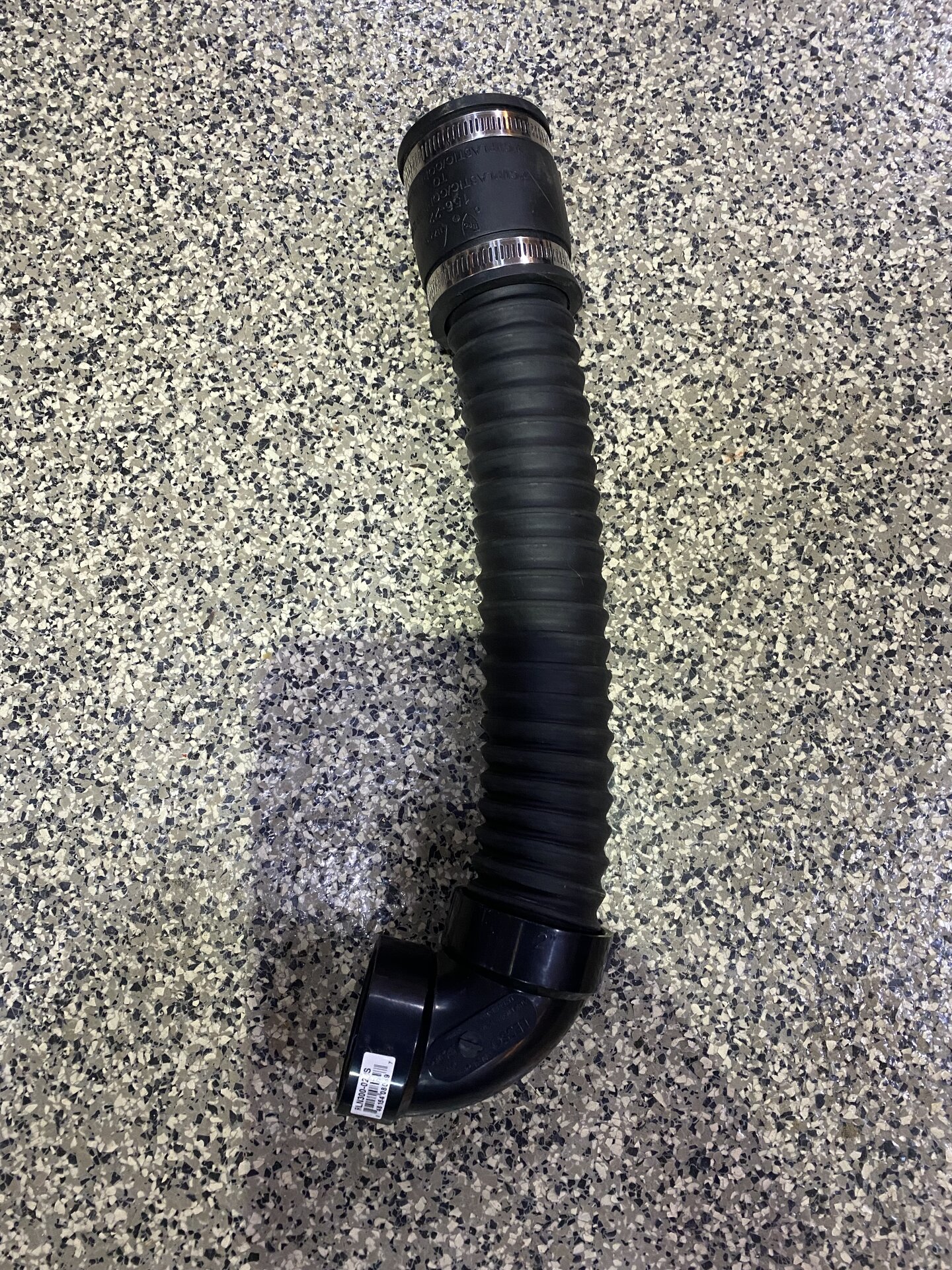

added my go at defrost duct reconstruction to this thread. Interior Heater Ducts FJ40 - https://forum.ih8mud.com/threads/interior-heater-ducts-fj40.498486/
i used about 18 inches per side of a rubber hose with a built in copper wire as i couldn’t fine 2 inch shop vac hose. the above thread talked about 2 1/2 foot inch hose. i don’t know if the later heaters used a large diameter. this cost me about $50 CAD for both sides.
now to make a connection from the baffle to the heater. i’m going to try to make my own neoprene sleeve out of an old wet suit.

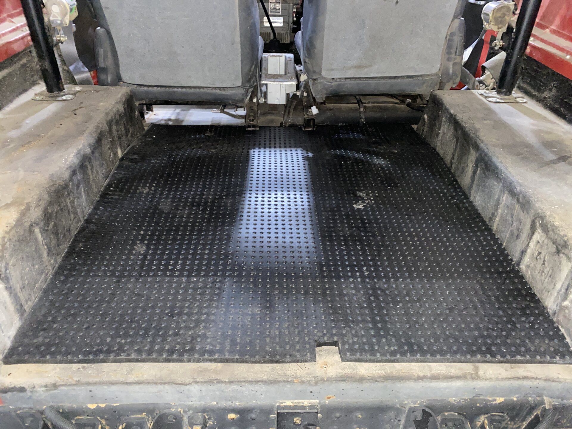

i also added some weight and sound deadener by means of a trailer mat. but in the process of opening the hatch my handle broke 🤬
i have some more mat i’ll make some for up front yet but maybe not tonight.

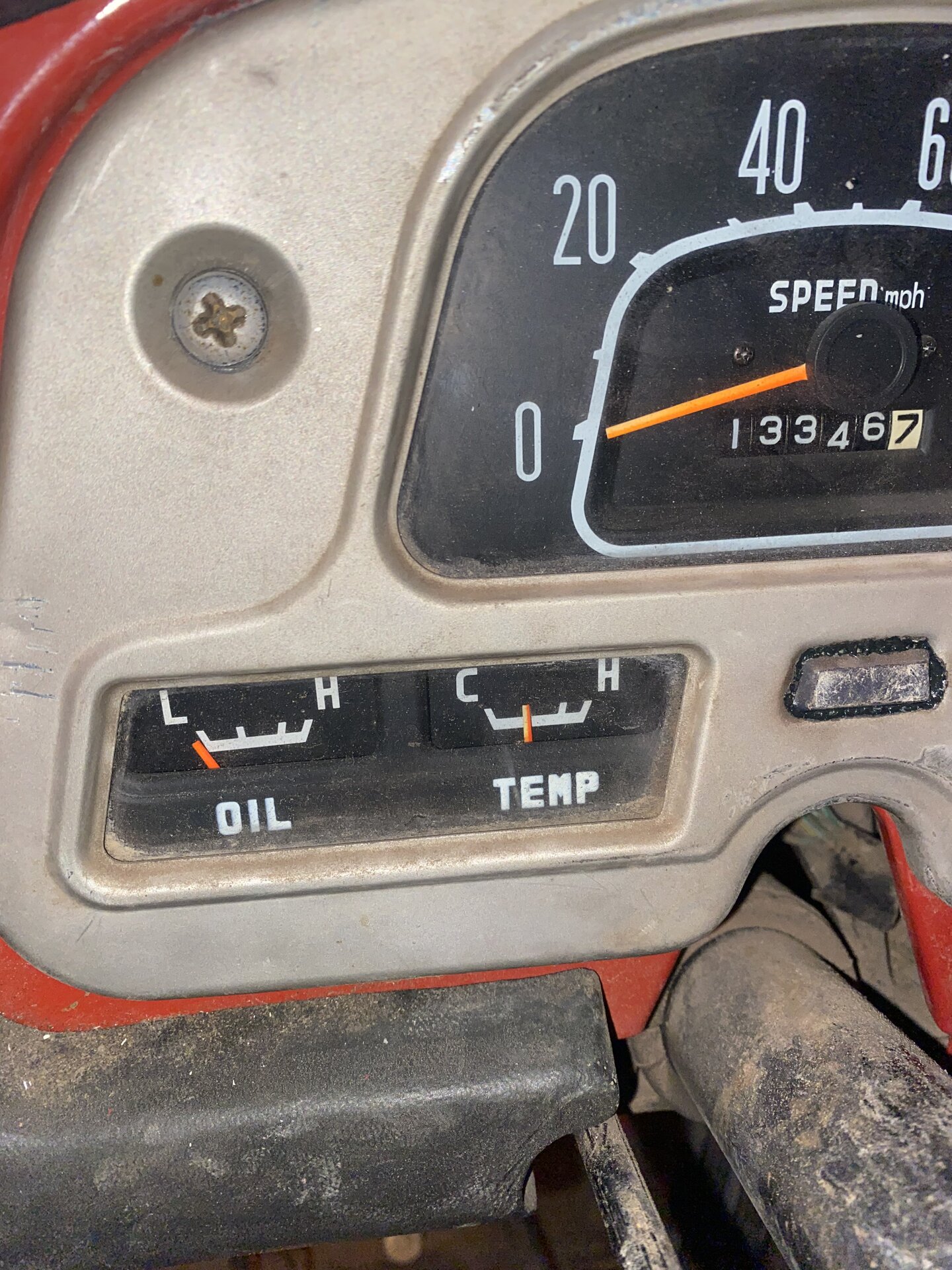

adjusted my temp gauge tonight. used this thread
after confirming my engine temp is right at the thermostat using a temp gun i made this adjustment. my gauge works as it should but when it’s warm it was pegged to the right. that’s kind of useless. so i made the adjustment to get it to sit at the first bar when warm as per the above thread. pretty simple recalibration!
i also replaced the cluster lights while i was in there. i can see the gauges again!!

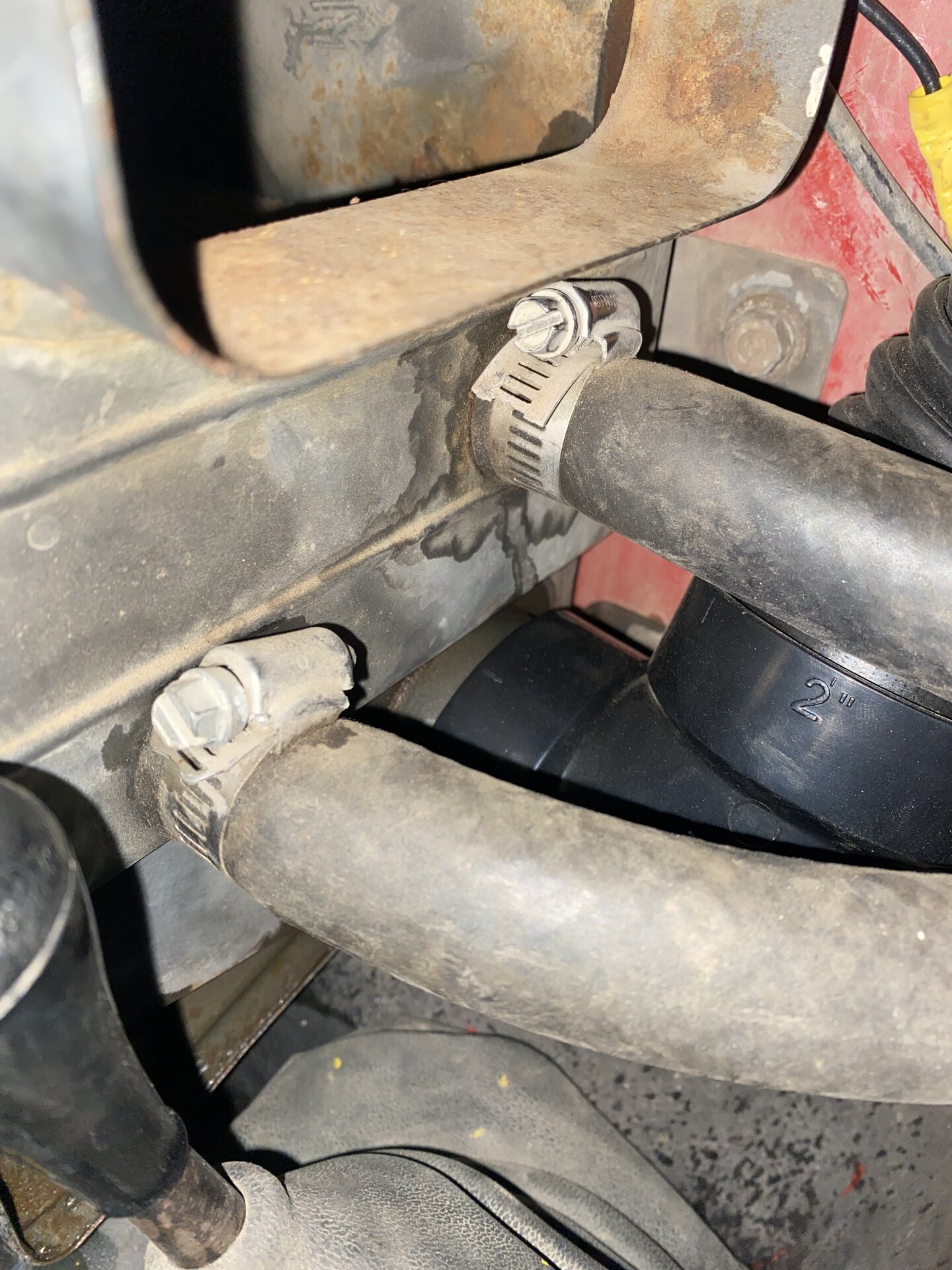

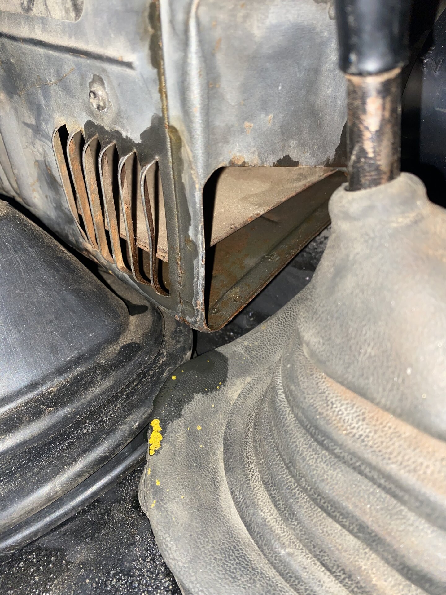

it’s been parked inside the garage all weekend and it hasnt had any rain or snow on it for a few weeks as it’s been quite dry here. i’m pretty sure it’s coolant
Removing the heater box is not too big of a deal. Just get the gear shift and transfer case levers down and out of the way. I put mine in reverse and low range and I could finagle the entire box out. I did remove the duct from the fan in the engine compartmen, which gave me more space. It was a worthwhile mini project. To remove clean and replace foam elements, and thoroughly rinse the heater core.
You could try removing the pipes in the engine bay and cap them off, and then blast clean water through the matrix with a hose pipe to confirm before disassembly.
There are of course various radiator fix products out there if you want to try a temporary solution.
Yeah I’ll need to pull it out i think. It just getting cold here and i just finished getting all the ducting rebuild and in place and was hoping to just drive it for a while. Oh well next project on the docket!!. I might just get a new core for it so i dont have too much down time but i’ll see.
