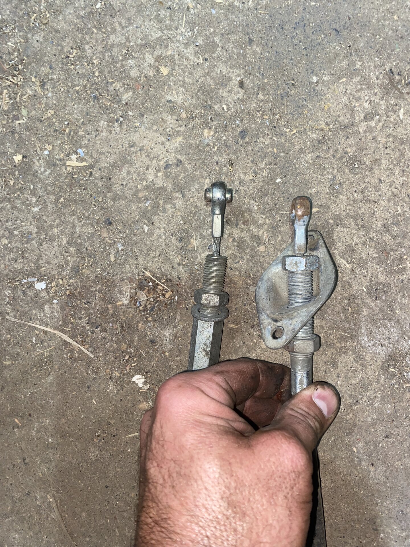

i was hoping to swap some of the 77 ebrake handle into the 72 handle to allow
me to use the 77 cable. no go. the 77 is to wide
72 is on the left 77 on the right. so i swapped the whole cable from the 72 on the the 4 speed. it all works but i may need to do some adjustments yet. not sure how well it’s holding but it’s attached.
here’s the difference between the early and later ebrake cable where it attaches to the brake handle
this time the 72 on the right the 77 on the left

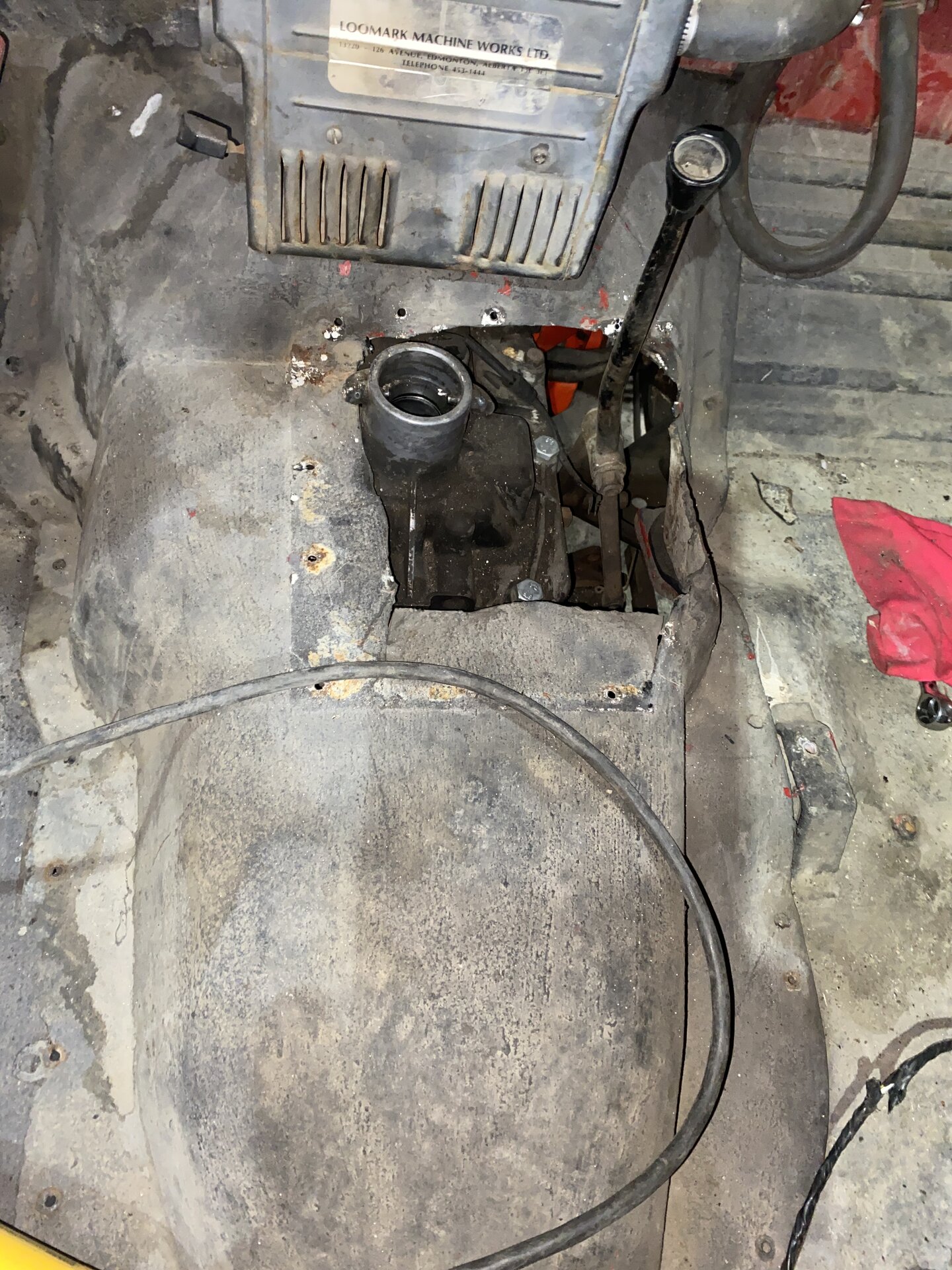

now i get to be the new PO who bastardized the tunnel! i have to make some cuts to get the shifters to work! guess i’ll likely have to fab a new cover plate after

got few little details done tonight. i wanted to finish welding up the tunnel but i ran out of shield gas 🤬. so i adjusted the ebrake. works nicely now. i reinstalled the rear drive shaft and then ordered some shifter boots from city racer!!

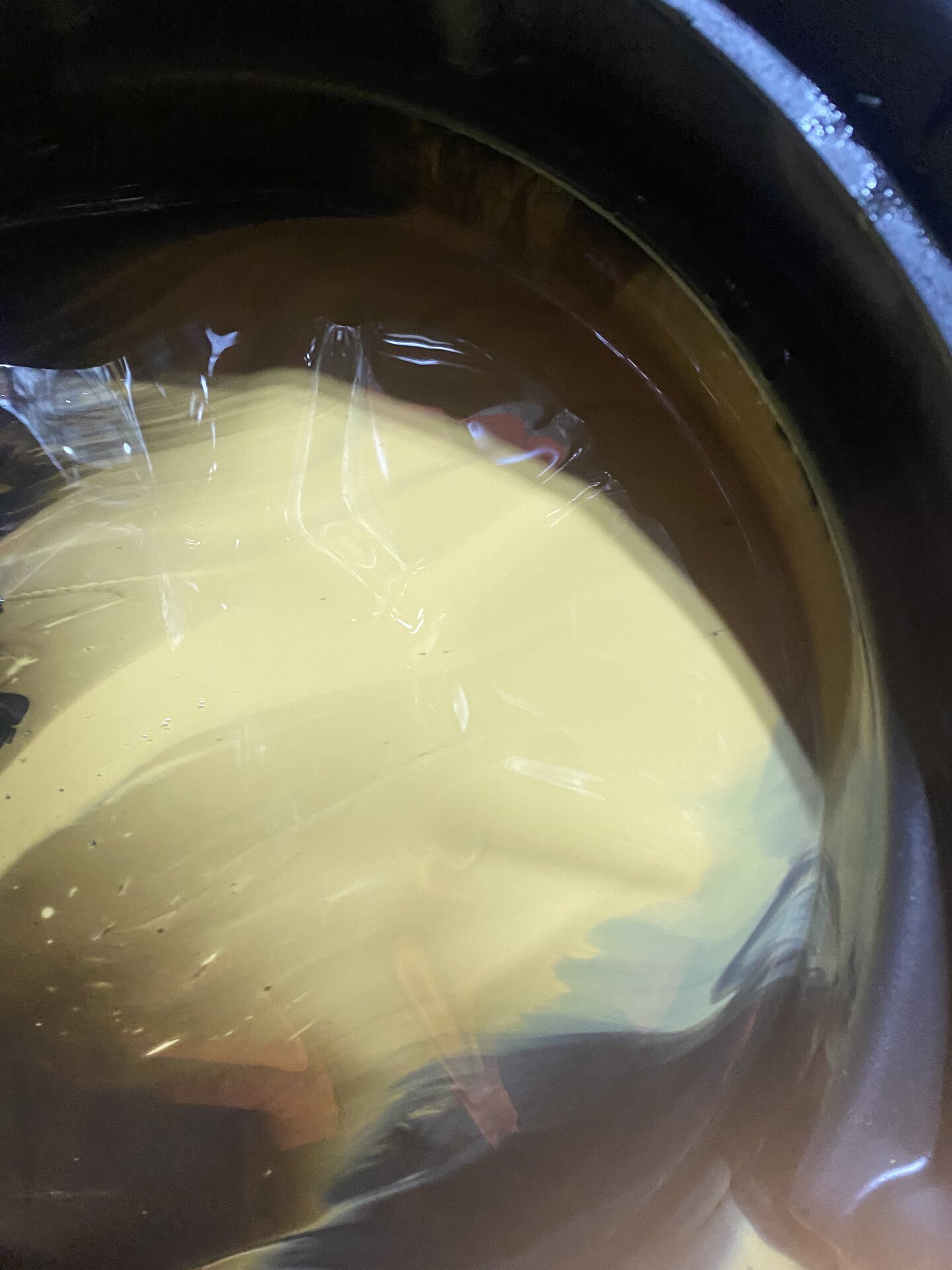

tranny flush as this came out when checking levels
gross
