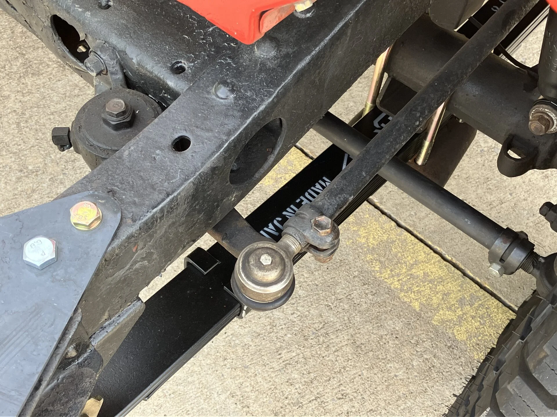

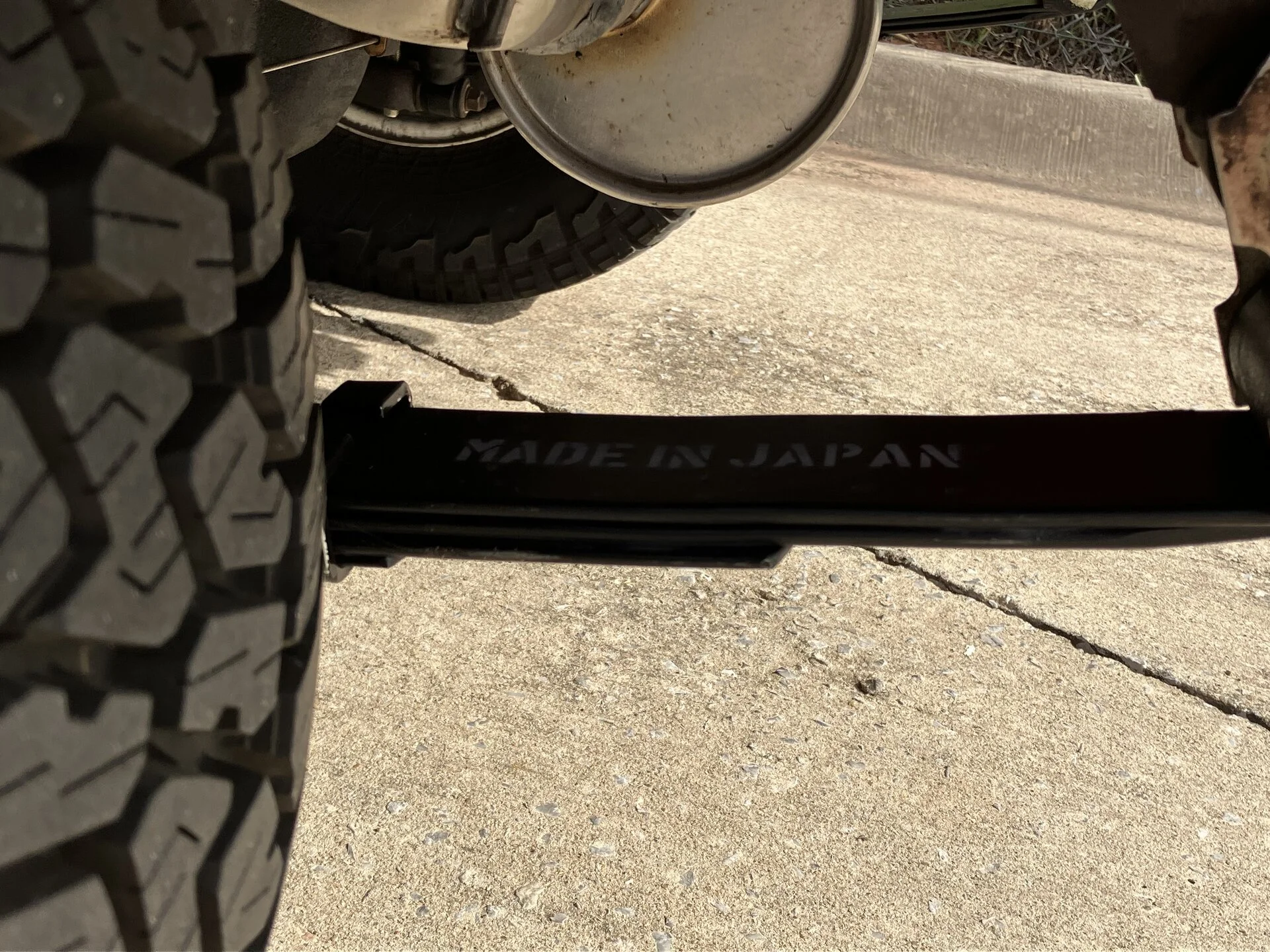

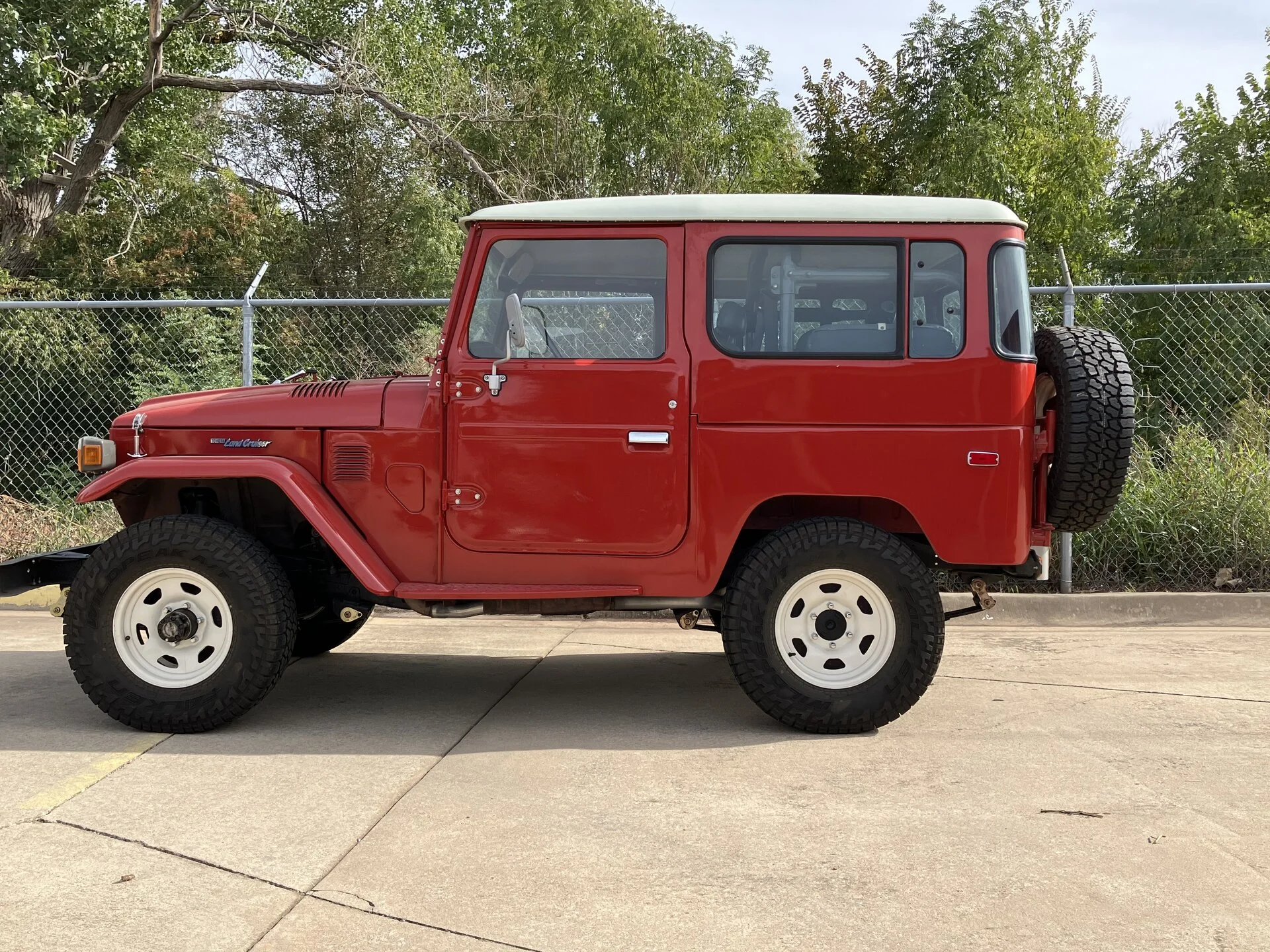

Great that you got the Japanese springs! What about some pics?
I’m looking at pulling the trigger in this same kit, would love to see some pics and what wheels/tires you are running with it.
Sorry this took so long. I hope these help. It looks like it was too dark to see the "made in Japan" in one of the shots.
I feel we are back in 1982...
Beautiful!
Beautiful!
Thank you. I can appreciate the lifted, tricked out 40's, but the bone stock ones are my favorites. Mine is stock except for being de-smogged (but still have all the deleted equipment for posterity).
