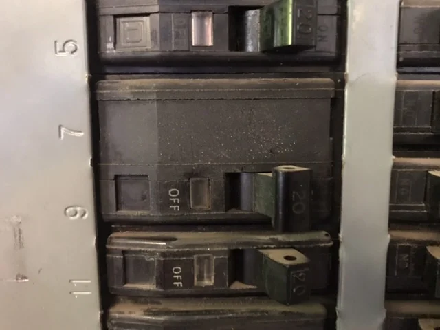

Something is fishy here. Can you post what the electrical installation looks like or consists of, and if possible, the breaker associated with your compressor circuit? Either your wire is WAY too small or you have a bunch of other devices on that circuit. You should probably have a dedicated circuit for the AC if you don't already. And as Eagle said, 5hp is the bottom of the barrel for shop air compressors.
The air compressor is the only item on this circuit. The electrician said basically to try to limit the usage of the circuit to 80% of 20 which is about 16. The motor which is on the A/C now was replaced a few years back and it is 19 amps, so it trips the breaker on occasion.
We are considering running a new wire over to the compressor and updating the breaker in the box. This is a pretty old building. That opens up a lot more options for compressors. 7+9 is the breaker. Can't see what the wire size is to the compressor because it's all in conduit.

If we assume that the original electrician sized the breaker and the wire appropriately, you will have 12 gauge wire on that circuit. The electrician is correct in the 80% rule. If you want to get anything even semi commercial you are going to need to jump up to a 10. If it's in conduit, then you might be able to pull the old wire out and pull in some new 10's and swap that 20 amp breaker out for a 30. You can do this yourself.

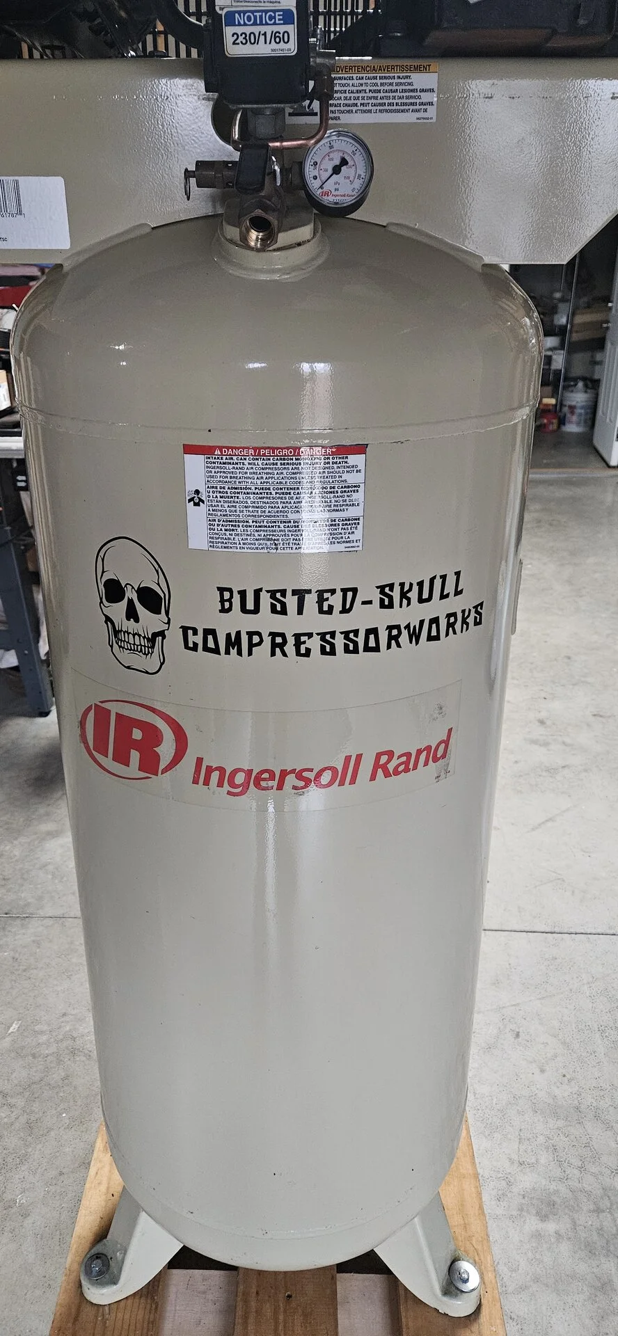

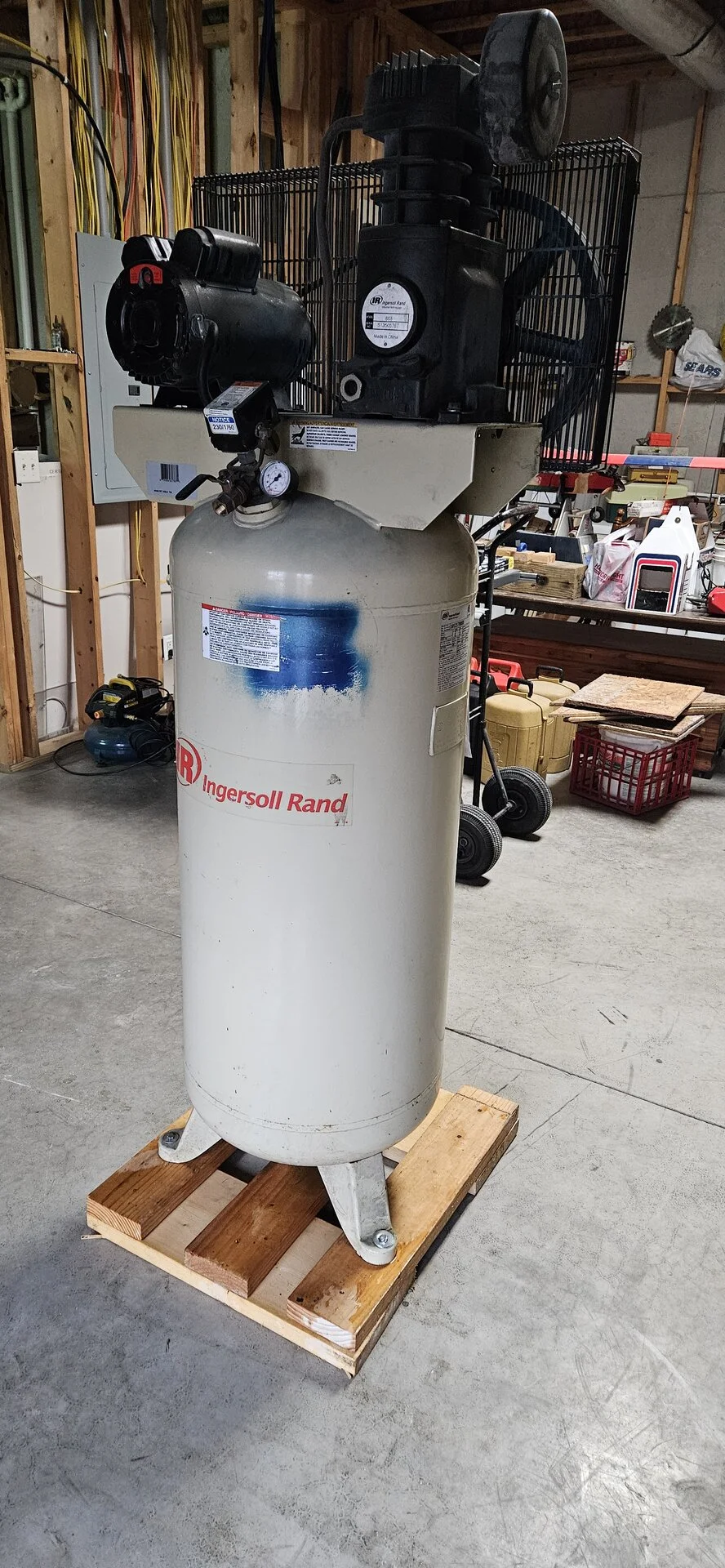

@Wildcat Walker nice compressor. What model is that?

Ingersoll SS5L5. It has one of the Emerson motors, but a mexico made one not the chinese. Oil looks very clean. The guy I got it from fell out of the rafters in his garage and almost died. He landed on his head and caved his skull in, dang near bled out, heart stopped twice in ambulance. Made a cool decal for it in his honor. I don't think these Ingersoll compressors are the best, but this one was dirt cheap. It should work for awhile. I have an 80 gallon upstairs I run in the garage. This one is just for blowing dust off guns and stuff.
I'm glad to hear that he survived it. Over the years I've heard (and known firsthand) a number of stories of crazy falling deaths or near deaths. It reminds me to always take a moment to think things through when up on a ladder or otherwise up in the air. Tree trimming accidents, Christmas light hanging accidents, changing light bulb accidents, etc... Although, years ago the owner of the shop I took my vehicles to died when he started down his basement steps, realized he forgot something, tried to turn around mid-flight, fell the rest of the way down, and broke his neck.
Dang, someone else has a compressor in the basement just to blow off guns and stuff. Not saying I do, but I may know someone who does!
