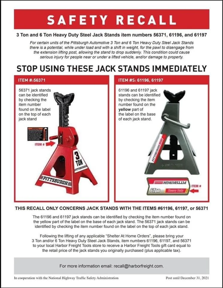

This the reason why I would not buy jack stand from HF. I will spend good money on good quality JS, not worth losing my life or a limb.
Thank you for sharing.
2013 to current for those who don't click and read link.

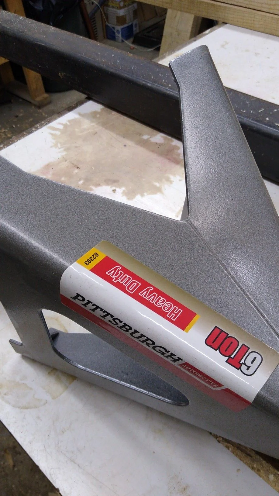

Have to check mine, although I'm pretty sure they're all much older than 2013.
Got winner.. this really concerns me becuase a jack gave out when I was using these before. Hope no one gets injured from this BS. Lesson learned.
Thanks for the PSA-just checked and I have a set of these. Seems they're trying to kill us anyway they can.

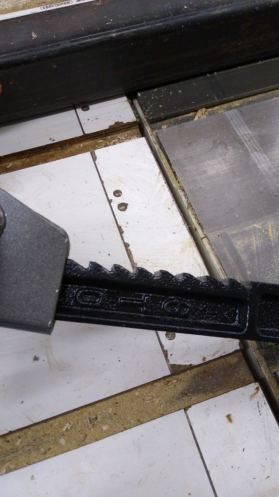

I would be curious to know what the exact problem is. Anybody can tell from inspection?
I haven't inspected mine yet - I can look this weekend. In an article on CNN.com I think they blamed it on worn tooling in China. Entirely believable but should have been stated "Sh!tty Chinese tooling manufactured at the lowest possible cost by people who have no clue how the end product is actually used." I've been to a lot of tool shops in China and what I saw was universally sketchy. Like Rockwell hardness varying 15 points across the same block of steel.
the basic idea behind those teeth would be -I assume- that the geometry of the pawl increases the locking under load. Is there a problem with that on those sketchy stands?
