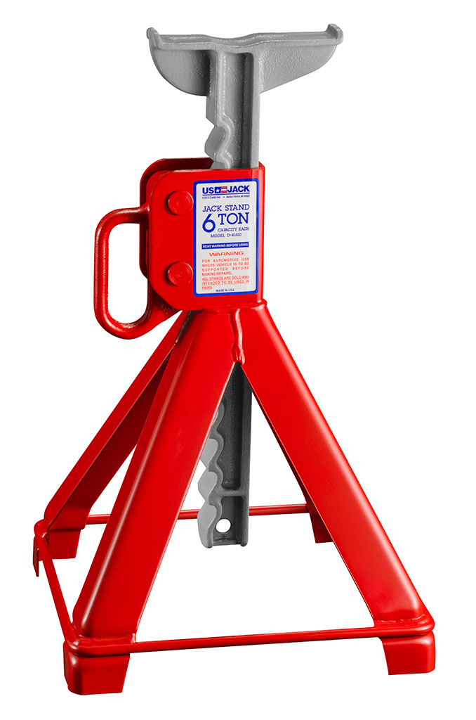

Here’s a US made 6ton stand: MSRP $199
Worth the extra $150 over the import junk
On their own store page their 6 ton stands are only $160 as of today, not $200
