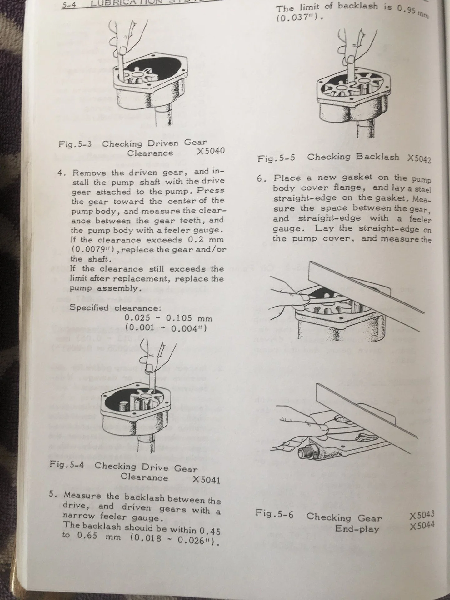

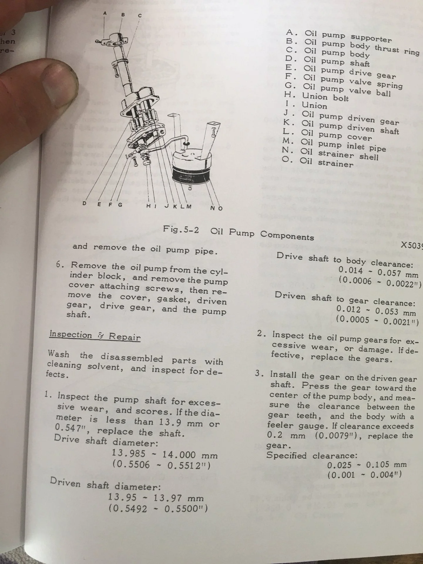

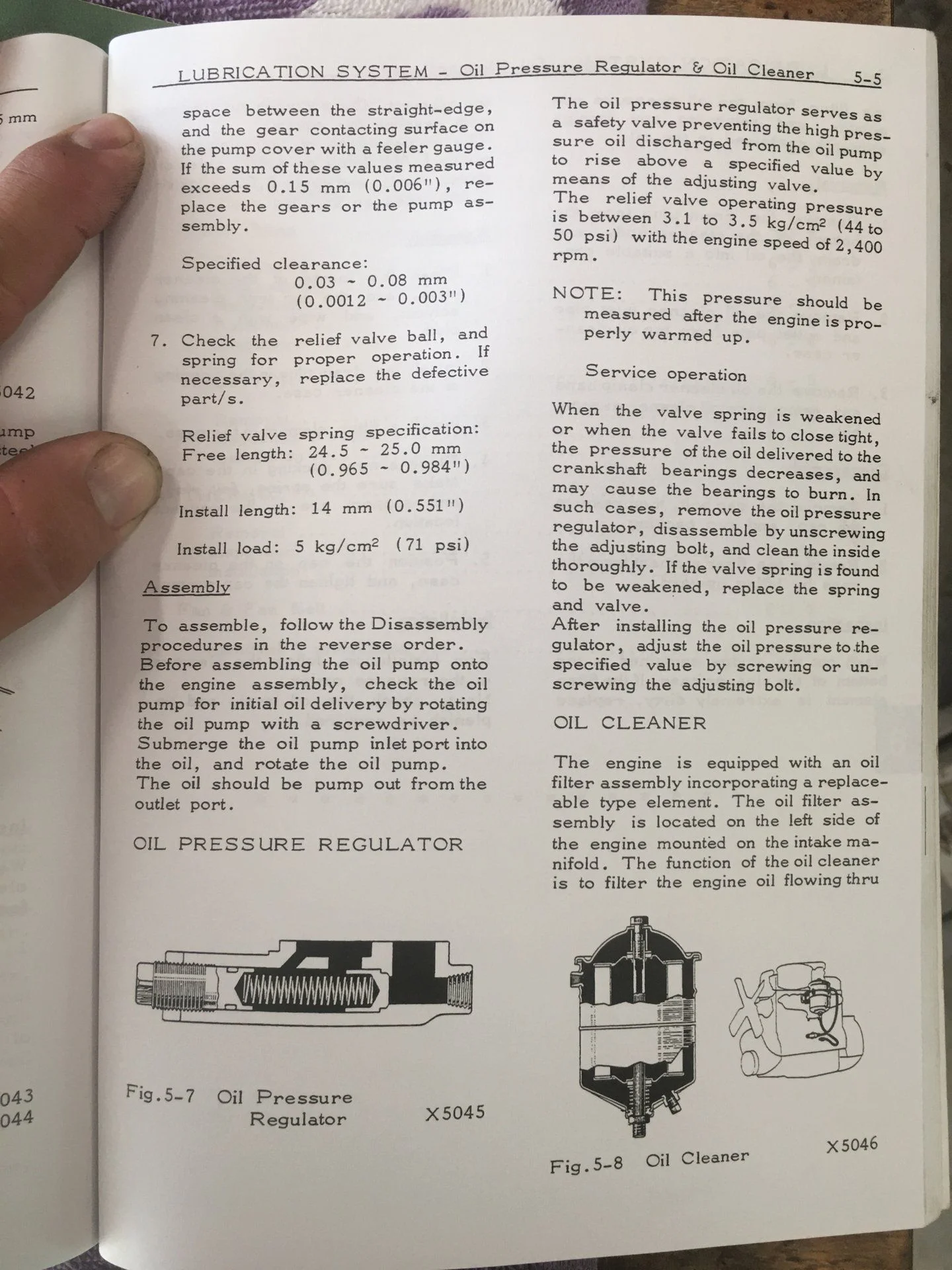

You can check the gear in your current pump to see if it’s still in spec. There is a procedure in the FSM for this. I also think you can ‘flip’ one of the gears over if needed (this is what I intend to do with my f135 pump).
Here is the fsm for my f135 pump...not sure if it’s the same or an option for the F pump.
As @S4Cruiser said, check your current oil pump before spending unnecessary $$. If your are unsure of how to do this just have your machine shop do it for you.
If it's in spec, there's no reason at all to buy a new one, & if it's not, you will have PLENTY of time to source one while your machine shop complets all the rest of his work.
