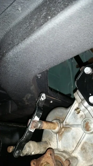

Hello I need some advice. I have finially got my 2F engine with a 4 speed tranny mounted in my 1965 fj45 long bed. My problem is there does not seem to be enough room for the PTO. There is a U shaped channel on the floor board that is in the way. Will I need to cut this to get the needed clearence for the PTO?
Thanks, Martin
Martin, the early 45's never got the 4 spd which is about 4 inches longer, so you have a clearance issue. I would maybe do a half inch body lift, or bend the linkage in a little to clear the tub. That channel is for rigidity, I would avoid cutting into it. Nice project, its fun when they start going back together!
Thanks, for the positive comments. Whitey, that sounds like a good plan.
I would do the bending of the linkage. I've never tried lifting the body on a pre 67 with the clamp for the steering box. That requires adjusting the three points, steering box clamp, the firewall grommet and clamp at the dash. Lifting the fenders and bib. then lifting the bed to keep the body lines stocks. Upside to the body lift is the hood would have more clearance between the air cleaner to the standing seam on two piece hood and the rod to hold the hood up.

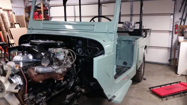

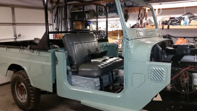

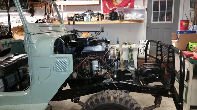

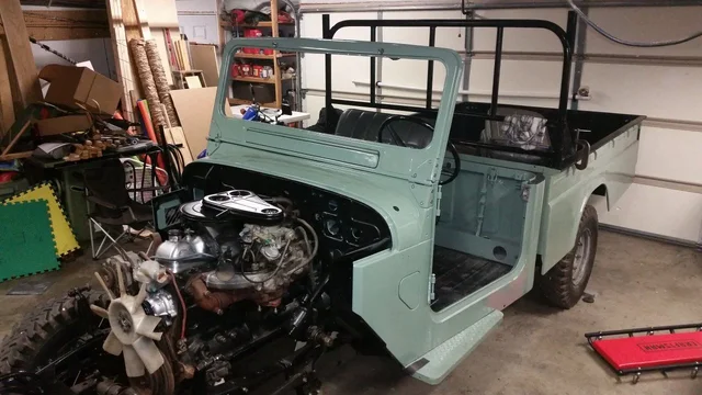

Well here I go again. I think it is time to get the project back underway!
1. Get the cooling system but in place.
2. Get the fuel system in place.
3. Exhaust system.
4. Brakes.
5. Drive shafts.
6. Electrics-lights, gauges, charging, and wipers.
7. Clutch.
8. Reassemble the body.
Thoughts/insights?
