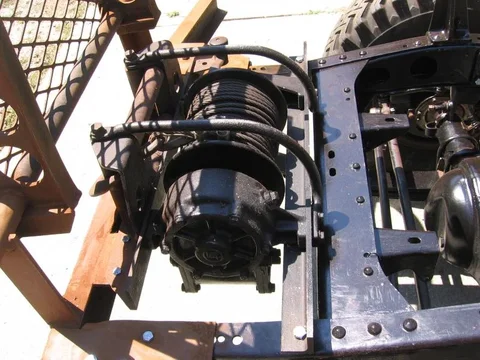

I hope to get the axles and steering hooked up this weekend. Then it is a matter of motor mounts and getting the engine set. I have a pto winch complete minus the gear for the four speed transfercase as well.

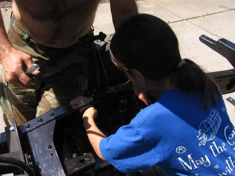

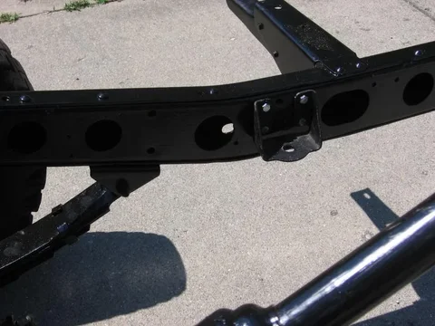

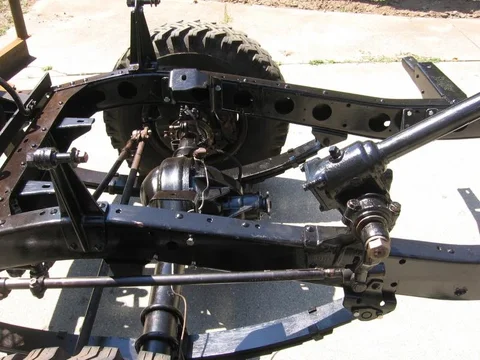

I believe I have the correct front frame MM to bolt in place, I will take pictures to see if anyone can confirm. The 2-F motor I have was out of a FJ55 and it has the front and rear engine motor mounts in place. I think I saw that the front engine MM are the same for the 40 & 55. If that is the case I think i just need the rear frame and engine/trannny MM, rubber fronts and donut rears. Damn it has been so long since I have worked with the landcrusier I almost seems foriegn.

From the pic of your frame, yours is a 1980 or older so the 55 engine mounts should be the same. In '81 Toyota changed the rear engine mounts to a transmission cradle and then it was similar to the FJ60.
the 55 rear donuts are an animal unto themselves; 40 donuts and brackets will work with the bellhousing just fine tho.
If you're working with a complete 55 power train, keep in mind that on the earlier 55s, the clutch fork and parking brake cable are both mounted opposite to the way they mount in a 40 or 45.

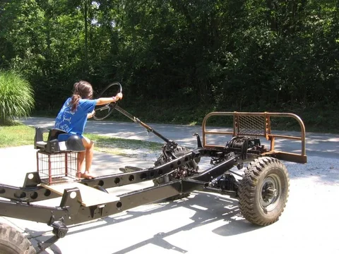

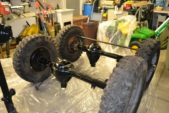

I have the axles under the frame and the steering linkages all hooked up, I will try to some pics posted today. The front axle is out of my old 1977 fj40 & the rear is the oridiginal 1965, so I am sure to have some adaptive issues when it comes time for the drive shafts.
Does anyone have a 4 speed pto gear they want to sell?
Parking brake drums and pinion flanges are interchangeable up thru 77, so you're good whichever bolt pattern you want to go with. I personally wouldn't want to stay with the 8mm bolts [the originals for '65] on anything I drive a lot. I upgraded mine to the 10mm. I still prefer the pre-74 u-joints for flexibility, tho the 74 up u-joints[ with the 11mm bolts] are more durable.
