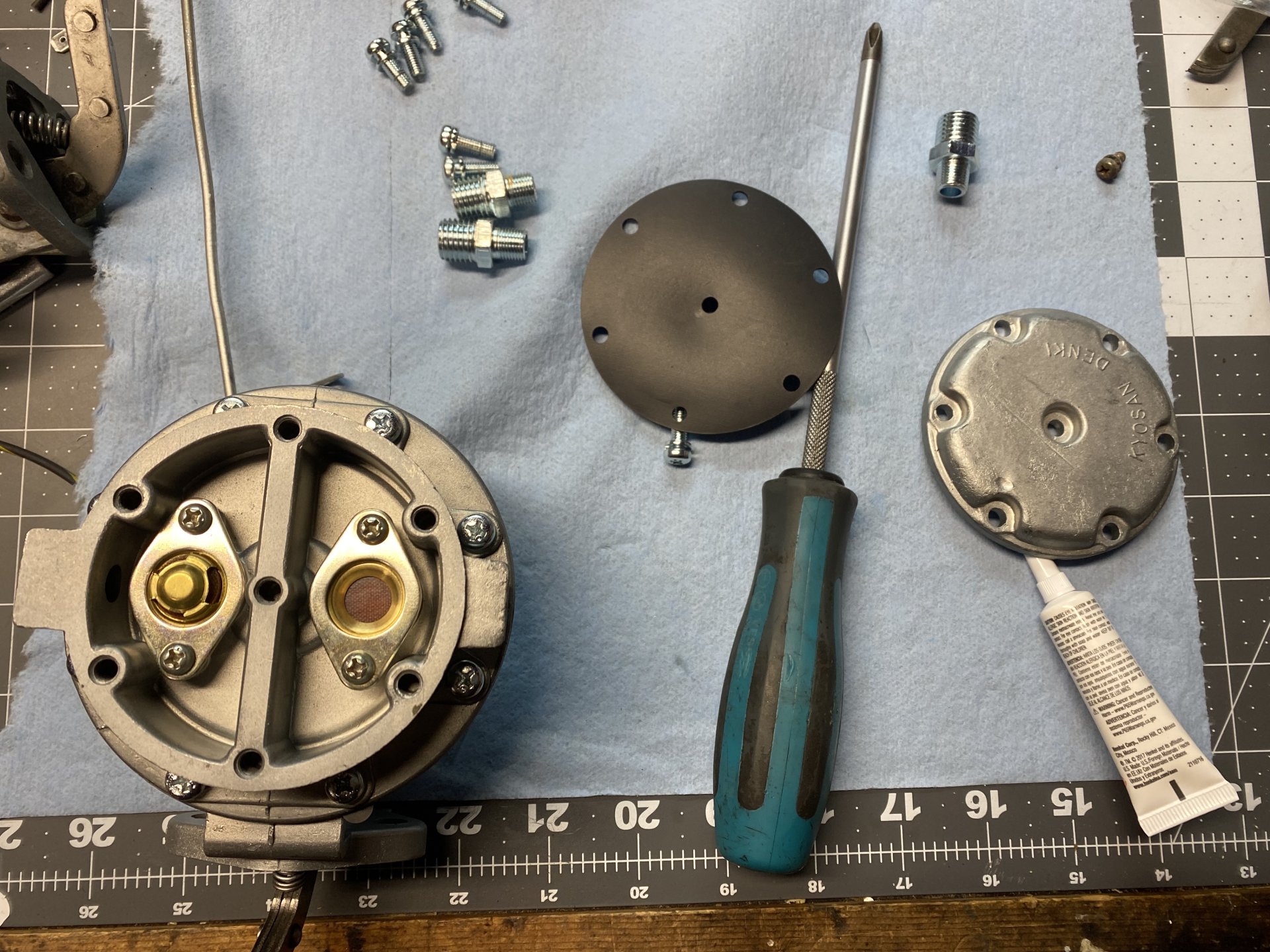

Hey everyone! Happy New Year. I just made a video on how to rebuild a mechanical fuel pump for the F and 2F engine. Not a hard job at all! :) Rebuilding the old worn out pumps is truly rewarding as most of the pump can be reused, just replace the old rubber parts and you are good to go. You can replace the valves but as indicated in the video, only earlier pumps have replaceable units. My hypothesis as to why Toyota moved away from having replaceable valves is the fact that they likely are never the culprit in a failed pump. But, that is just my hypothesis. We will be bringing in some rebuild kits from Japan soon in case anyone cant locate one. I think Toyota discontinued most of the rebuild kits and the only option is total pump replacement. Cheers all! Being a part of this community and giving back to it since I bought my first cruiser 22 years ago has been such a fun experience. :cheers:

Oh and one last thing I forgot to mention in the video, Make sure to line up the middle rib under the top cap with the middle rib that separates the two valve chambers. Lining them up helps seal the two chambers from one another and prevents cross flow.
