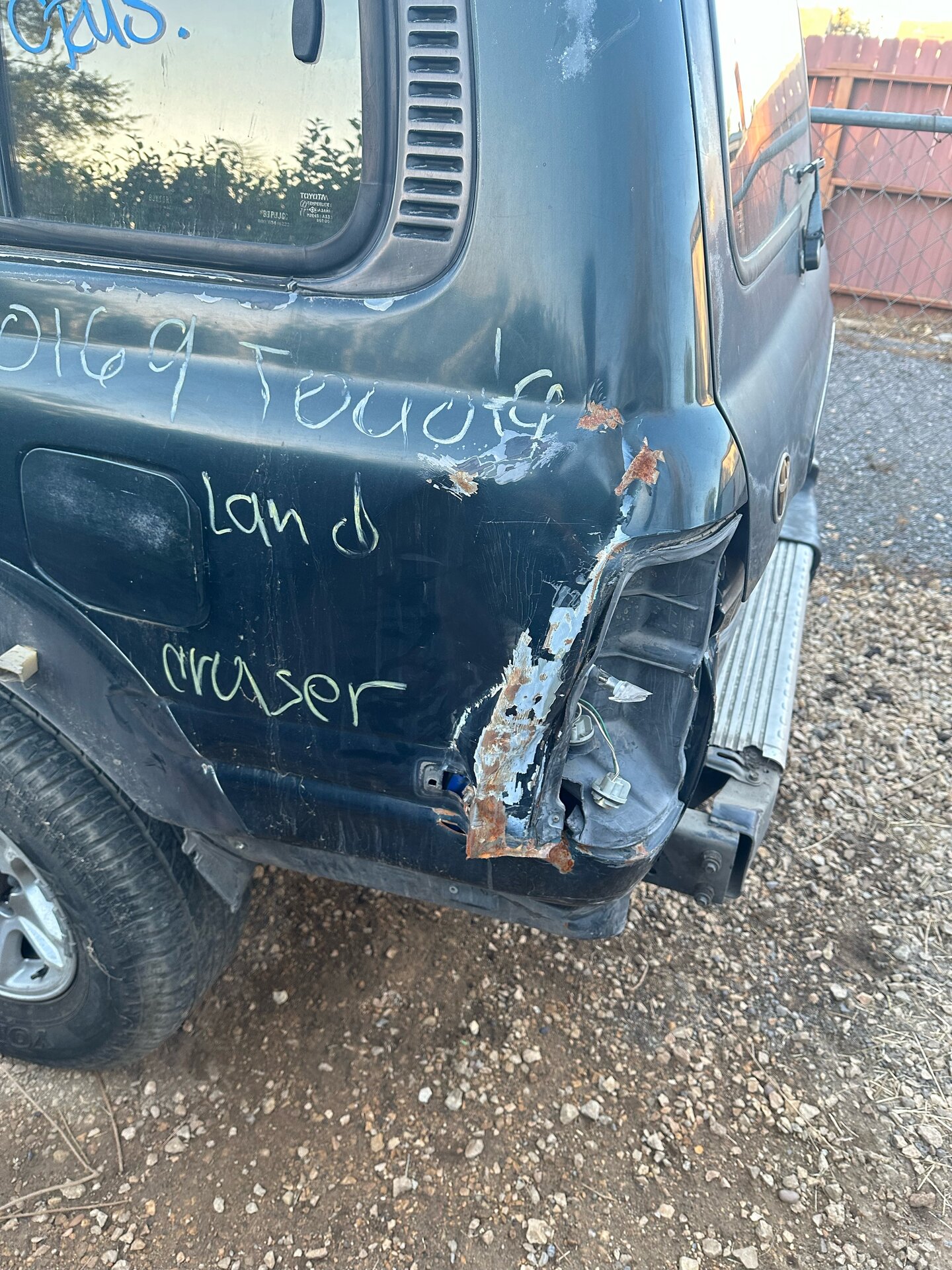

The transmission seemed to run good, how many miles until you consider rebuilding it? ill take more pictures when I get a chance!

The transmission seemed to run good, how many miles until you consider rebuilding it? ill take more pictures when I get a chance!View attachment 3493180
You can get a section of a rear quarter from @arcteryx (TX) or @slow95z (GA) when he gets back in the swing of things. It may be a bit, his wife recently passed.
You can also buy a new (yes, new) short block then install your head and accessories on it. It may prove less expensive than rebuilding existing parts. @Fj80oregon knows because he rebuilds lots of this engine.
The transmission on the 93-94 is known as the bus transmission. Very heavy duty and long lasting. Rebuilds not frequent.
