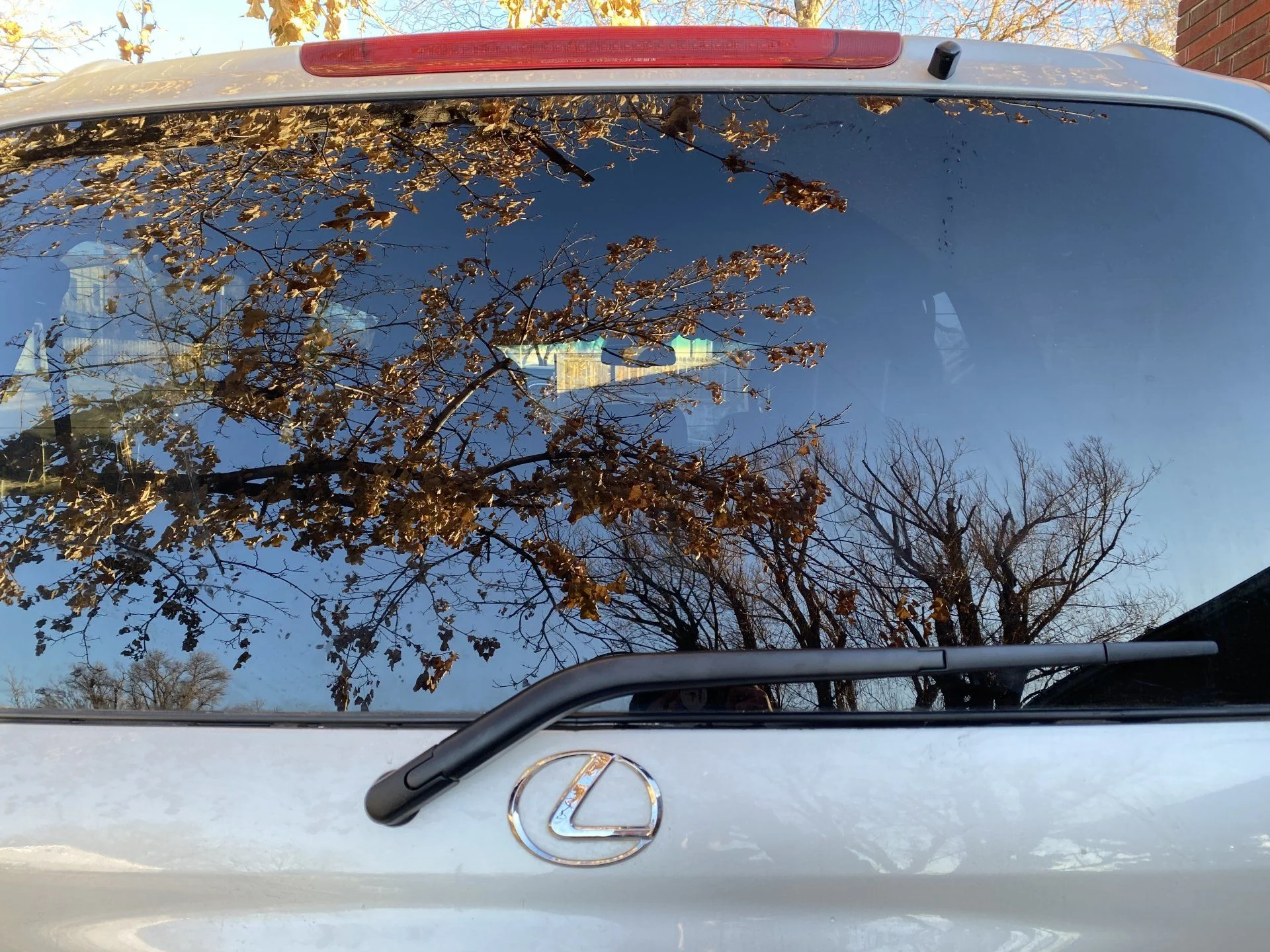

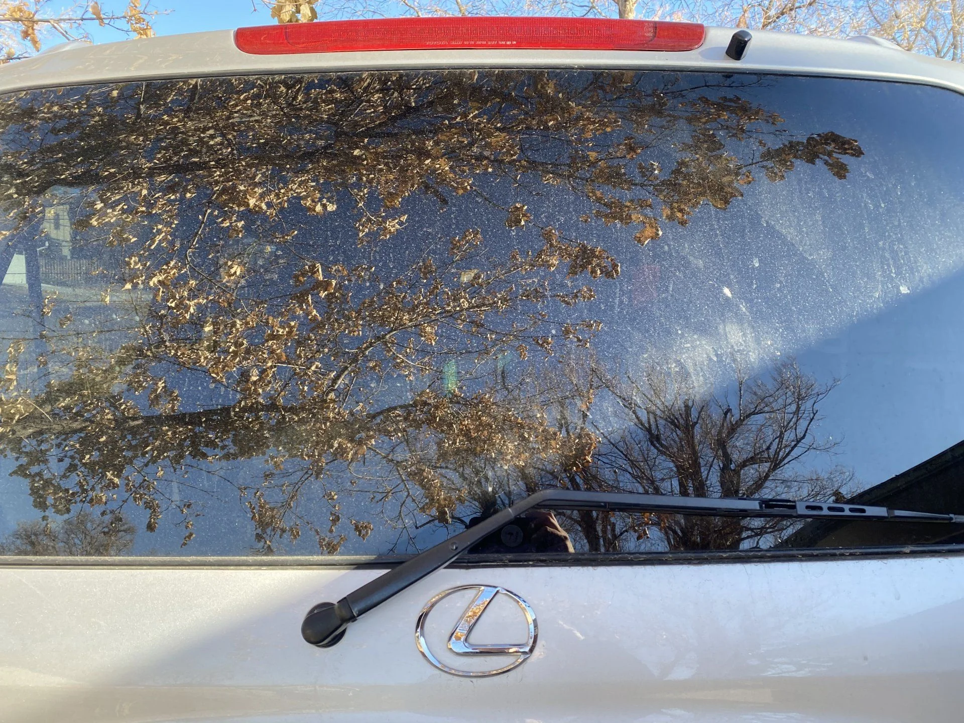

This was project for the day. Ordered parts (along with heater tees and hoses) from Partsouq last week and received them today.
Before:
After:

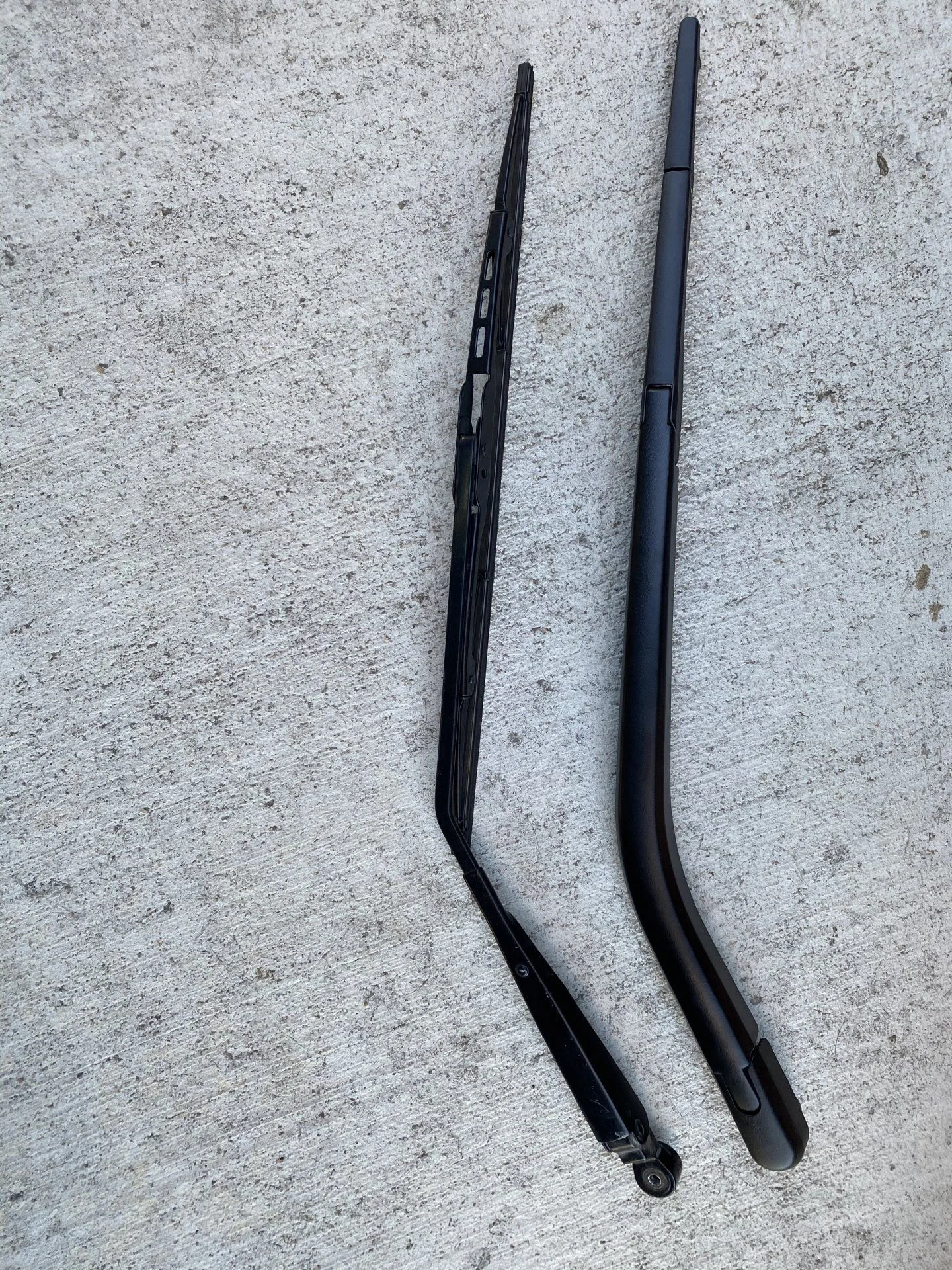

Comparison of wipers:
