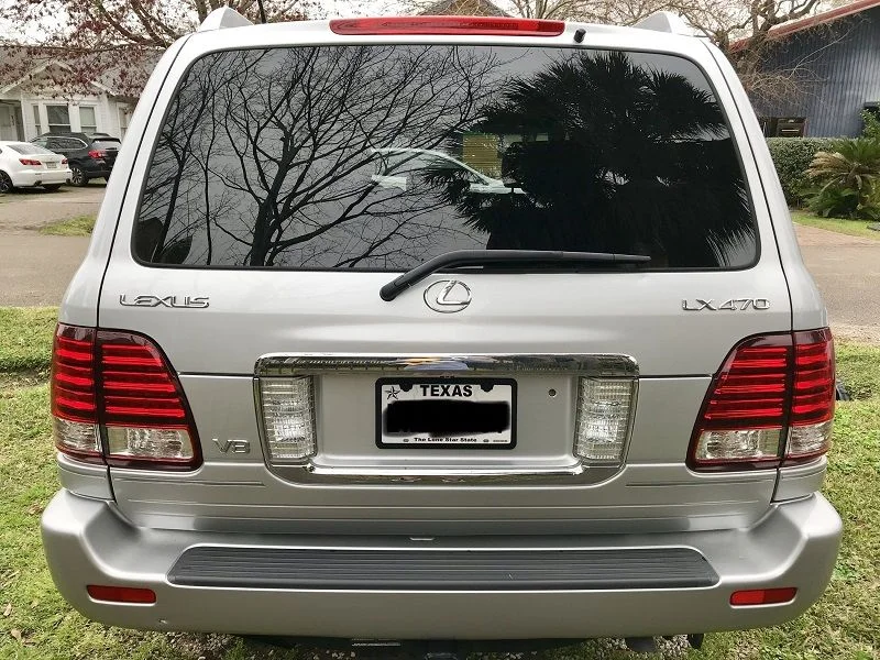

I recently purchased a 2006 LX470, and one of the first things I noticed was the hideous (IMO) vintage wiper arm/blade in the rear. I was aware of this prior to purchasing, but it became even more of a "sore thumb" after having it in my driveway for the first week. Optics aside, I was actually more worried about the potential for it to get snagged or caught when washing the rig (either by hand or auto wash) due to the flimsy arm and unprotected blade. Although these phenomenal machines are intended to live a long healthy life off-road, I am quite OCD about keeping my vehicles in tip top shape visually. :rofl:
I was hoping to retrofit a newer arm from a LC or LX, so started digging around the 100-series threads without much luck on anyone that had retrofit a modern arm onto the hundy. I then turned to digging around eBay, and came across a JDM-style arm and blade (all Toyota OEM parts), that is actually sold by supporting vendor @ranma21 . I shot Ian a note on eBay as I saw he was local in Houston, we connected on mud, and I stopped over yesterday afternoon to pick up the parts (Ian is also a total Cruiser-head, awesome guy!).
I installed the JDM arm/blade yesterday, and am thrilled with both the updated appearance as well as the much more protected "one-piece" setup. As mentioned above, it's an OEM JDM Toyota part, so fitment was great.

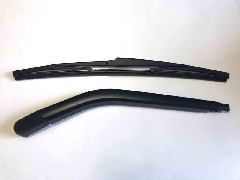

1896940
Tools needed:
  • 10mm socket (if yours isn't lost...I'm going to start stocking these :mad: )
  • Wiper arm puller (incredibly useful if you don't have one...I was going to snap something with the flatheads)
Directions:
  • Flip up the tab covering the 10mm nut
  • Remove the 10mm nut
  • The arm is installed over top of a rotating gear that drives the arm. Mine is clean, but was still seized
  • Hit with WD-40/blaster
  • Drive to parts store to buy wiper arm puller ($13 well spent)
  • Use wiper arm puller over top of gear stud, will break the arm loose from the gear outwards
  • Clean up gear prior to install of new arm
  • Install new arm/blade over gear with cogs aligned and wiper blade properly aligned in "home" position
  • Tighten 10mm nut, cover nut with plastic tab
  • Enjoy the modern, one-piece look! :clap:
