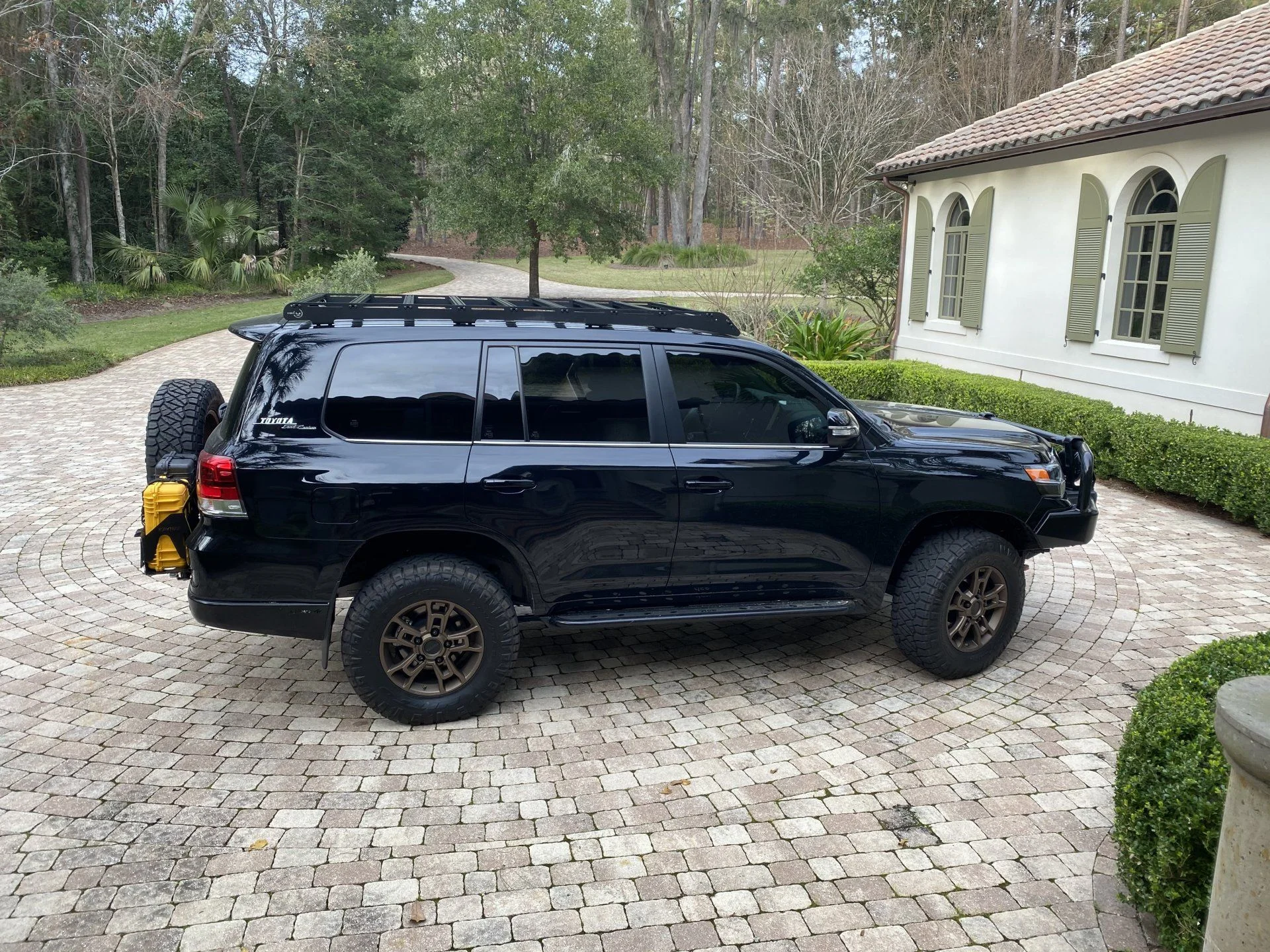

I started out with the 2721s with just ARB drawers. After I added the Kaymar rear bar and a 24gal LRA tank (thanks to @orangefj45 and @wardharris) I had a lot of sag. I put in the 2722s in and couldn't be happier.

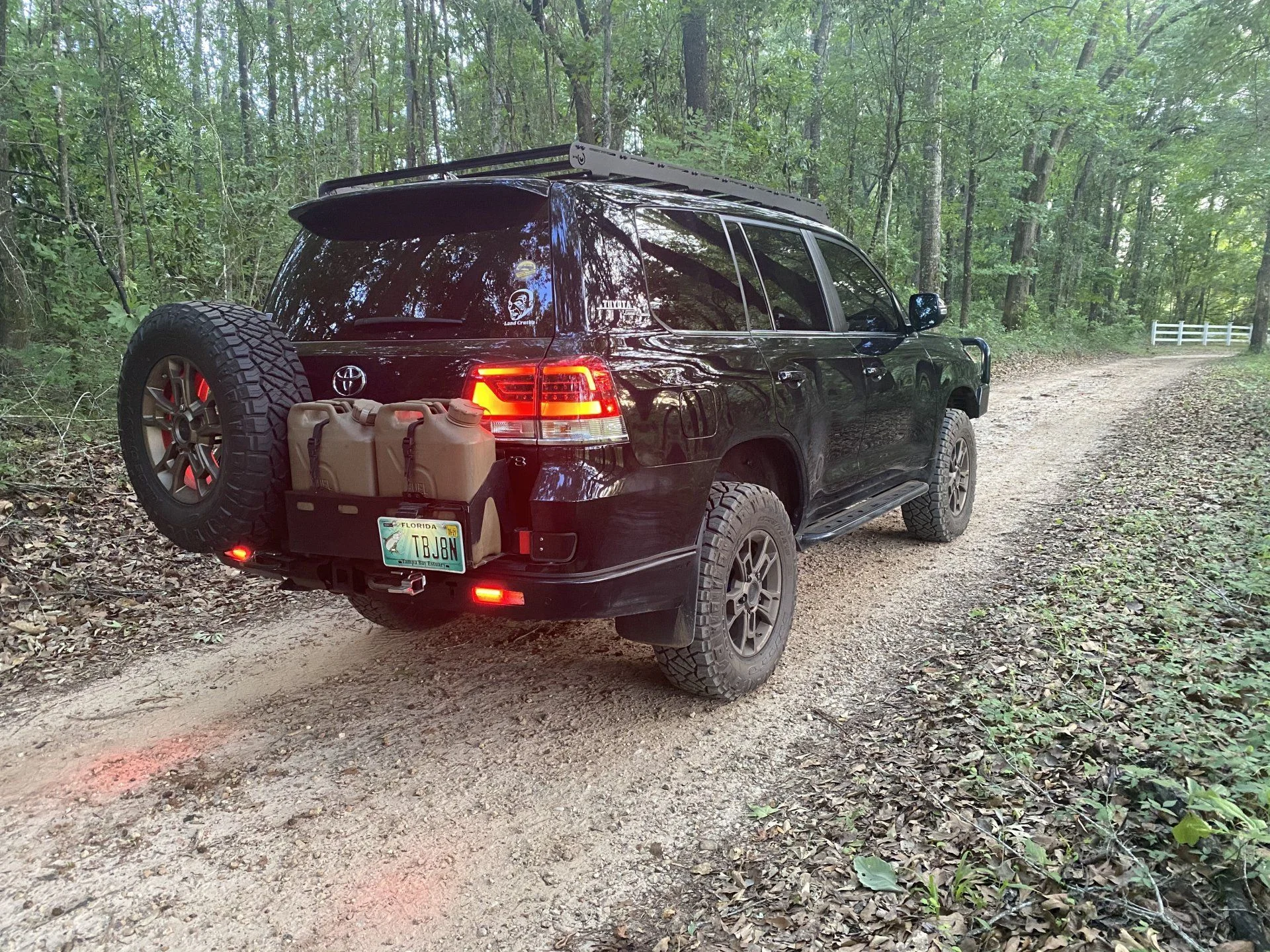

I am running 2723’s on my Heritage. I have 24 gallons LRA, Kaymar rear tire carrier, and Prinsu rack. No drawers but the fuel carrier is usually either full of fuel or recovery equipment. I am pretty happy with the setup and cannot think of any reason for me to desire a spring change.

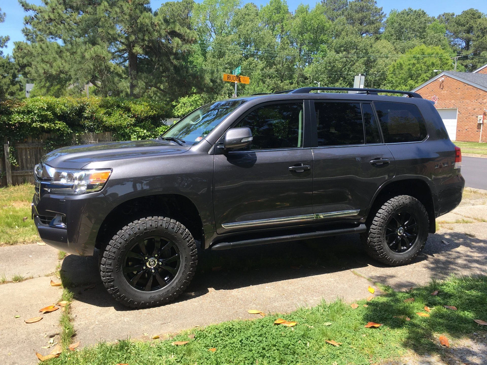

I did a OME 2 inch bp-51 with the 2722 rear springs, SPC UCA, the 2722 give it an additional 3/4 of an inch in height, i did not even consider the 2721 springs.
Here's a picture of how mine turned out with what i listed above
I have 1.25 inch wheel spacers for now until i get wheels in the next year or so, i really like the factory ones in black though.
My tires are 295/65/18 they are right at 33 inches, the spare tire is also 295/65/18 and it does fit just fine in the spare location.
when I first started this build I also was dead set on the 305/65/18 but I ended up choosing the 295's for the reason they are only less than a half in narrower than the 305 but the 295 is a true 33 inch which overall helps with clearance, not much but it does
My in town driving mpg is about 10.9 so i would expect the 305's to be a bit worse

So just my 2 cents here and only my opinion, I think the 2721 are not going to be enough.
Right now I have a bit more than 3/8 inch rake but you can hardly tell by the picture. the other day I went to Lowes and got 200 pounds or so of decorative gravel and some other crap, prob 350 pound or so and I was pretty much level due to the fact the 2722 are stiffer springs, If I had the 2721's in the rear, it would sag a good bit and keep in mind the 2722 add an additional 3/4 of an inch, it is in my opinion that having a bit of rake is a good thing, and as for your thought on it being to stiff with the 2722's in the rear, well you can offset that by playing with the compression and rebound on the shock settings.
My truck drives like a dream with my set-up and the 2722's
