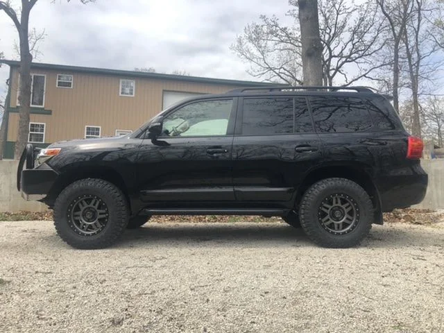

Here’s a pic of my rig with no load in the back.
An 1” higher in the rear would be about perfect.
Nothing wrong with using spacers to dial in ride height. Functionally, it's pretty similar to adjusting the perch on a coilover. Just done differently. Sure, if you're an elitist and can find exactly the right spring that has the unladen height and spring rate, go for it. Installation is just about the same too.
There's tons of spring spacers out there - 5, 10, 20, 30mm. Sounds like 20mm (~.75") will suit you nicely.
If you like the 2721 performance unloaded as well as under normal load, just install rear spacers/"trim packers". Unless you find a similar spring that is slightly taller, you're most likely to end up with a spring that's too stiff and makes your ride less pleasant when unloaded.
