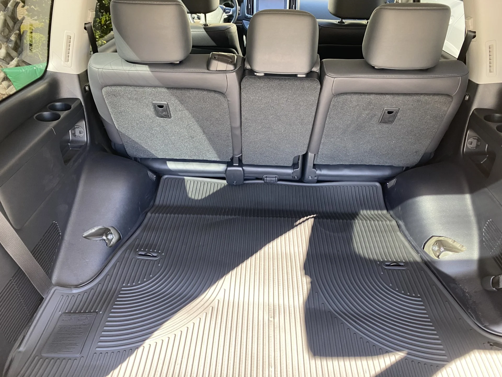

This is complete with the original floor mat, D-Ring Trim Covers installed in the wheel well gaps:

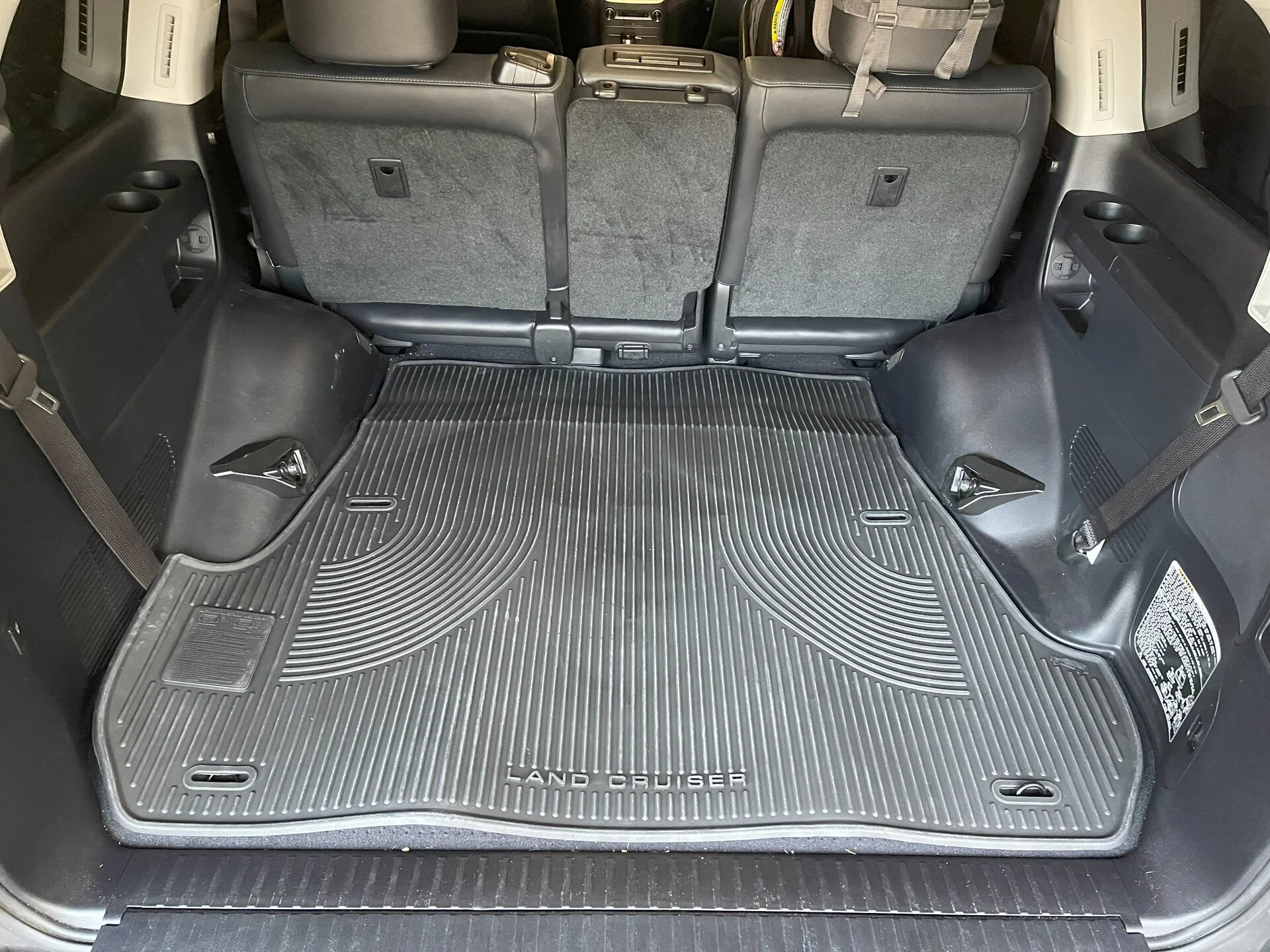

This is with the Heritage Mat:
I assume it leaves threaded holes in the floor where the seat frame attached?
Yes, you can see the holes in the carpet in @WhensLunch post. There are some threaded holes in the metal that should be covered with tape or dust from outside the car can get inside. There are also the brackets on the wheel wells that stick upward.. a couple companies make expensive covers for these, others use the anchor to bolt a ring to for tying things down. These are in @dnh1 post.
