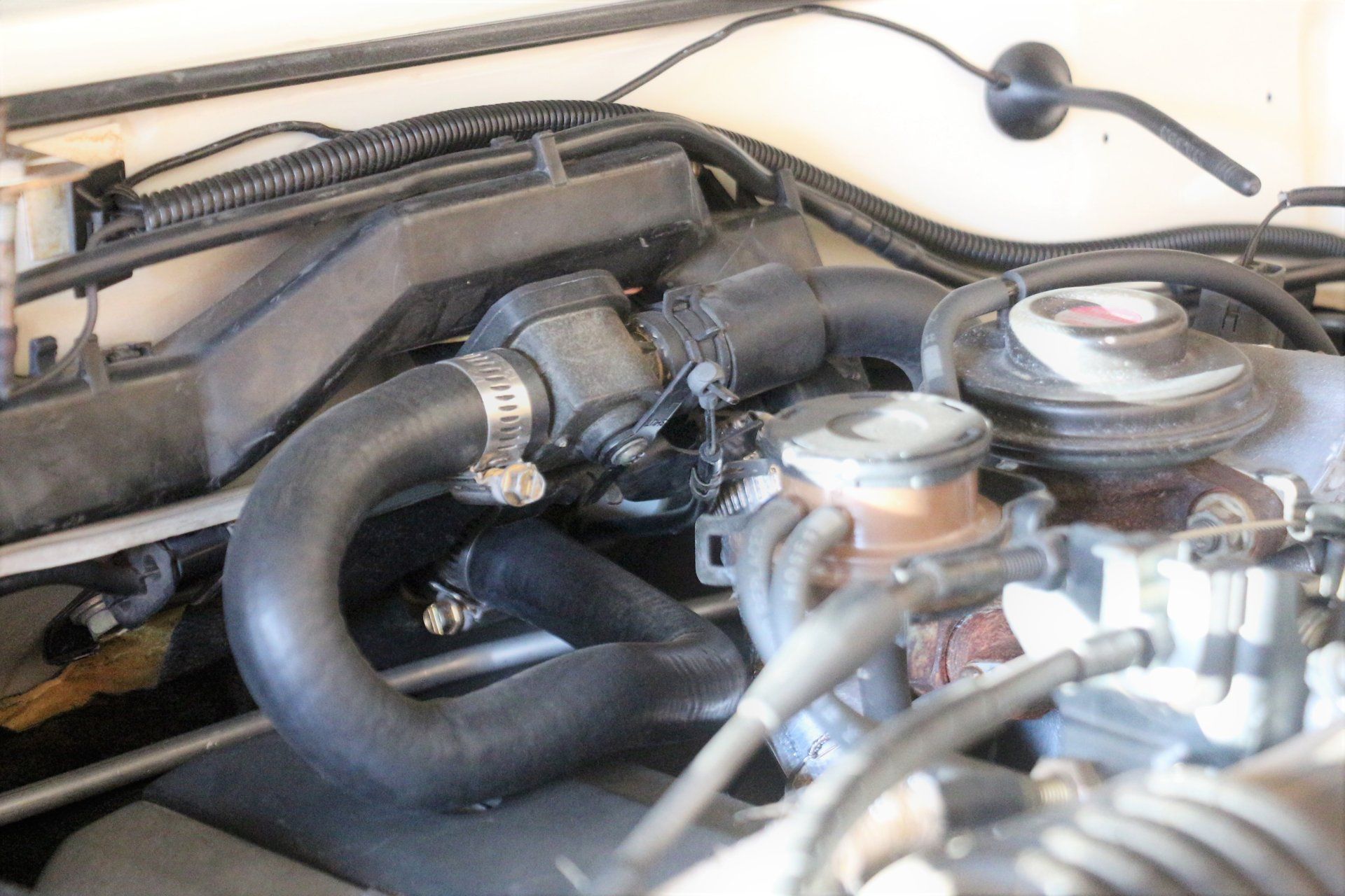

One of the common ways the hose is addressed. Meh at best

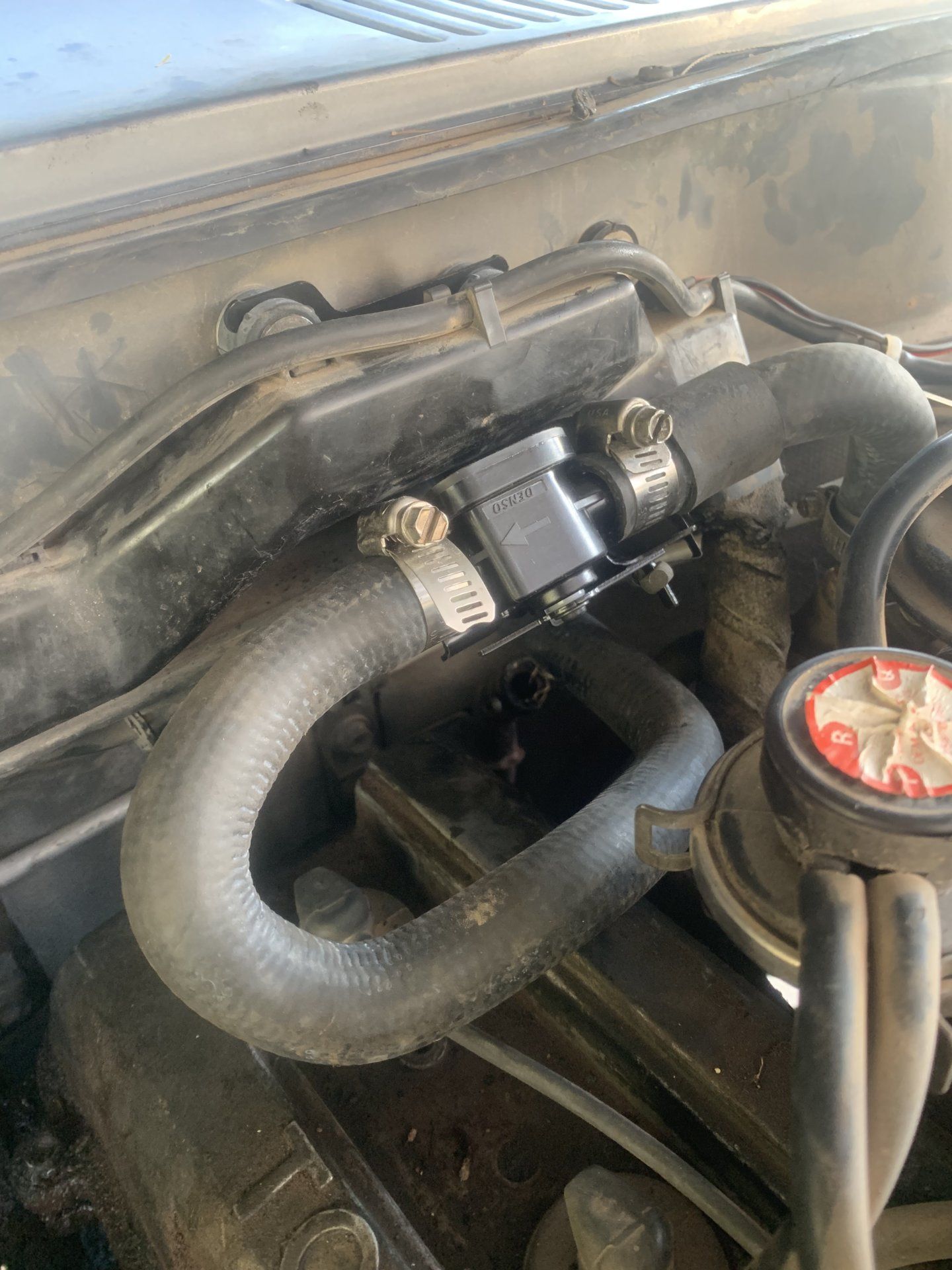

Pictured below the old way
The new and factory looking set up using the hose we offer below. MMmmm
note- it looks like the hose contacts the valve cover but its just the picture angle.

While I did mine by just finding a gates hose at napa and cutting it down, yours does look better and eliminates one more connection. Nice work
Nice thinking out of the box. Several way to approach the delete Im just trying to make it easy for lazy guys.:D
